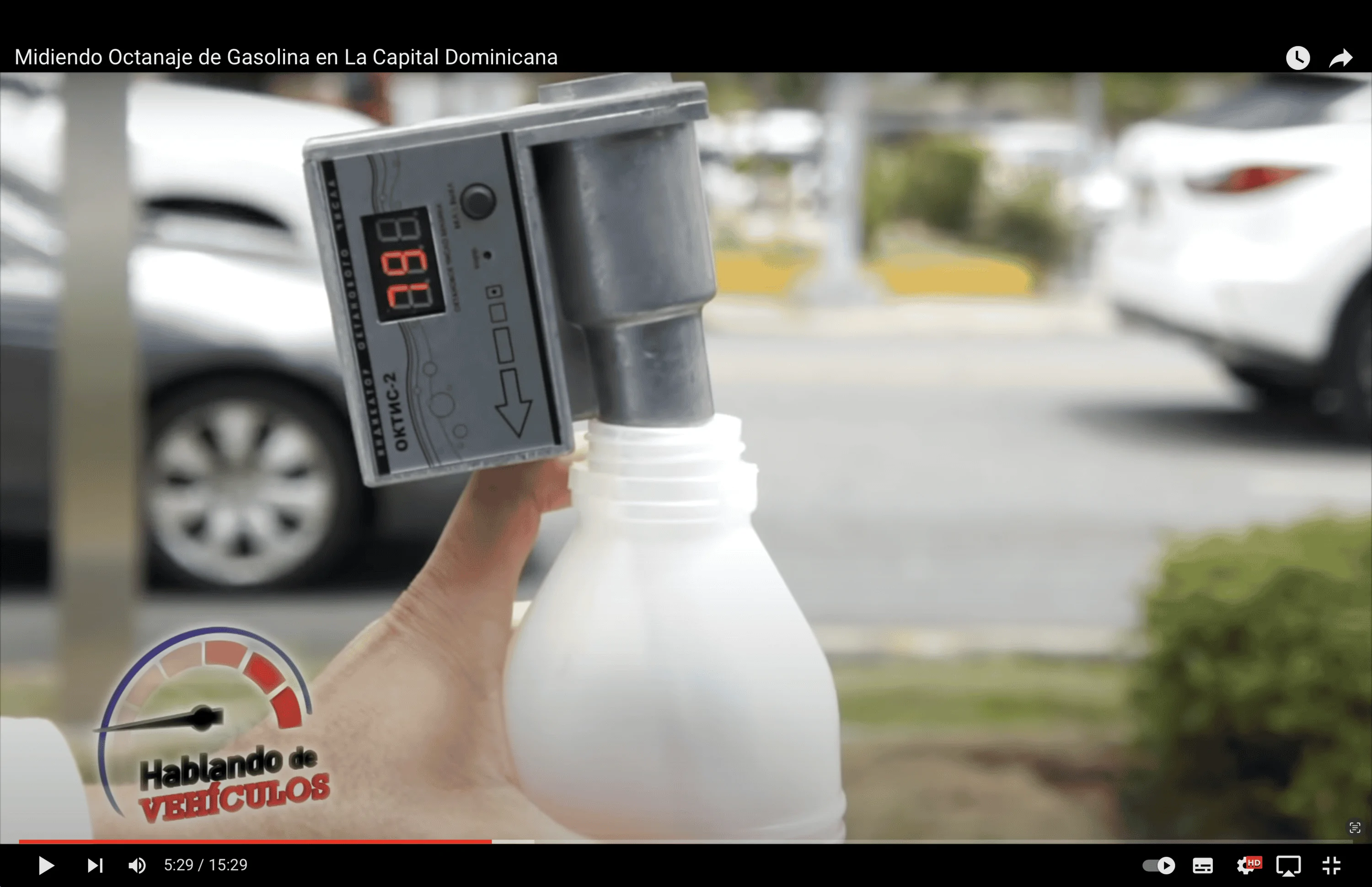

The problem is that in the region where I am located, there is no guarantee of how good the fuel is, I will attach an image of an octane test in the capital city of DR

It can run 87, won't be getting beat performance. But it won't have any issues.
As for quality of gas in your region. It's unfortunate you have no guarantees. But unless it a common occurrence, I would worry tooooooo much. But I'm not from your region so don't know how prevalent poor quality gas is.
