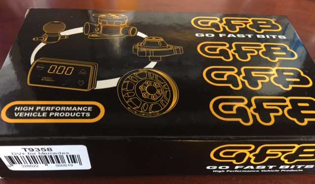

I've seen others mention that they see up to 24 psi on the FRPP tune (I know this dependent upon weather conditions) but it made me wonder if you're getting all the mustard it's trying to deliver.
The factory bpv is a known leak point that can lift off its seat when pressures increase and bleed boost above 21psi. I'm not sure if your experiencing that or not, but you maybe leaving some power on the table.
GFB makes a diverter valve that replaces the internals of your stock bpv which alleviates this as a leak point. It's a pretty inexpensive mod and one that I personally consider essential.
Adam sells them on his site as well as other vendors I'm sure.

I bought my DV+ on Amazon and absolutely love it. Pulls hard on shift, and holds boost much better than I did without it. Super easy mod, and inexpensive. You'd probably see a little bit better boost consistency with it.

I was hoping that's where you were going with it. I actually bought the DV+ from Adam a little while ago, I just haven't gotten around to installing it yet.

Take a datalog right before and right after install and let us see if it was bleeding off pressure...
