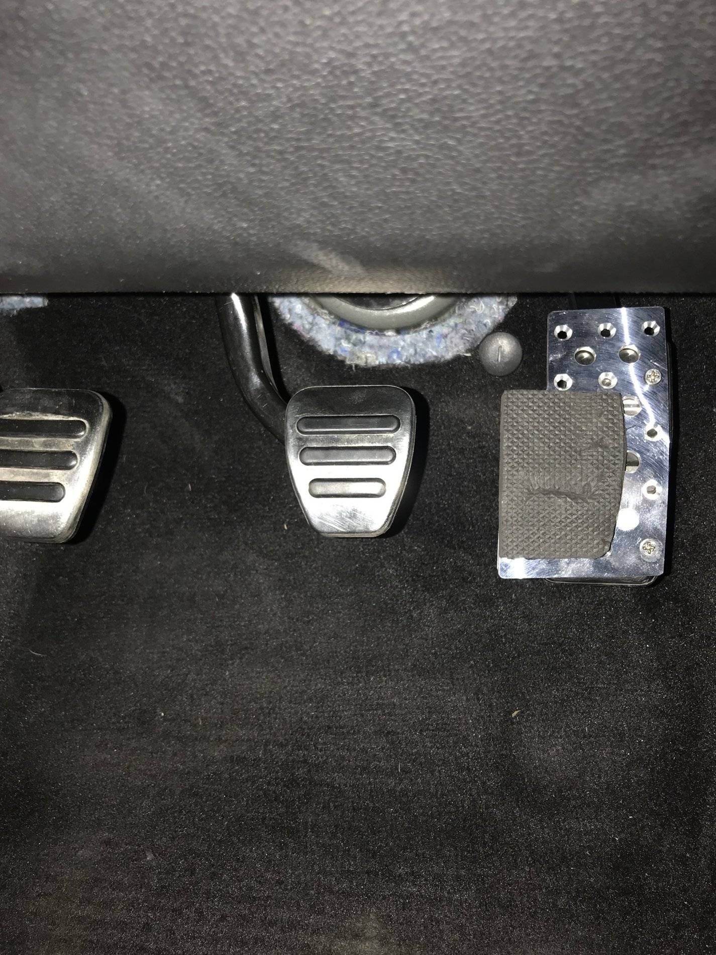

I didn’t raise my mounts. My easier solution is one level for street cold higher brake pedal and another level for hotter brake pedal for the track ; Steeda wide pedal to close the gap , and a hard foam rubber pad applied with right stuff Over it for the street , which is removable for the track and can be re applied
