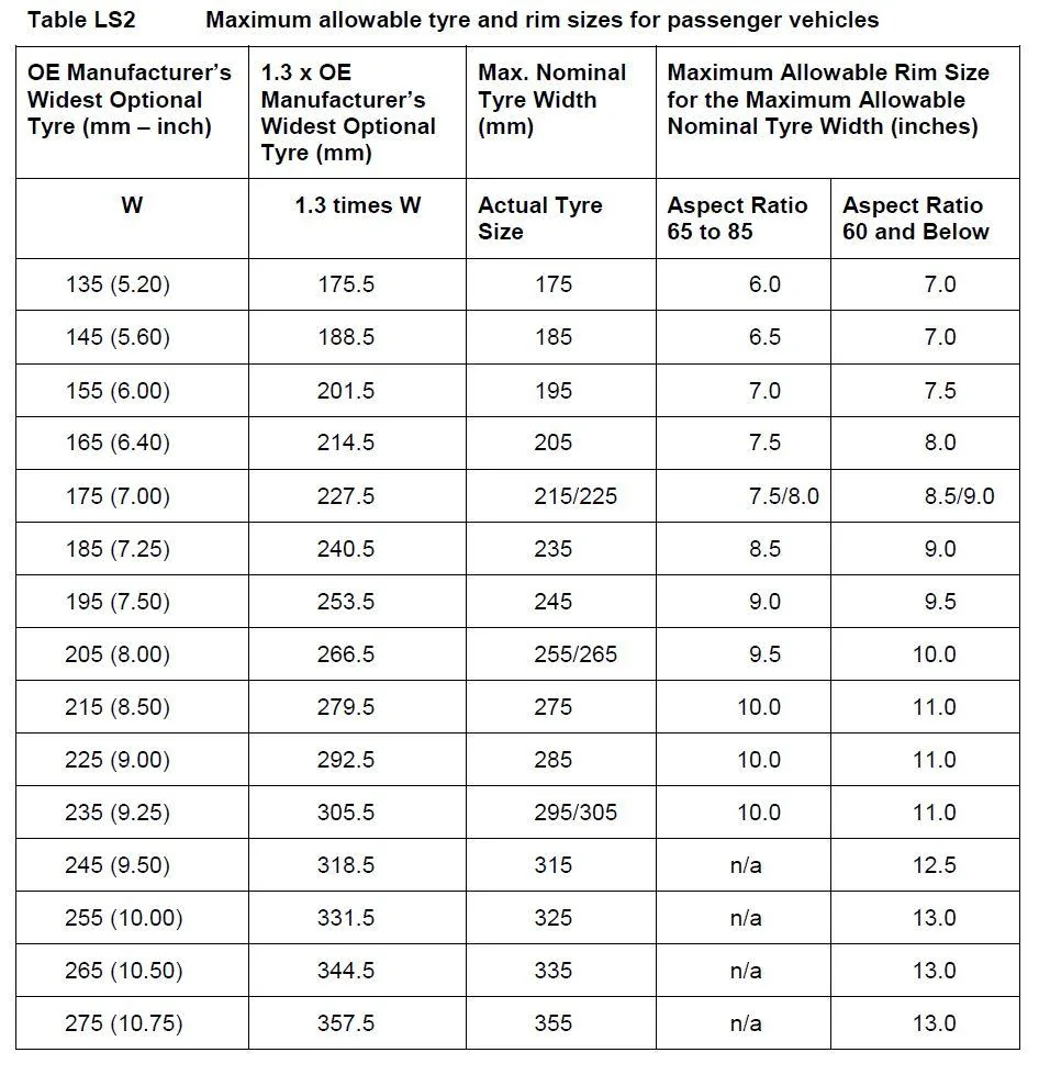

I almost bought the wheel spacers from CJPP, but then my colleague pointed out they are illegal and I checked QLD transport site:
It says:
Wheel spacers (or adaptors for dual wheel conversions) between the wheel mounting face and the road wheel must not be used unless fitted as original equipment by the vehicle manufacturer.
Modifications to disc brake calipers, hubs and suspension and steering components to enable the fitting of replacement wheels must not be undertaken " :frusty:
And regarding Wheels:
Maximum Passenger Car Tyre and Rim Width
[FONT=Arial,Arial][FONT=Arial,Arial]Tyres fitted to passenger cars or passenger car derivatives must not be more than 30% wider than vehicle manufacturer’s widest optional tyre. [/FONT]
[FONT=Arial,Arial]The rim width must not exceed the recommendations for the tyre fitted. [/FONT]
[FONT=Arial,Arial]For example, if the original widest optional tyre is 185mm, the maximum tyre width is 1.3 times 185mm = 240.5mm, i.e. a 235mm wide tyre. The maximum rim width for a 235mm tyre is 9 inches if the aspect ratio is 60 or below. [/FONT]
[/FONT]Section LS Tyres, Rims, Suspension and Steering
[FONT=Arial,Arial][FONT=Arial,Arial]Version 2.1 – 1 November 2015 Page 21/LS80 [/FONT]
[/FONT][FONT=Arial,Arial][FONT=Arial,Arial]Table LS2 lists the maximum allowable tyre and rim sizes for passenger cars taking into account the tyre aspect ratio (n/a = not available). [/FONT]
[/FONT]
Why is it so complicated ?:rant:
