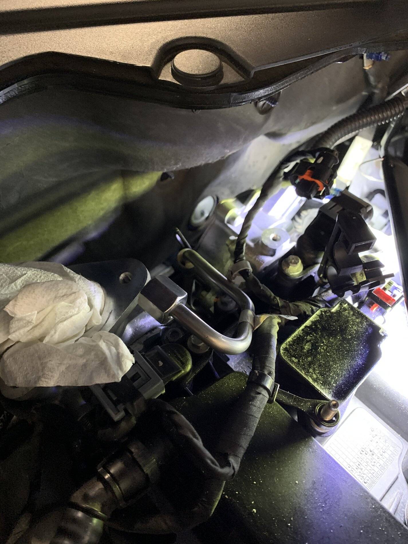

This is for anyone that has installed the Nostrum hpfp. When you removed the factory hardline off the car, how did you maneuver from behind the head? I’ve tried every angle I can think of including moving around the mounting tabs and I cannot clear the line from the car.
Any direction or input folks can offer would be much appreciated.
TIA!
