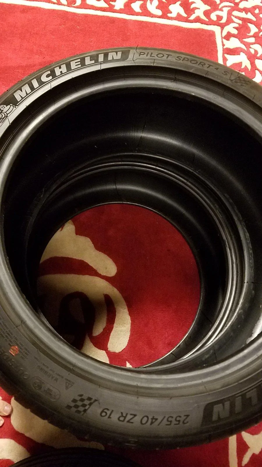

I found the page that lists all available sizes and there is actually no 255/40R19. I guess I'll have to look at another tire, or go rogue...
Funny, what are these? I have 2 sets of front 18 GT takeoffs in my basement. So yes MP4S are available in 255/40/19.
I used Tirebuyer vs Tirerack. With available discounts and coupons they were much cheaper with great customer service.
