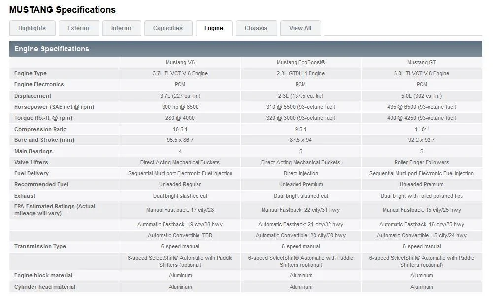

^^^^ This is the correct answer although more may be controlled than just ignition timing (the dual independent camshaft timing and fuel delivery may be altered as well, not sure for the 5.0L). All the 'you have to burn 93' comments are incorrect. Will it run better on 93? Maybe, but on a hot day the differences may be the most noticeable if at all.This is absolutely right.
Octane is actually a fuels resistance to burning. The higher the octane, the LESS it wants to burn (or ignite, more specifically). Most people don't understand this.
Most cars, timing is set and doesn't move. Use the lowest octane it will run. Usually manufacturers recommendation unless tuned. Which means higher octane is less power if timing doesn't change.
However, the mustang adds timing until knock is sensed. More octane yields more timing which yields more power. So higher octane means more power and more efficiency.
