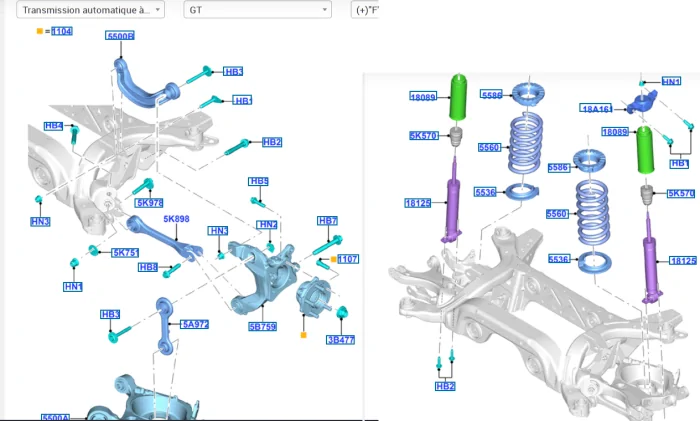

Je vous parle de la possibilité d'avoir un peu de jeu dans les roulements du moyeu
Tu veux dire celui-lĂ  pour resserrer ?
133 Nm 98 LB.FT et 45° vous semble correct ?

My clack is only when I take a deformation of the road like the video it is the slab of my gate which is higher than the road or a bump to slow down, I don't know if you have that at home but in France there are some has a lot!!! too much. I don't have the clack when I start driving or moving forward after a reverse step
I remove one more time my right rear wheel on the ground without anything other than a jack wheeler!!! I once again tried to see what was wrong, I was trying to take out the stabilizer bar link to move this part aside but I was afraid of not being able to put it back. and the driveshaft nut is really rusty, I dared to touch it.
