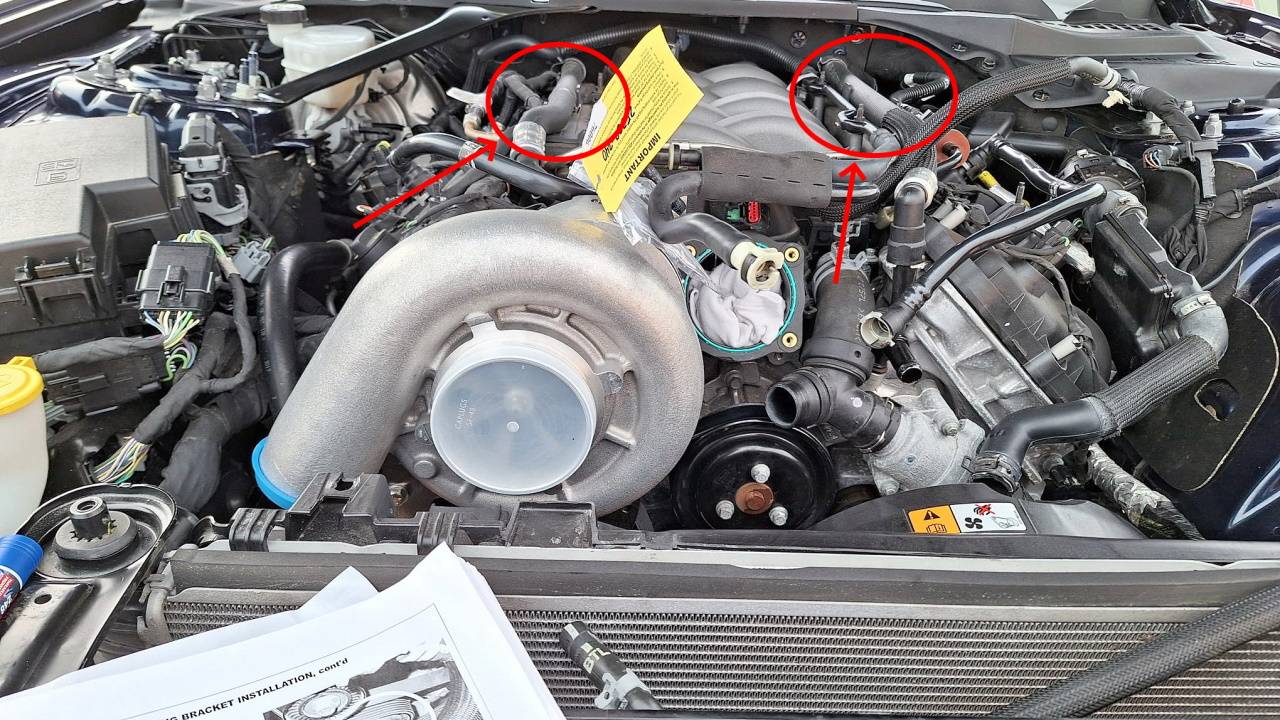

Cheers. Are the coolant lines the ones I've highlighted? Just trying to get my head around what is located where or I'll be on for days guessing haha. I'll listen out for any clicks when I turn on the ignition, I don't believe I heard any doing just that process - just when I had the low battery and everything went a bit crazy I heard loads of clicks then.

These are the coolant lines to check they're hot.

Thanks so the coolant lines are actually metal and not silicone. No way I can squeeze those then. My bro has a steep drive I wonder if I park it on that and take the cap off and let the car run if that would help at all. Something to try! Or dare I just drive around with the coolant cap off...

That's a fuel line you're looking at, it's behind that, the light orange plastic connectors going into the firewall. If the engines up to temp, you'll definitely tell if they're hot.
Ahh. I knew that. lol 🤪
Good news is the short drive this evening for data logging cleared the airlock. Woo. I have hot air once more. It might have helped that the road was on an incline. But going to let car cool off and check the levels again tomorrow. Thanks for all the help!
