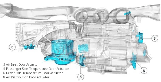

UPDATE:
So it looks like there's 4 actuators, I've rotated and relabeled this diagram of a LHD; the ones that are failing on mine are 3 and 4. I removed the actuators and manually closed the flaps and the heat returned. I managed to realign the cogs on the passenger side and seems to be working, just need to sort the drivers side.

UPDATE:
If you've managed to access the blend doors, I'd recommend changing them with new ones. The blend doors are known to be an issue. I've not paid attention to the blend doors on the Mustang, but the Fiesta ST platform that I had, the message board had a lot of people having blend door failures. It usually starts with clicking noises, then failure.
I'm glad you got your issue sorted out.

My heater door actuator FR3B-19E616-BA has been replaced with FR3B-19E616-E, so maybe there's been some improvements; there also looks to be after market actuators.

I realigned the cogs on both passenger and driver side actuators and the heating is working again.
If the gears got out of alignment, that means the plastic gears are starting to wear and it'll fail again. Just food for thought.
