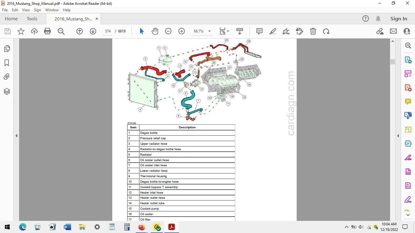

Checking the in and outlets was going to be my first job, how easy is it to get to get access to it, I've seen people removing their entire dash to replace it ?
The pic below shows the hoses. Looks simple enough.

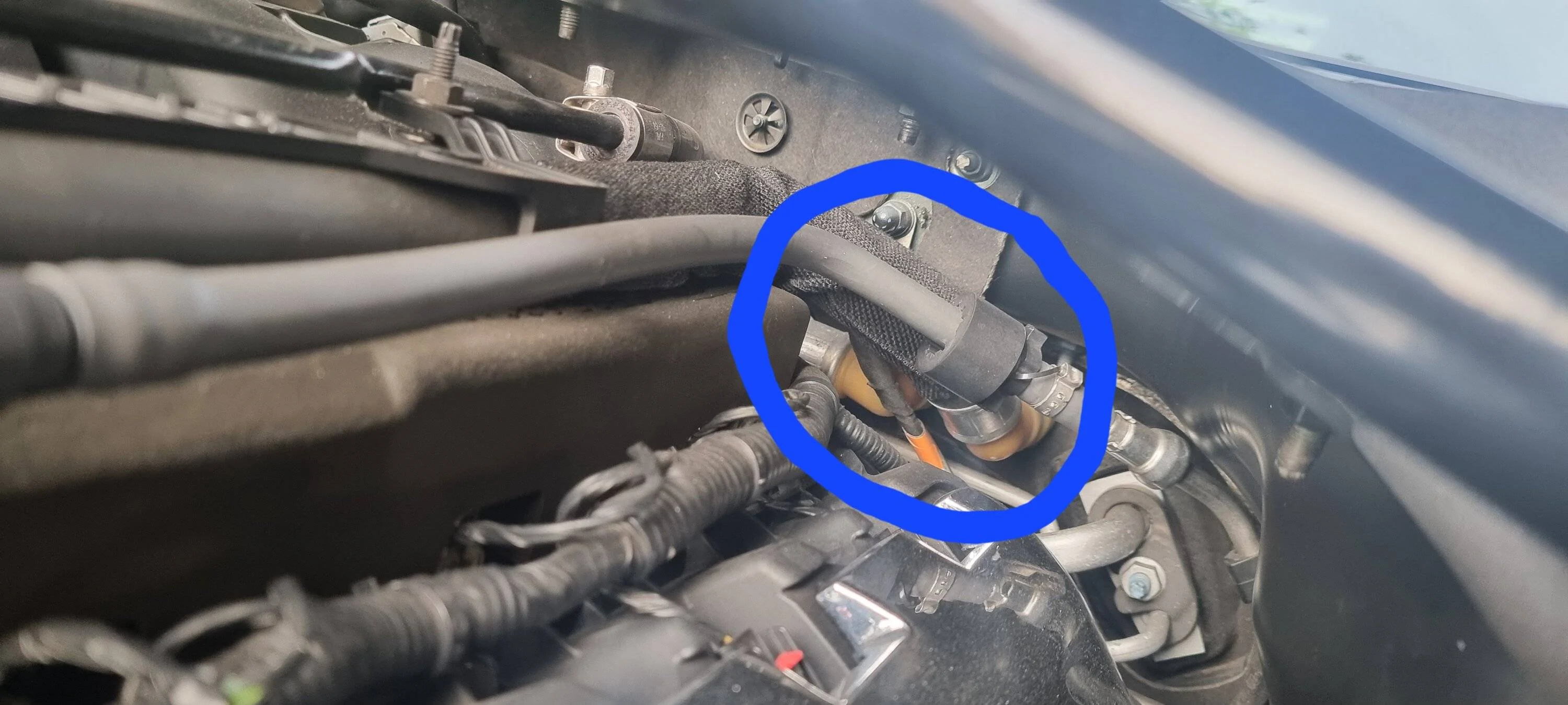

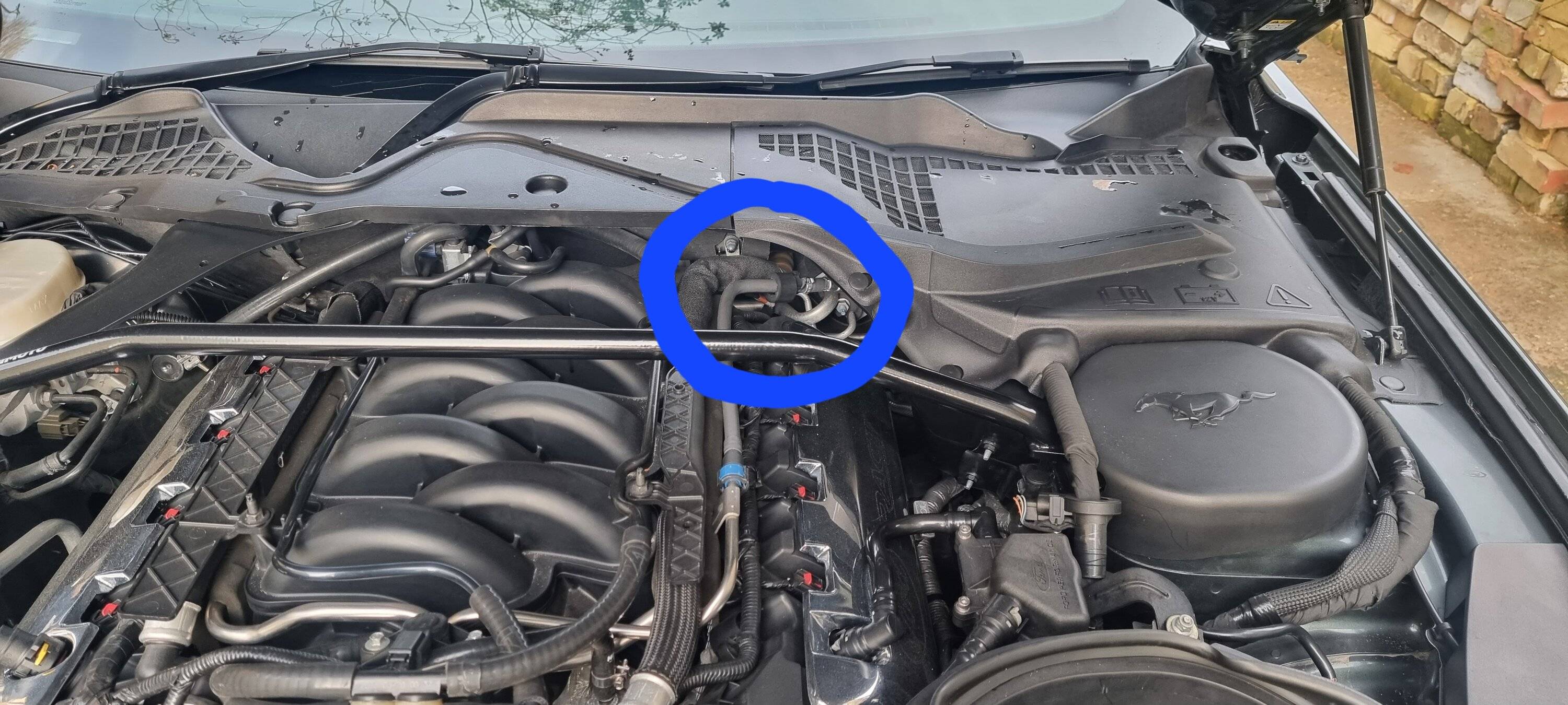

OK so first run today, if these are the coolant in and outlets to the heater core, both were hot to touch, so it's not that.
