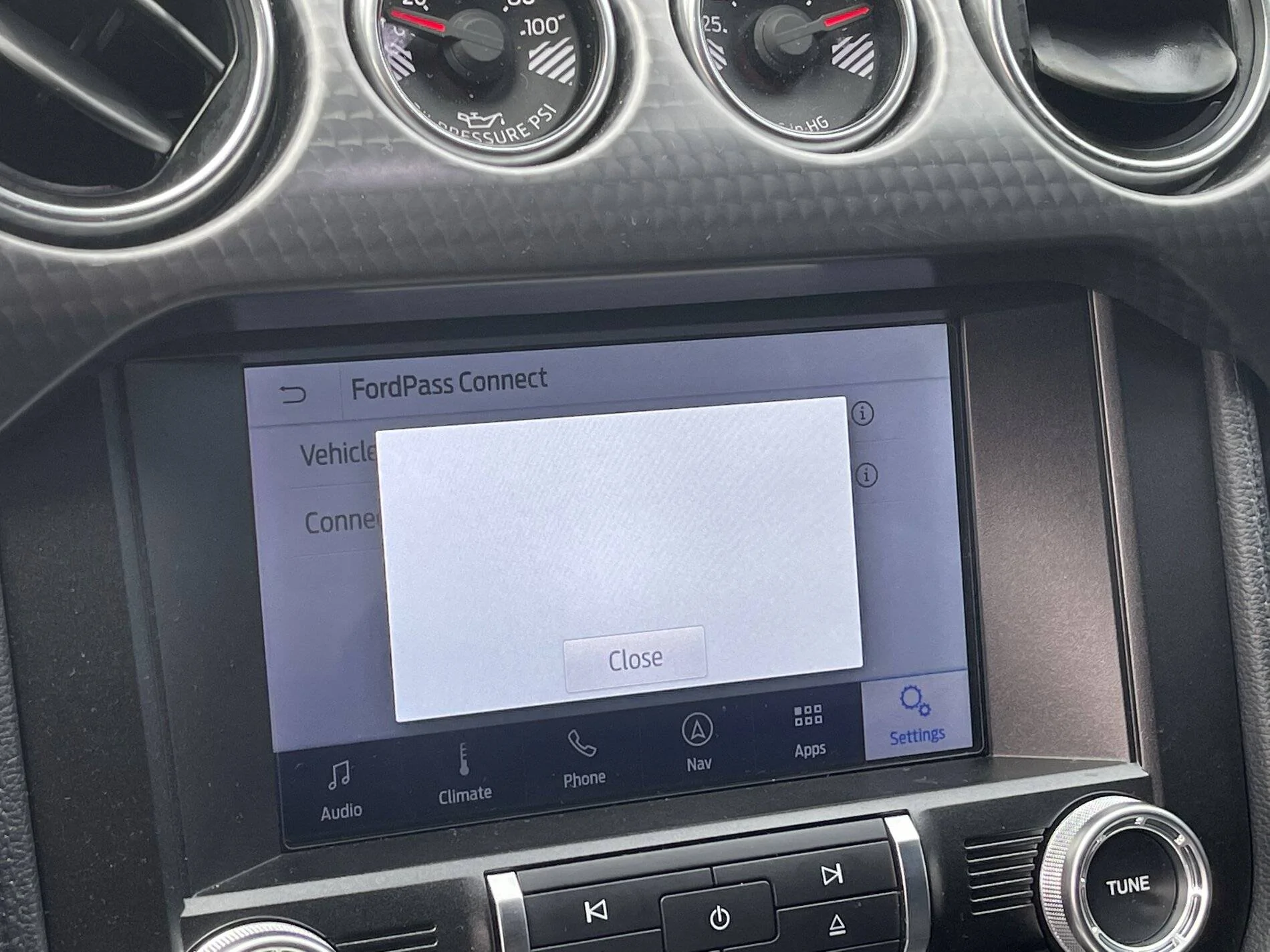

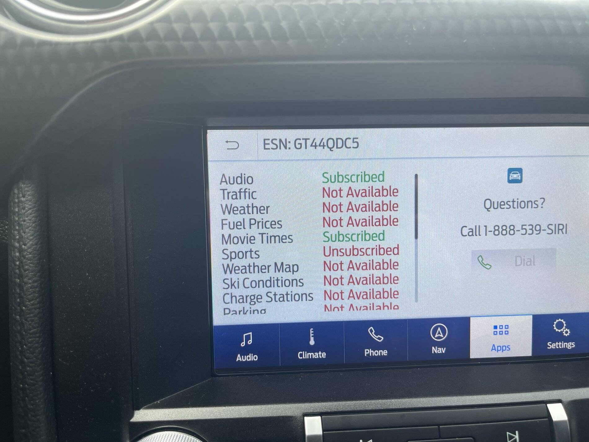

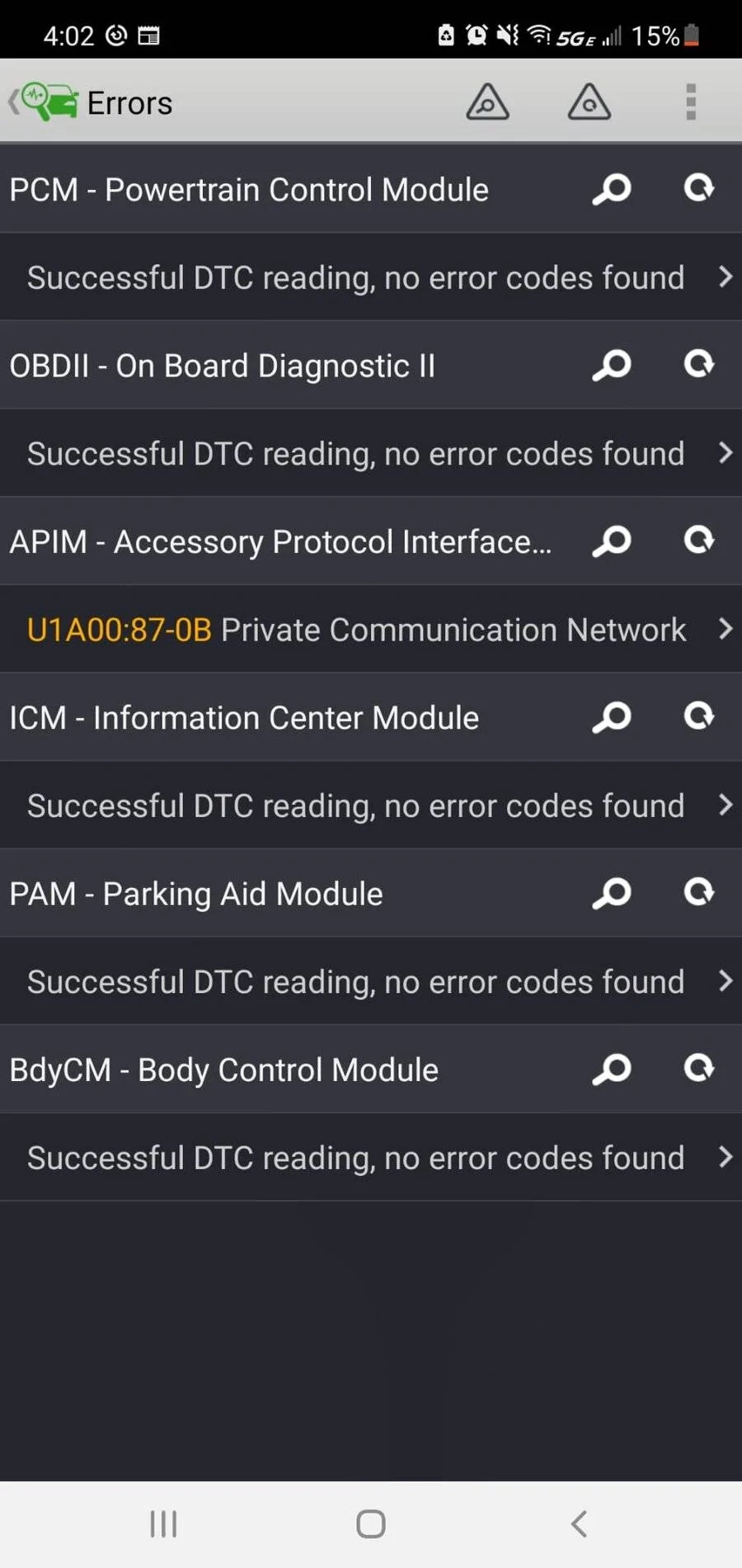

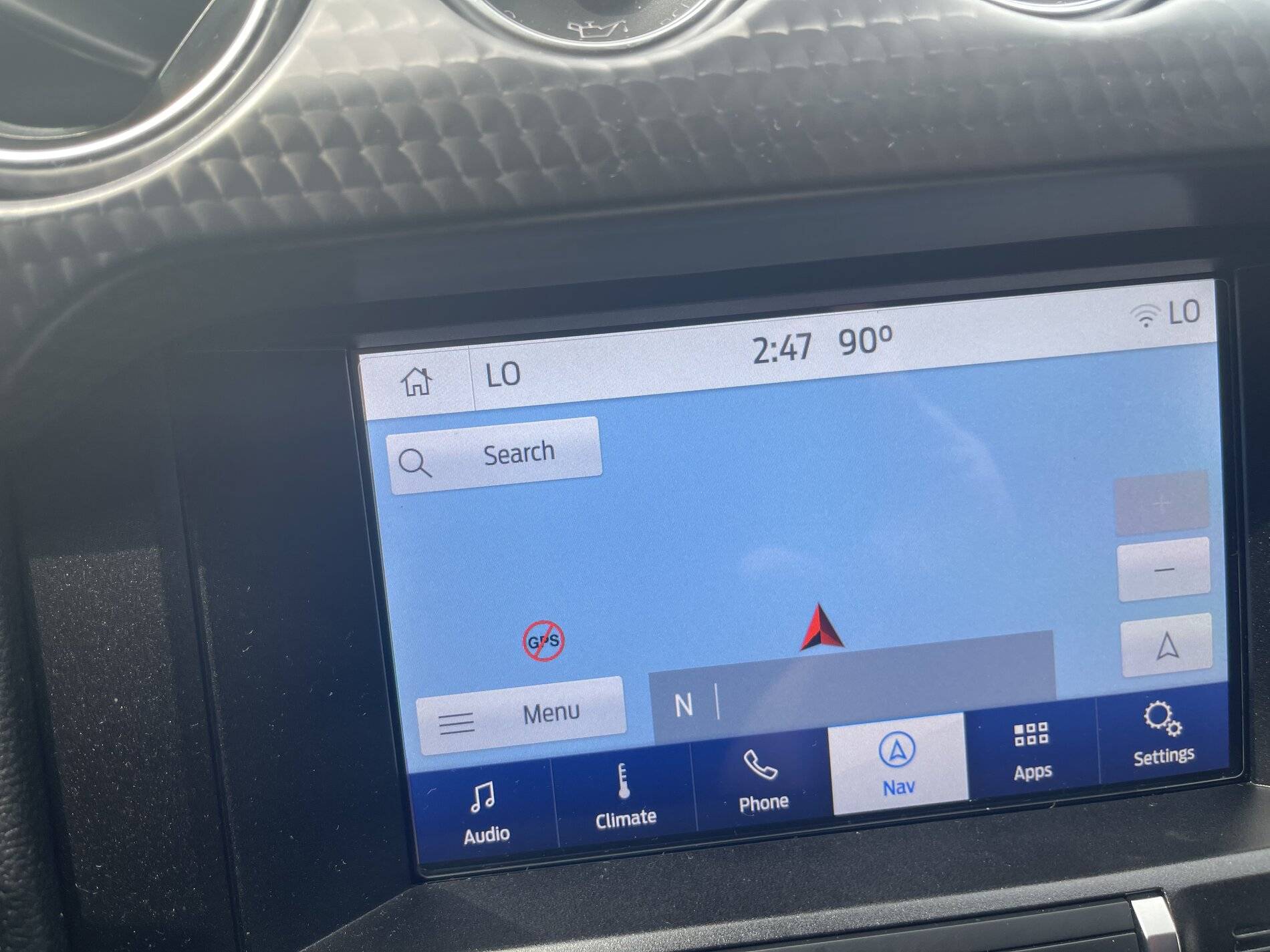

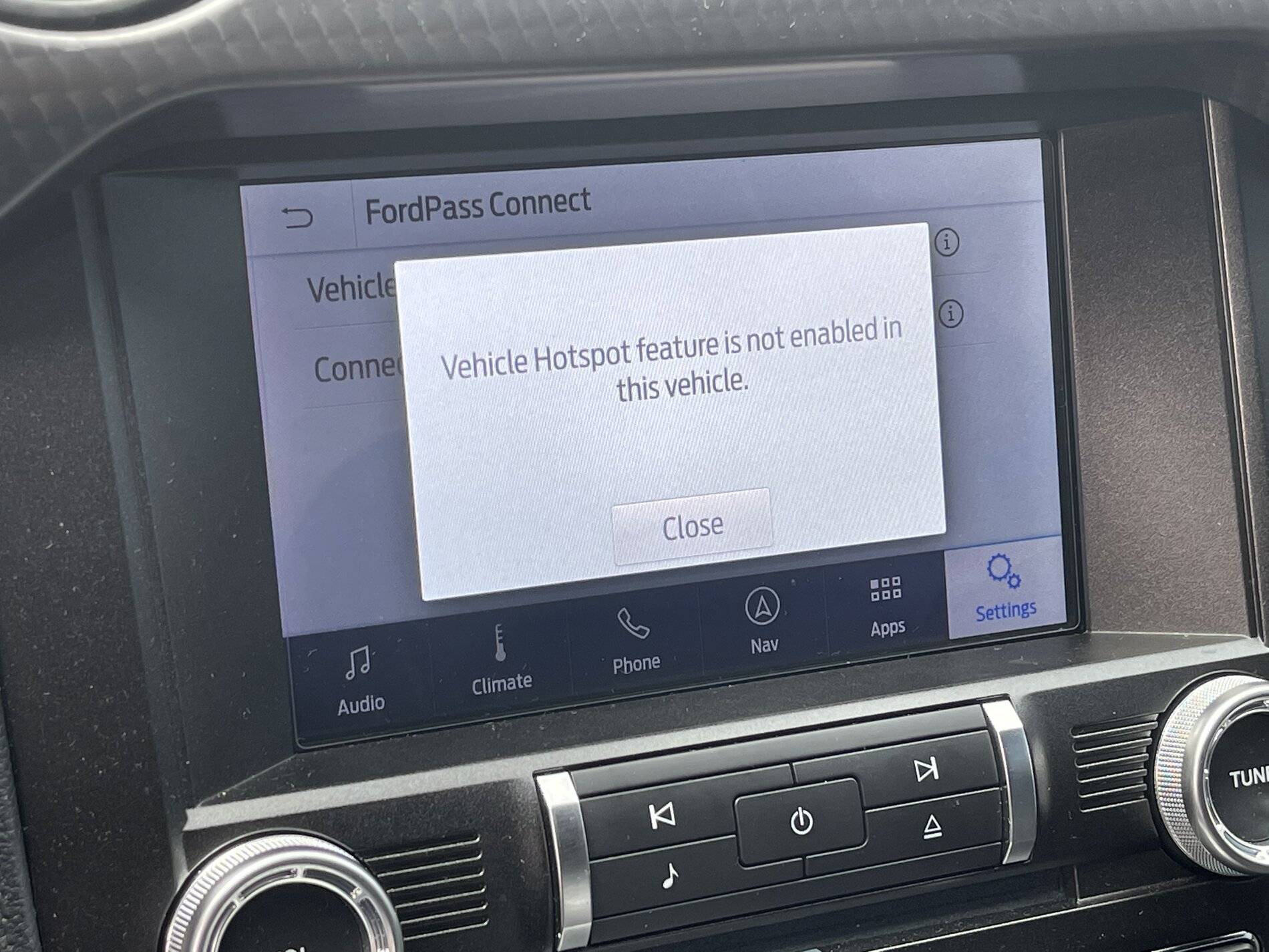

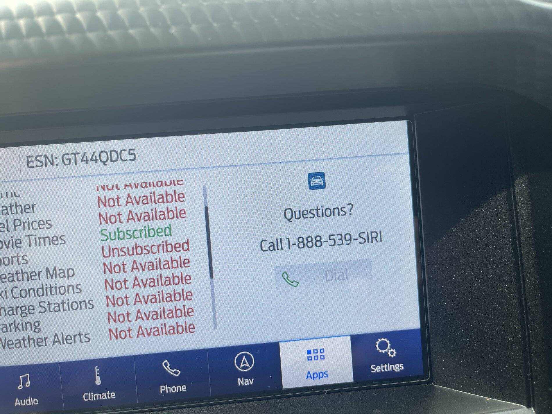

Hello everyone. I need some help with this issue. So I barely use the sync 3 maps since 95% of the time I connect my iPhone or Android to the car. This morning I had to go somewhere but I had left my phones at home so instead of going back I decided to us the sync 3 navigation. Well I couldn’t because there was a gps sign with a line through it. After a few blocks I decided to turn the car off and back on to see if this would go away but it did not. After some trouble shooting I nice that there’s an issue with the APIM. I disconnected the battery for 1 hour and still nothing. I check satellite positions and I get nothing. I would hate to take it to the dealer but if that’s my last option than I guess I will. Does anyone have any ideas of what could be the issue? Or what other trouble shooting I could do?
Thanks!

I am presuming that you did a Sync 3 master reset. Also in the time you’ve had the car do you recall the Nav screen showing on your home screen on startup?

Without being able to troubleshoot your car it's a difficult call to make. If everything is setup properly then something may have failed. The antenna, a connector, the APIM. Unfortunately the only way to find out is to have it looked at by your dealer. Or as a possible alternative, a good auto repair shop that does electronic/audio issues and knows their way around a Mustang.
By the way, just for future reference, electronics is probably the #1 reason buyers opt for the Ford ESP extended warranty.
