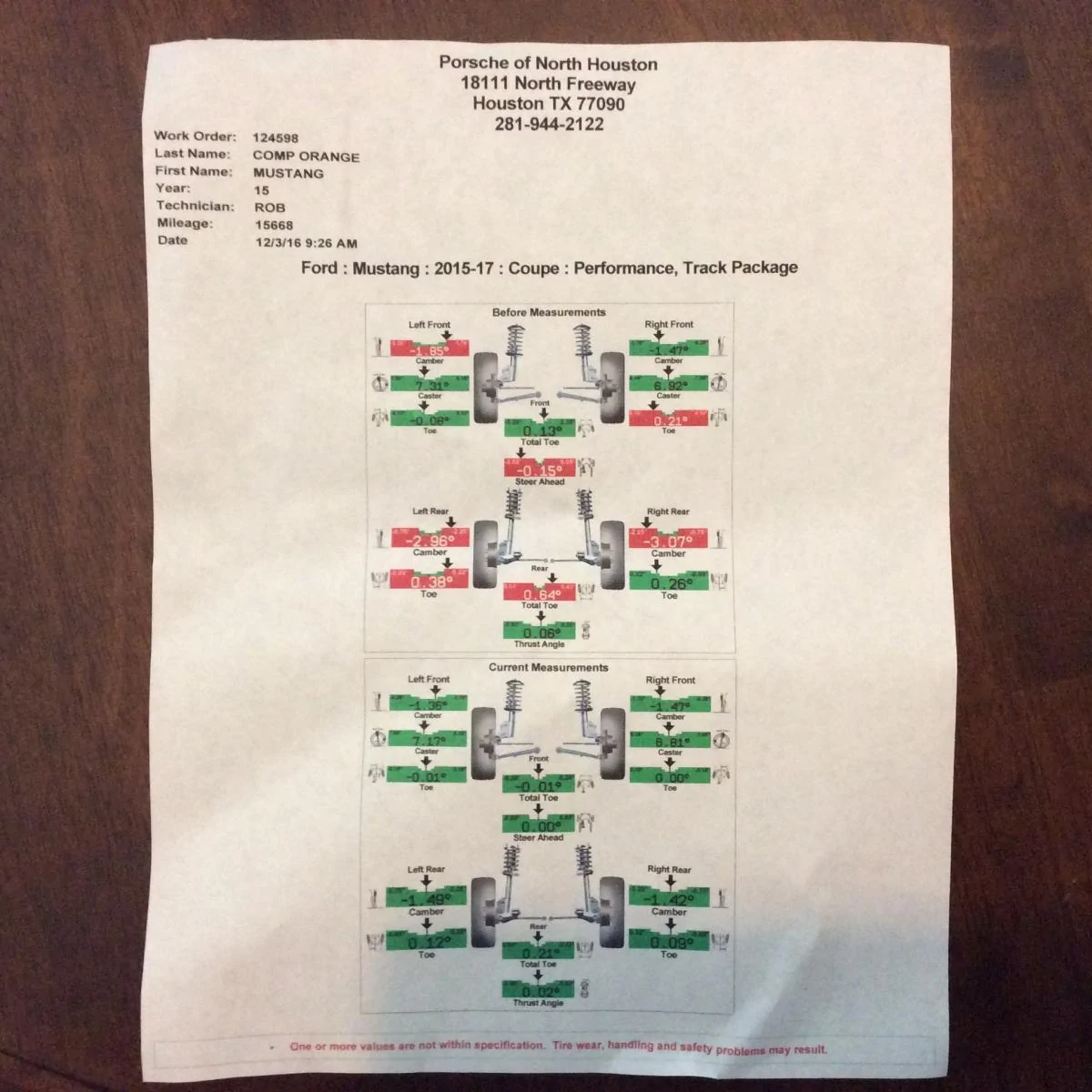

Update: well after meeting very cool guy on this forum. He told me i should talk to this guy Rob.
He got under my car to check bolts. Not only did i have 2 toe rod bolts loise my camber bolt was very loose on passenger side. And as you can see alignment was jacked.
Rob tightened all bolts and did the alignment and car drives very stable. Couldnt really get on it because of rain but i did get it up to 80 and felt very good
To everyone who replied to this thread trying to help. Thank you:cheers:
