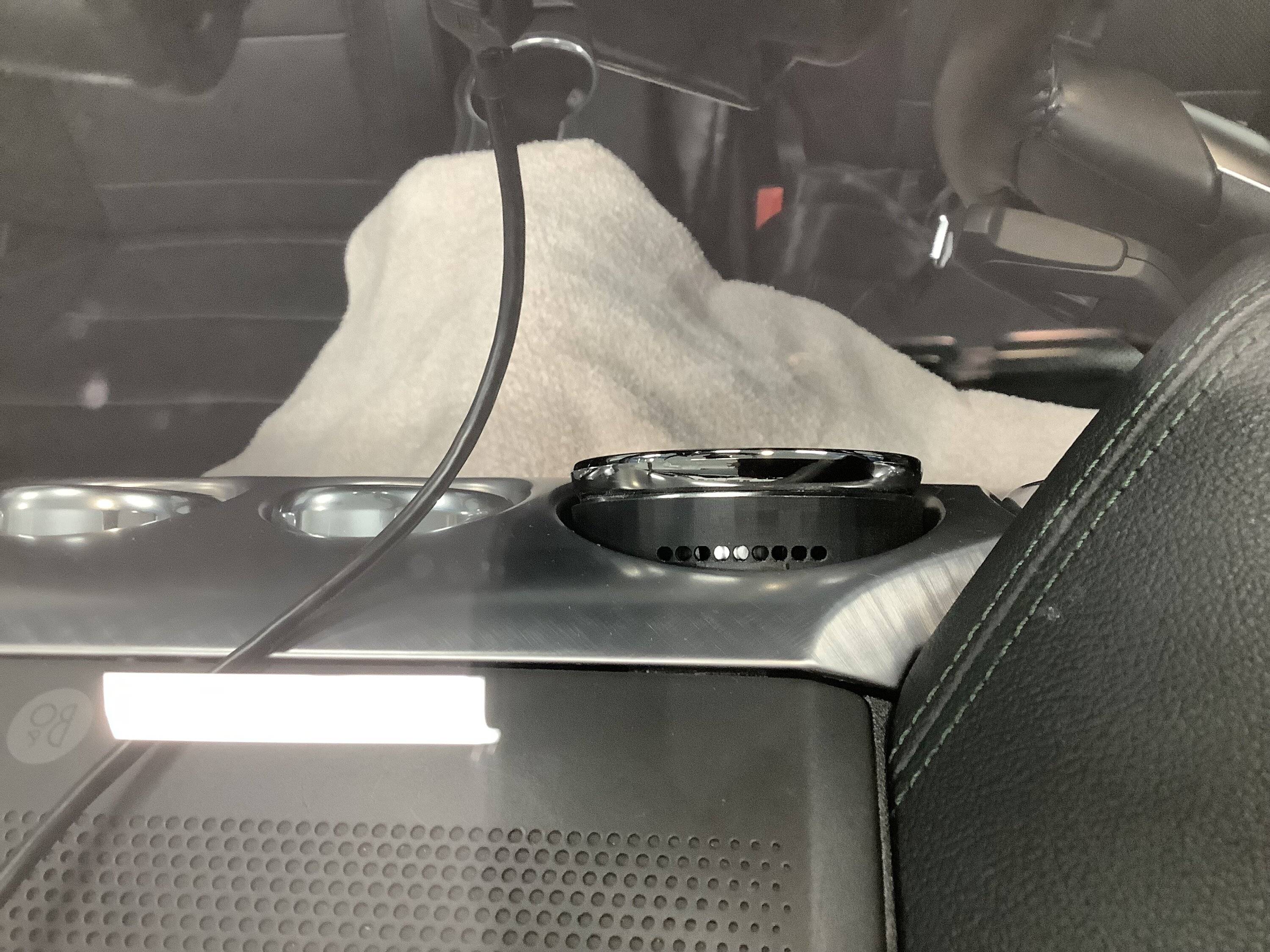

Here is the mount that I use for my nGauge.As you can see, it’s slotted to allow air from the vent to pass through, so the gauge can breathe.

Is this holding up fine, any issues with it ? I'm looking to get this because my windshield mount constantly detaches due to poor suction. Also, I feel this looks much cleaner
Yes, the vent mount is holding up perfectly with no issues at all.
I know what you mean about the suction cup mounts. I have one for my nitrous controller that had lost its long term gripping ability over the last 3 1/2 years (would fall off occasionally). I cleaned the suction cup with alcohol and then used a heat gun on it to restore its grip. I just did this a few days ago and it fits nice and tight once again.

Also forgot to ask, you have no condensation issues right ? Did you block the vent with some material ?

You’re welcome. I don’t have any condensation issues and I did not block the vent. The vent holes in the mount prevent this. I do split the air between floor and dash, so maybe this helps keep condensation at bay.

based on this pic it looks like you aren't using the magnetic one by Joleobee ?
https://www.ebay.com/itm/174972912504
It looks more this one from joshuaahoffman
https://www.ebay.com/itm/2547613127...aSZhkjmAFAyWfoBiVF2etR7J__KZrLehoCShcQAvD_BwE

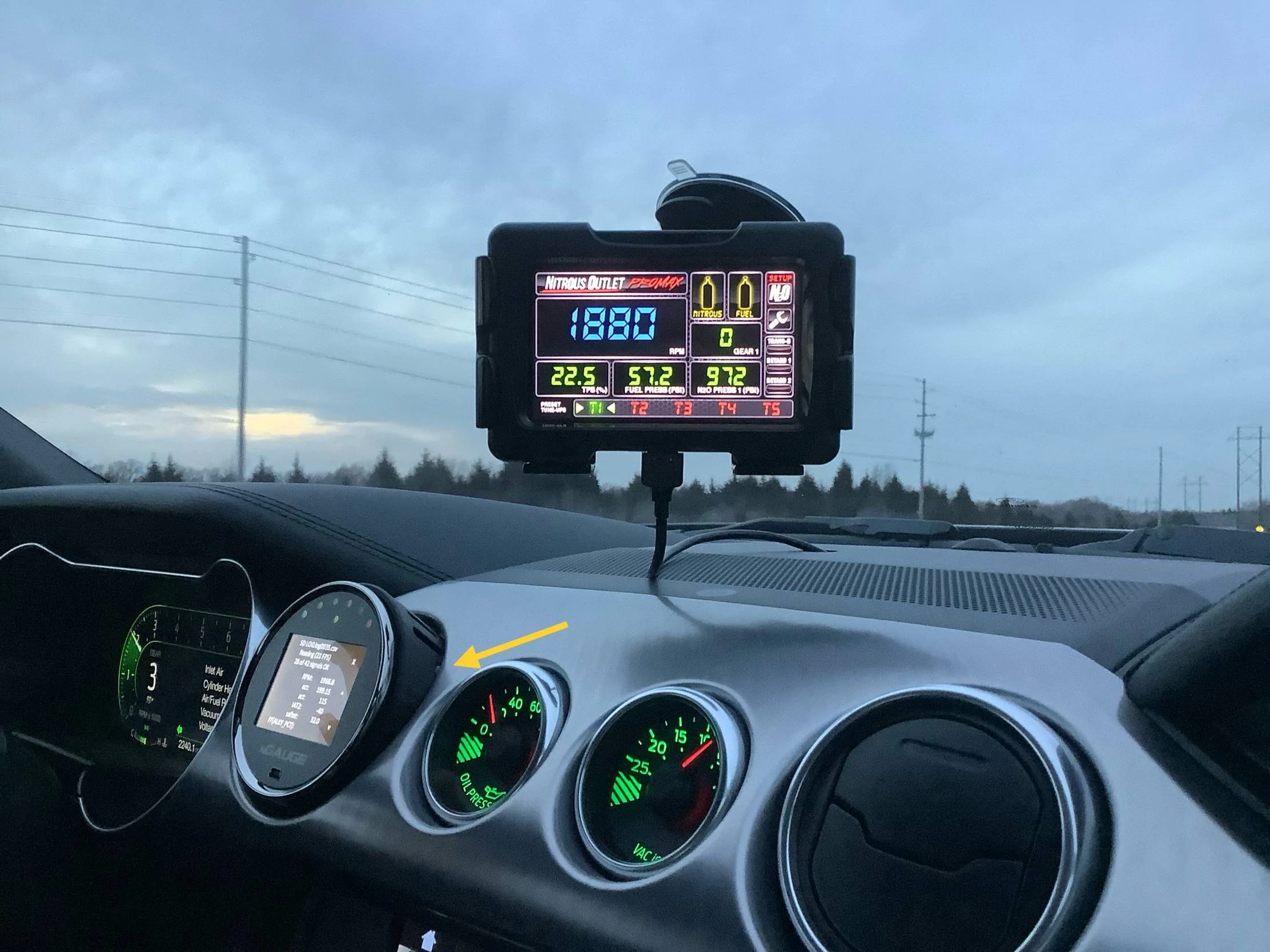

I initially had the magnetic one from Joleobee in the car for about 2 years. While it was convenient to pull the nGsuge when needed, it had two shortcomings that I didn’t like about it.
1. The silicone bumper pads that helped it fit tight into the vent opening in the dash began to lose their adhesion and fall off. I replaced them with new ones that I picked up from the hardware store. In addition, the mount would loosen up to where I could shake it with my hand, although it still stayed put in the dash (this occurred when running the A/C).
2. The adhesive for the magnet let go one day and I never found the magnet, so I switched to the current mount that does not have the magnet.

Here is the one from Joleobee. I marked the photo with a yellow arrow to show one of the three silicone pads that help if fit tight in the dash. The vents in this mount are also a lot larger (elongated) to allow even more air flow.
