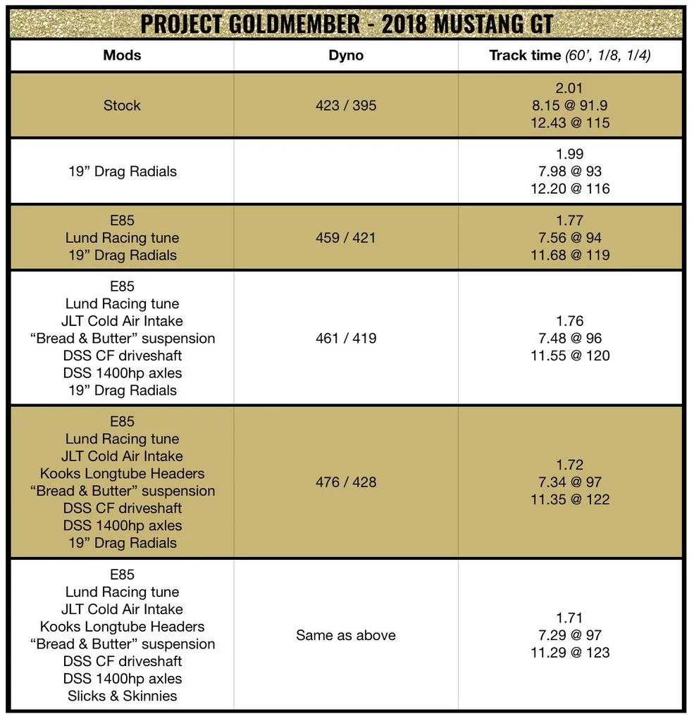

This video should answer your question. If you're not following Alex on social media or youtube, I highly suggest you do. He has tons on information on the S550 platform and extensive experience with the 5.0 Coyote engine as well as working with the best in the business.

Thanks everyone, great info! Seems pretty clear that I can put the cash toward other upgrades.

IMO, Your biggest and most beneficial upgrade will be the tune, especially if you can run e85. You will flow enough air with a drop in and a resonator delete to reach 490-500 chp. Outside of that, add a sticky tire because the 10r80 with the stock Michelin Pilot Sport (summer) tires will break loose on the 3rd to 4th gear shift. If I were going to do any additional mods, I would have the stock intake manifold ported, add some cat deletes and call it a day. If you plan on doing any drag racing, axles would be the next logical upgrade.
