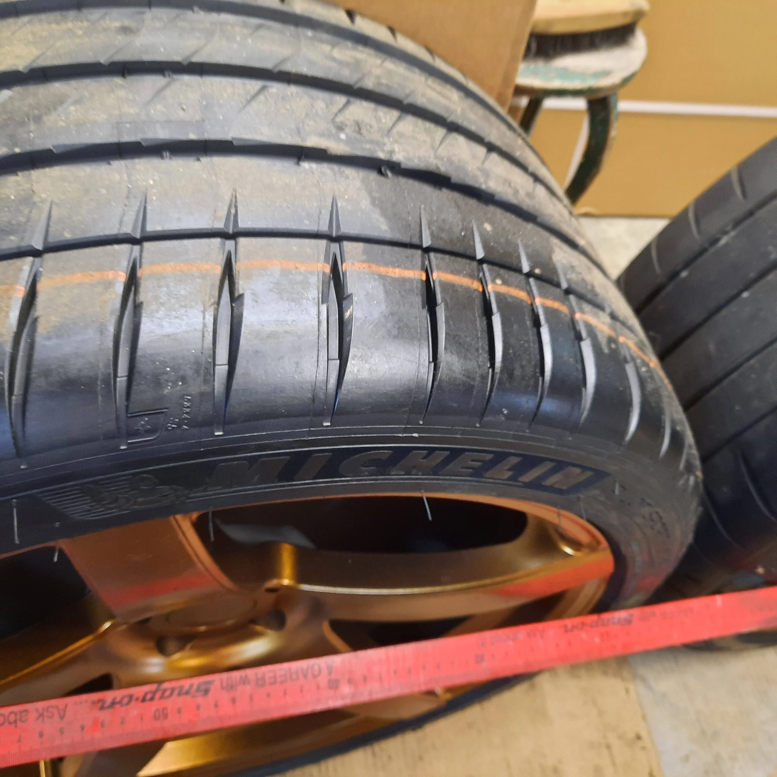

Pics tomorrow if no rain. I’m beat I had to bring the wheels and tires to a shop with a touch free machine with my truck. Pick them up this afternoon. Then swap out the all seasons with the pp1 wheels for the PS4S with the new forgestars not so easy at 66.

I am contemplating these wheels now and might go this route. Can you guys tell me if the wider rear wheels are more concave than the fronts? The design of the CF5 is so classic and easy to care for, my D5's are awesome but thinking of going back to 19s now.

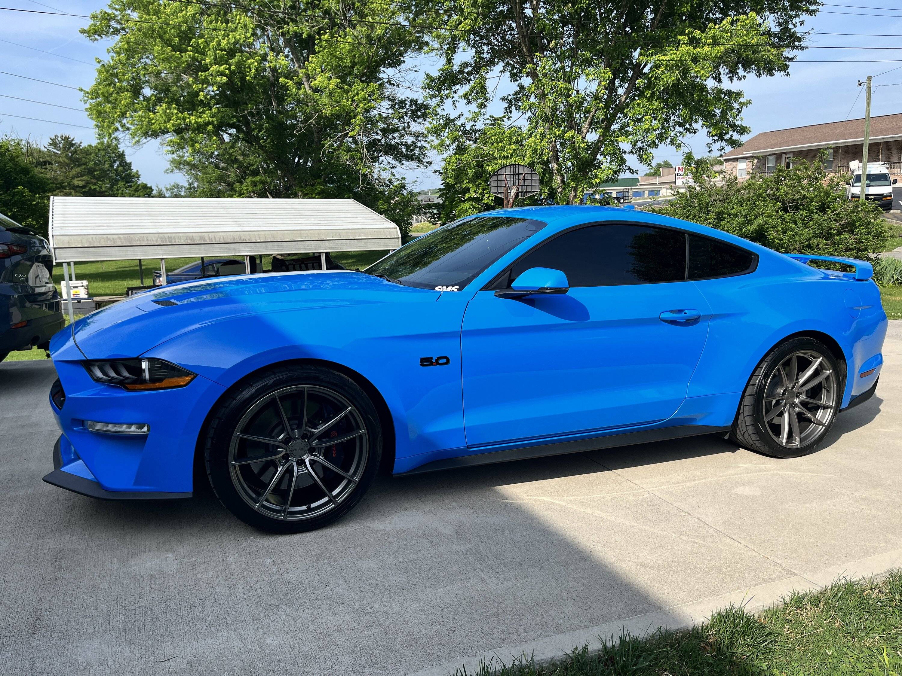

Very very sweet!!! I have same car except carbonized gray. What are your offsets and tire size if you don’t mind me asking
The ones in the above picture are factory PP wheels with factory 255 40 19 and 275 40 19.
My summer setup is Velgen VF5 in Gunmetal Gray 20x10 +33 and 20x11 +55 with 275 35 20 and 305 30 20.

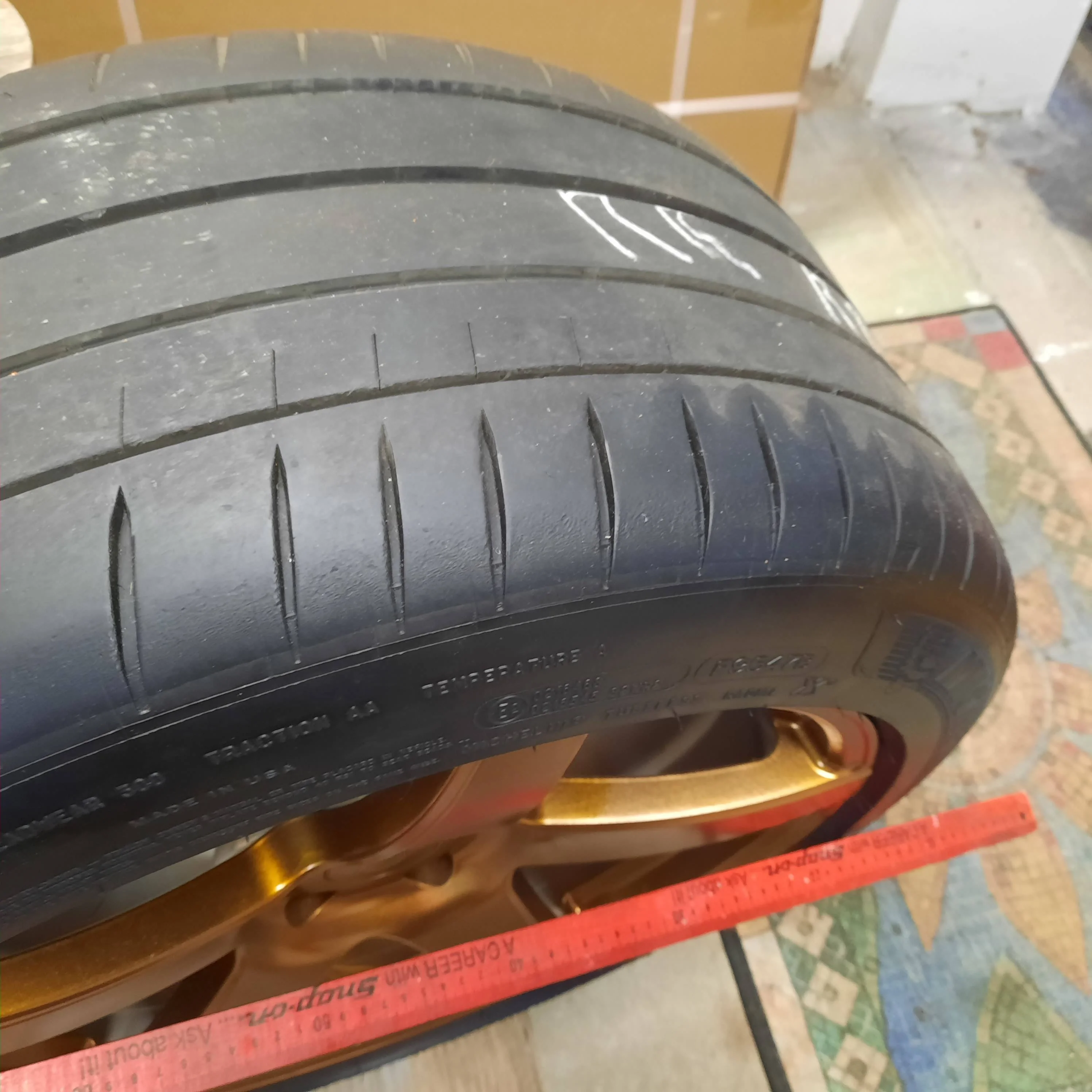

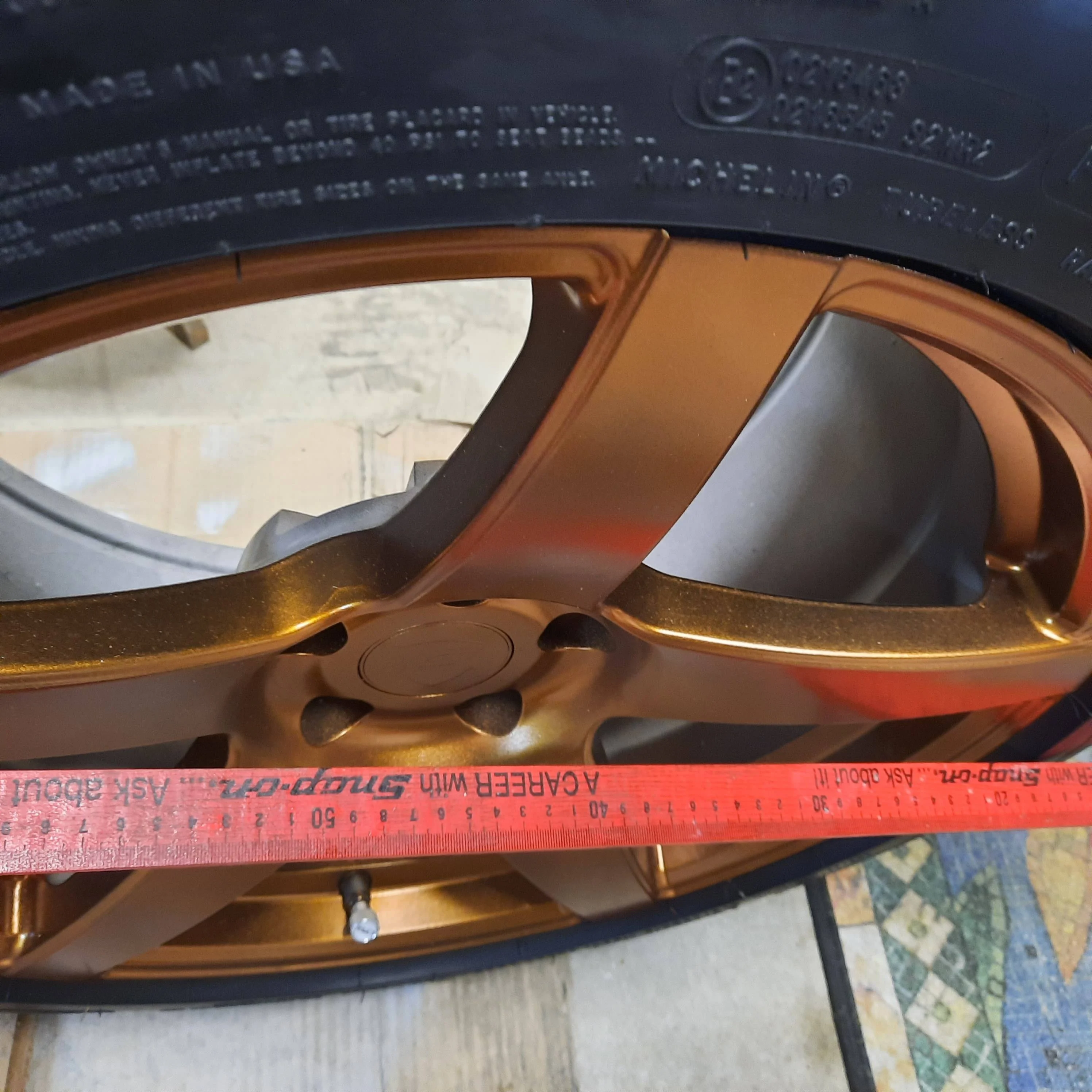

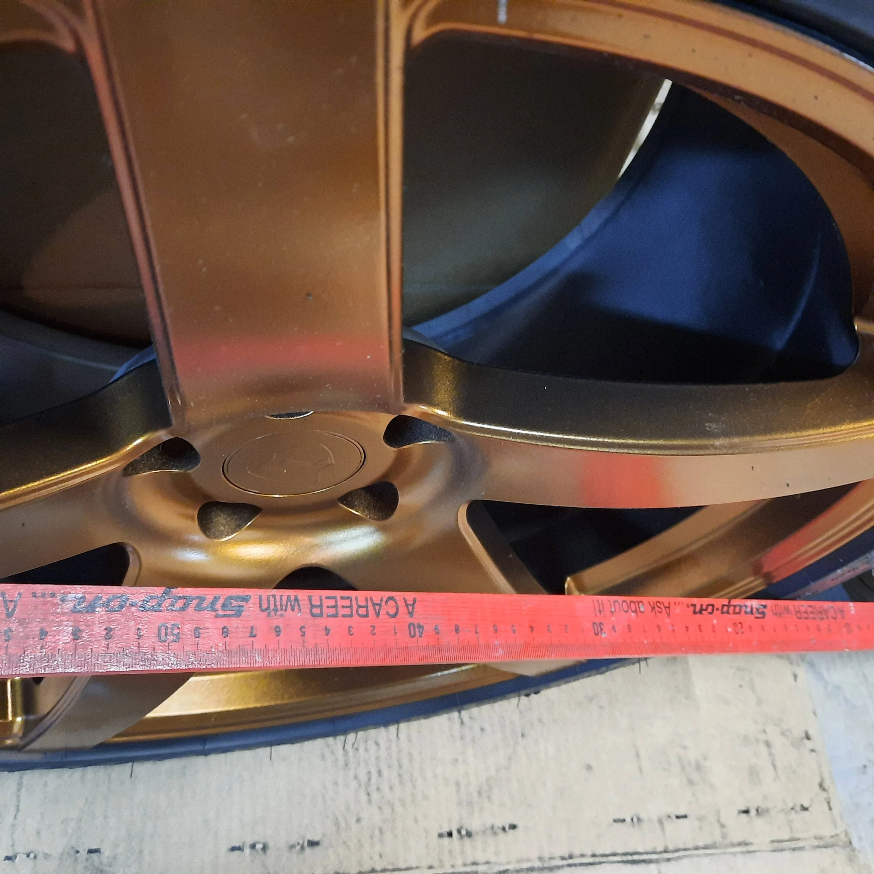

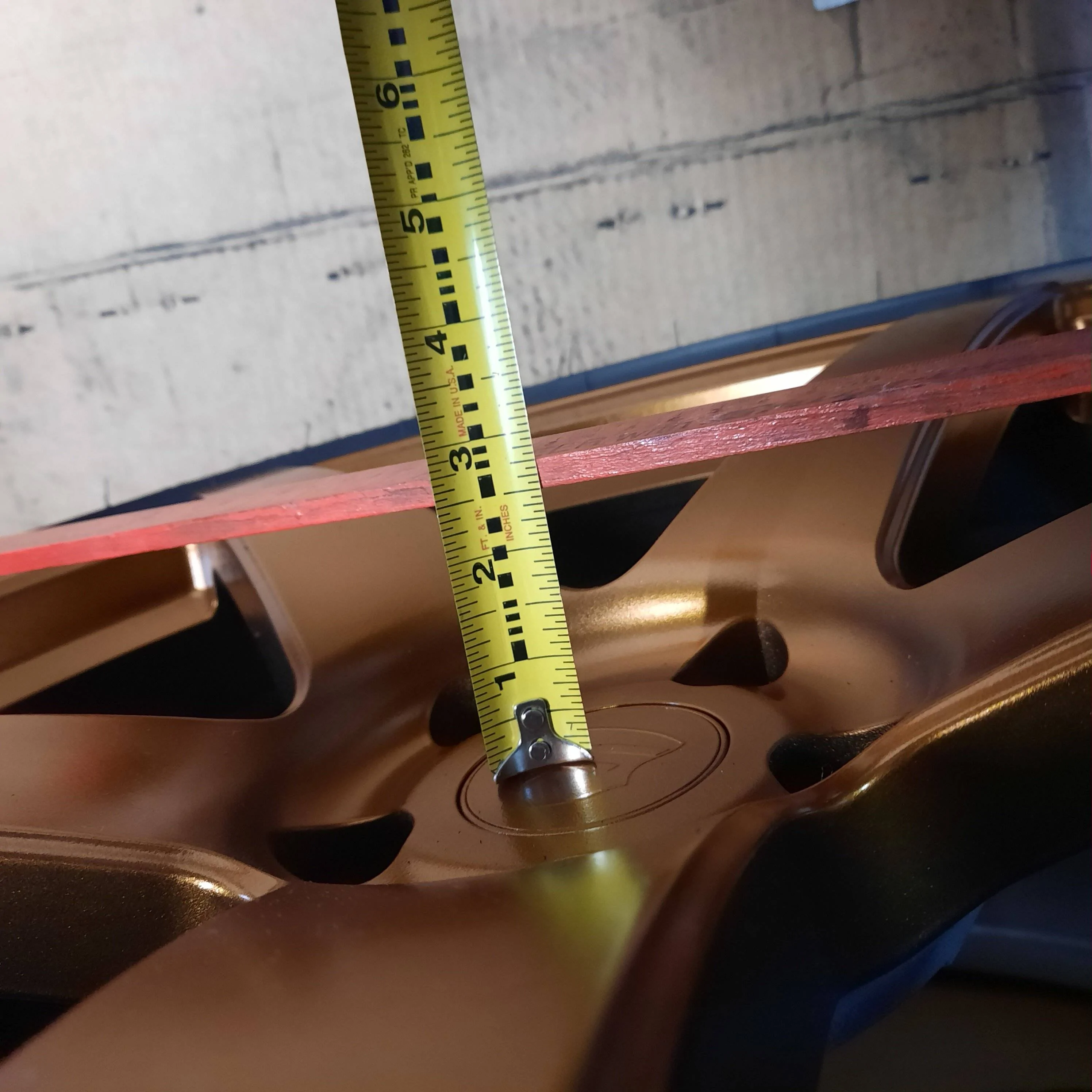

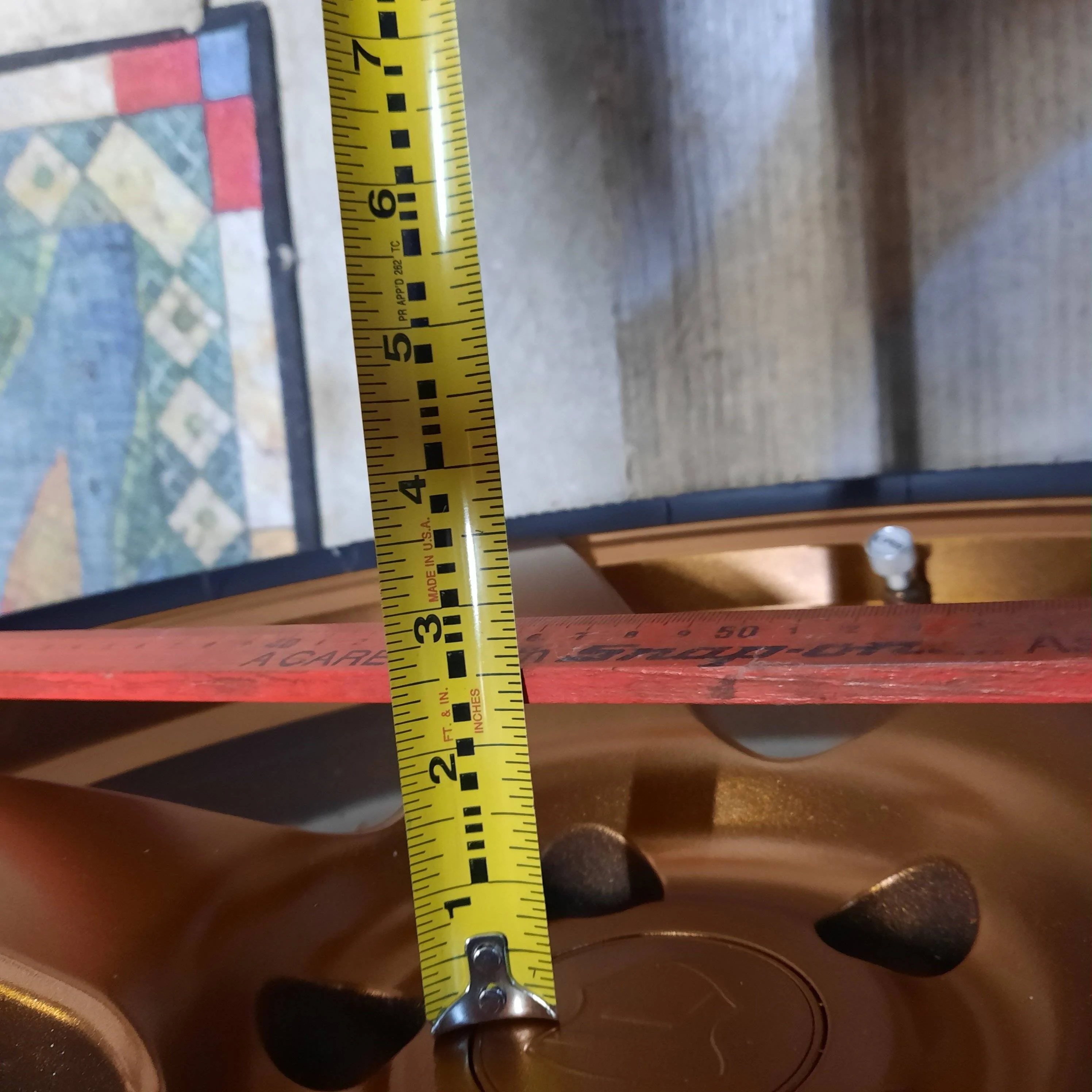

One wheel is 19x10, other is 20x11. The. 11 has about 1/4" more depth. Offset plays a big roll. +42 on 10 and +56 on 11"
