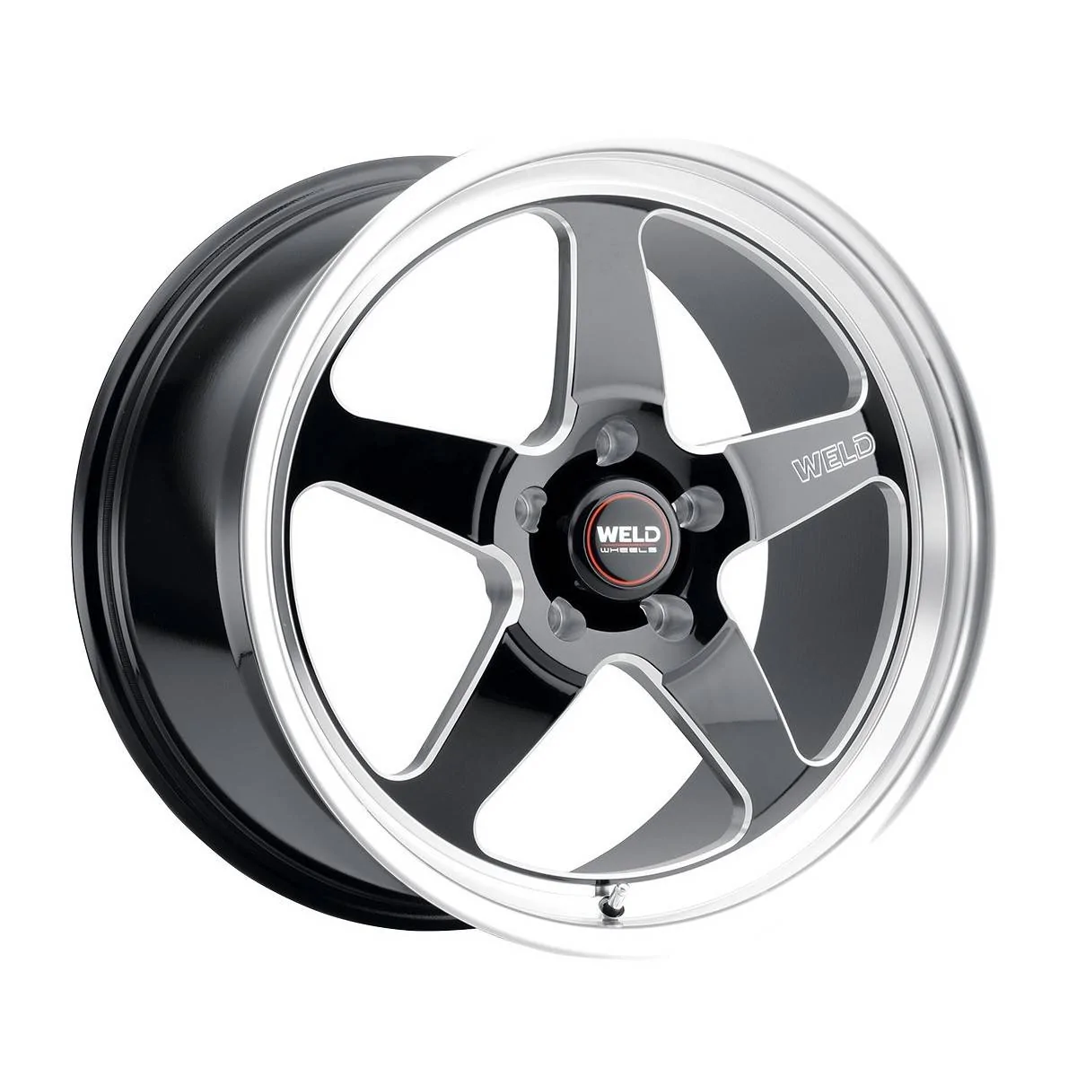

Hello everyone! A few months ago I purchased a 2020 GT/CS and it’s the time to start looking for wheels! I’m currently looking at the Weld racing Ventura wheels in 20 x 10.5 +50 (rear) and 20 x 9 +29 (front) I’m not a racer, but I really love the way these look. I’m looking for flush fitment and am currently stock ride height. I plan to lower the car shortly as well. Will these wheels fit? Any responses are appreciated! Thank you!

They’ll fit, but they won’t be perfectly flush.
Thanks for the reply! They would be poking out a bit correct? I was mainly concerned with the offset as I haven’t seen many people run a +50, and I’m not sure if I need spacers or something similar.

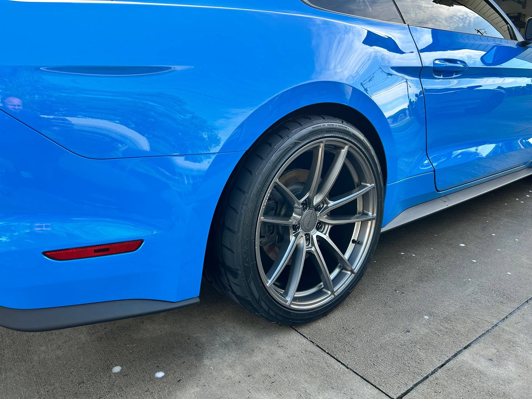

No, tucked a little. For example, I have 11s in the back +50 offset and they are flush. 10.5 may tuck just a little. My 9s up front are +28 and I run a 1/4” spacer to get them flush.

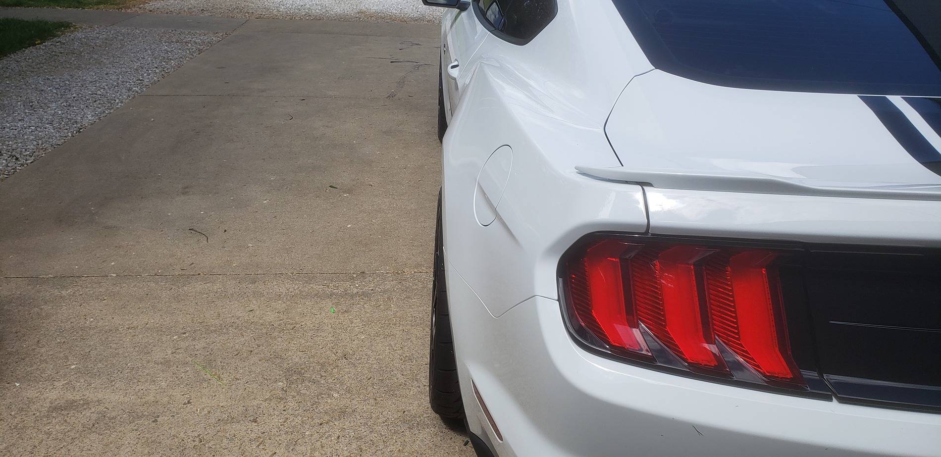

Different wheel but I run 20x11 +50 offset on the rear. They are pretty flush. 10.5 will sit inside a bit.

a +35 offset in the front will get them flush, +50 in the rear.
