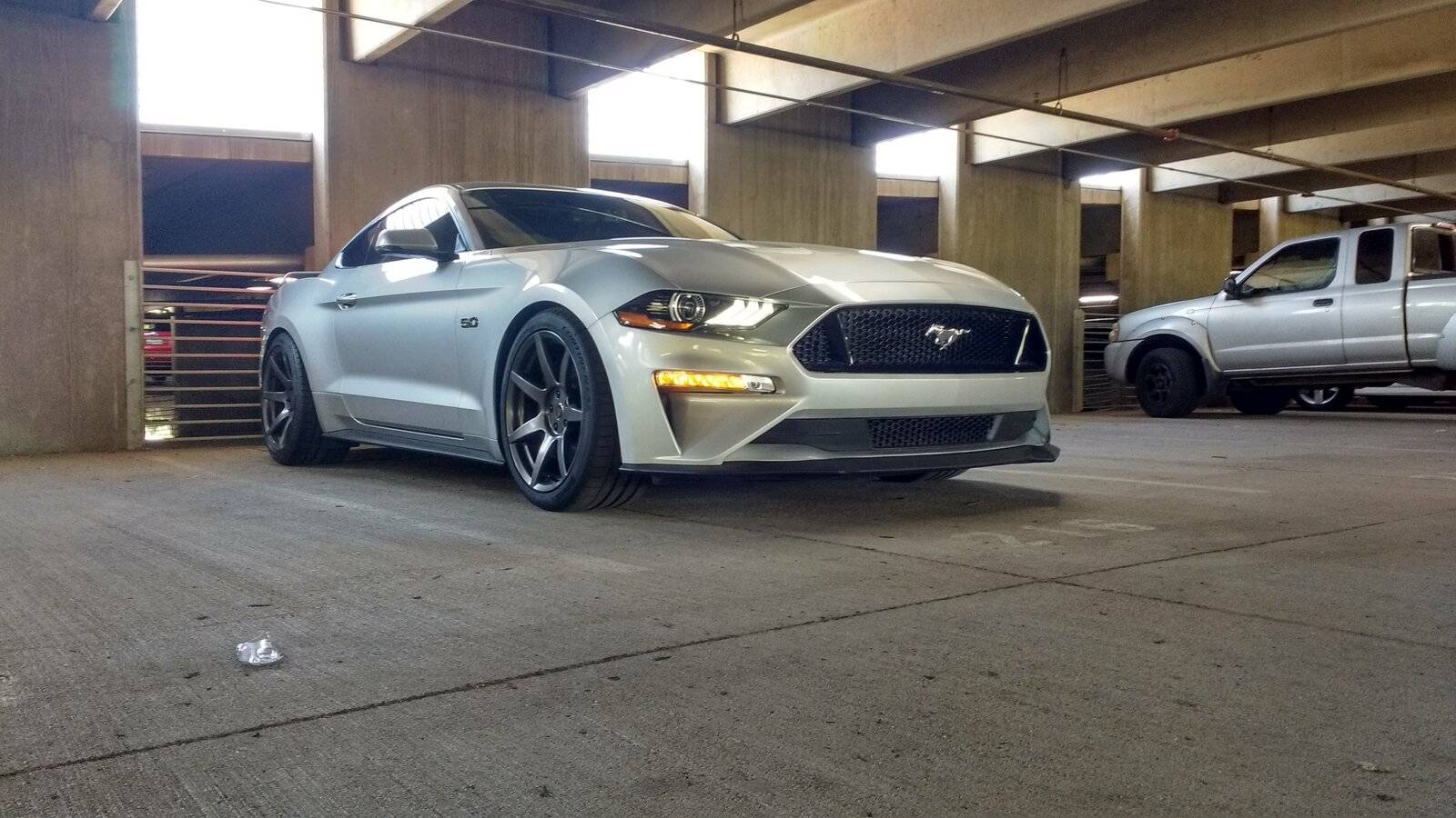

Finally.
I ordered a new suspension/wheel/tire set up which is listed in my sig. After a horrendous ordeal with Need for Speed shipping and customer service for the wheels, Steeda and Discount Tire were great, I think I'm about 90% done. I've been driving the new parts for a month, now.
I like the feel and road handling so far. It does ride a bit more harshly when moving at lower speeds and hitting cracks in the road, which I was expecting. Other road issues seem to be smoothed out by the lighter progressive part of the springs. On the freeway, it is very smooth. Acceleration seems to feel better as the rear doesn't squat nearly as much as stock did and the wheels, themselves, are around 8lbs lighter each. Having fresh rubber to the ground also is a huge factor as I had very worn tires. The wheels are flush, but I do have a very small amount of tire poke (1/4", maybe?) *edit: rears only*.
I do have a knock in the suspension at very low speeds, such as coming out of the driveway off the curb and also sometimes with forward/backward hitting the brakes. I'm going to check the end links on Monday and the paint marks on other bolts the installer put on to see if anything moved.
As for the last 10%, may do the Steeda rear subframe support braces and ??? front sway bar.
Here is the result:

Looks great!
I experience some very low speed slight harshness too with my X Springs and Bilsteins; I did also with Ultralite Springs and twin tube ProAction dampers (more so with higher spring rates). It’s the nature of the beast with this chassis, suspension design, and lowering springs. Aftermarket shock mounts helped quite a bit in my old setup to smooth out the ride.
I did though ditch aftermarket shock mounts a while back due to incompatiblility with the Bilsteins, but am tempted to try them again now that options are available. I’ll let you know if I pull the trigger and how they come out.
