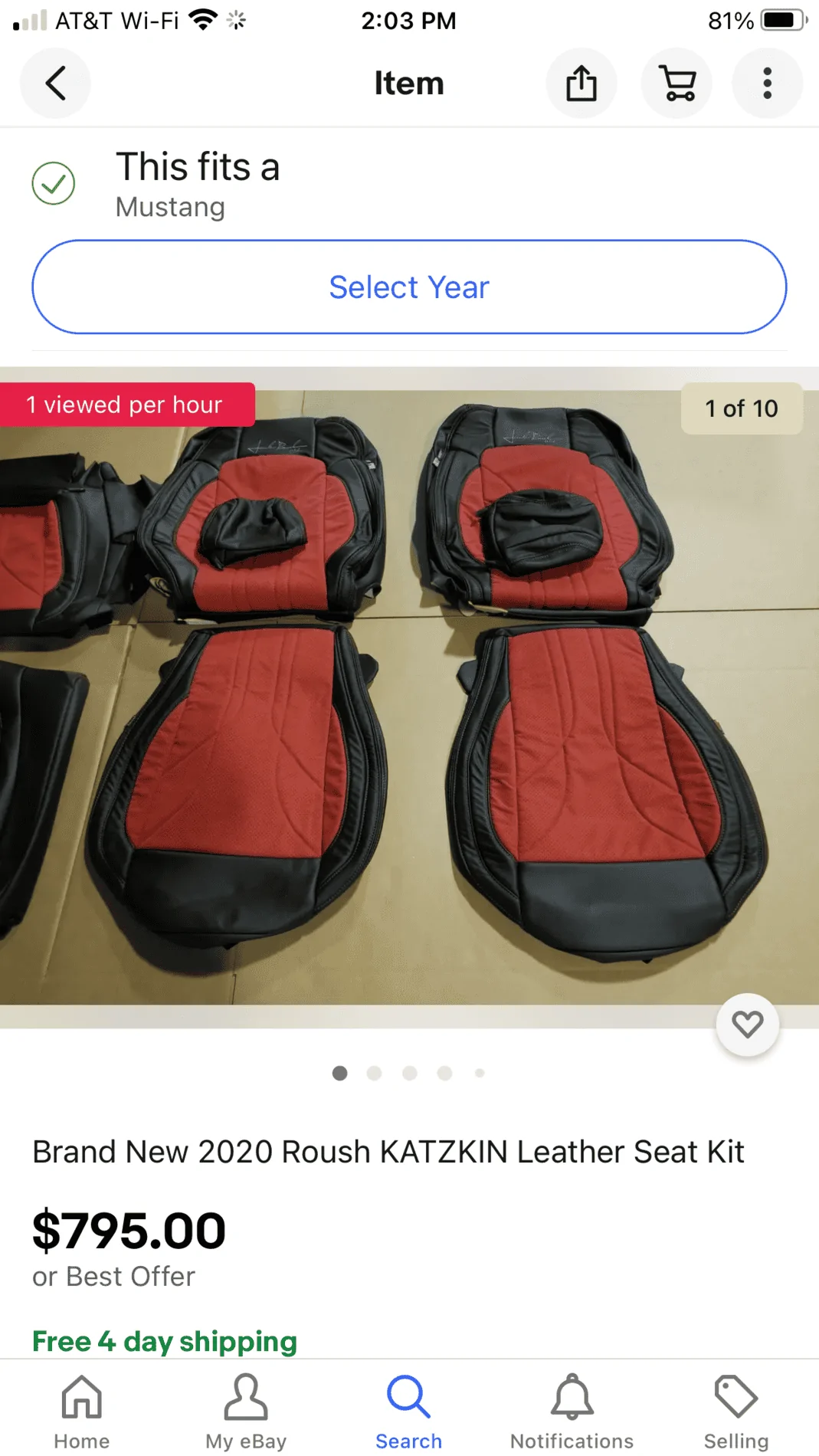

New seats installed today

Katzkin covers have a nice quality and craftmanship. They are just on the pricey side.

Yes. They are pricy but did my research and they were the best looking seats I could find. Others looked well not as form fitting and looked cheap

How am I just finding out about Katzkin? $1900 looks very reasonable to recover the seats, this is high up on my list now.

Hey, it's worth it, they look great! The red panels really pop; when my cloth seats start to look tired, that's the direction I want to go (except yellow panels) :cool:
