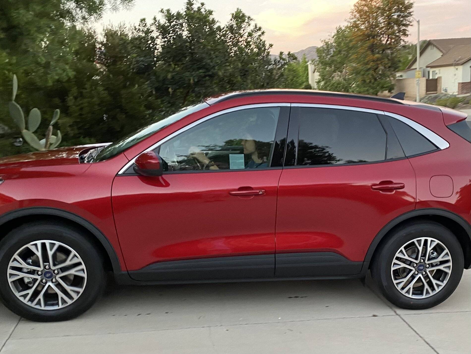

This piece of shit is actually fairly competent at getting my 17 year old back and forth to high school, and at 0% for 6 years, it costs about $11/day to own. It's also better than the Plymouth Volare I learned to drive on. And comes in the same color as a GT 500.
That said, if there really is a problem w/ DI motors, what can you do about it?
