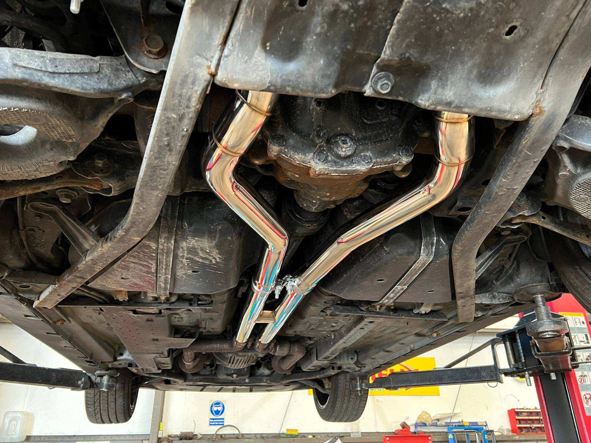

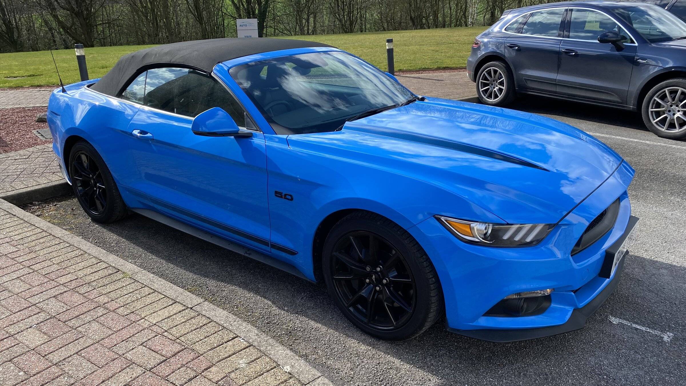

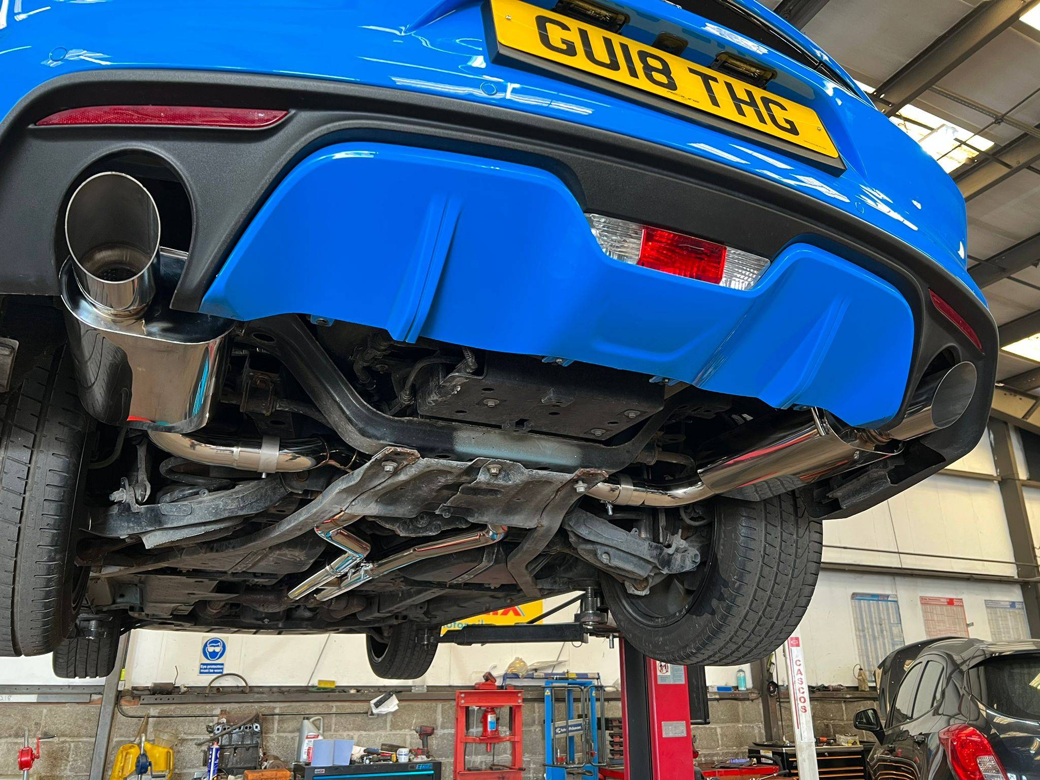

mini update to my Mustang ownership journey!
Had a Gravity cat back system (H pipe and sport back boxes) fitted a week after i got the car, bought it through ebay for £400 and found at checkout there was a 20% off offer (max £75) so go the system for £325! :)
Happy days!
The extra noise is great but i want a bit more so have a PLM 2.5" with 4" tips axle back (back box delete) straight pipe on it's way from the US (Ā£232 all up including customs)

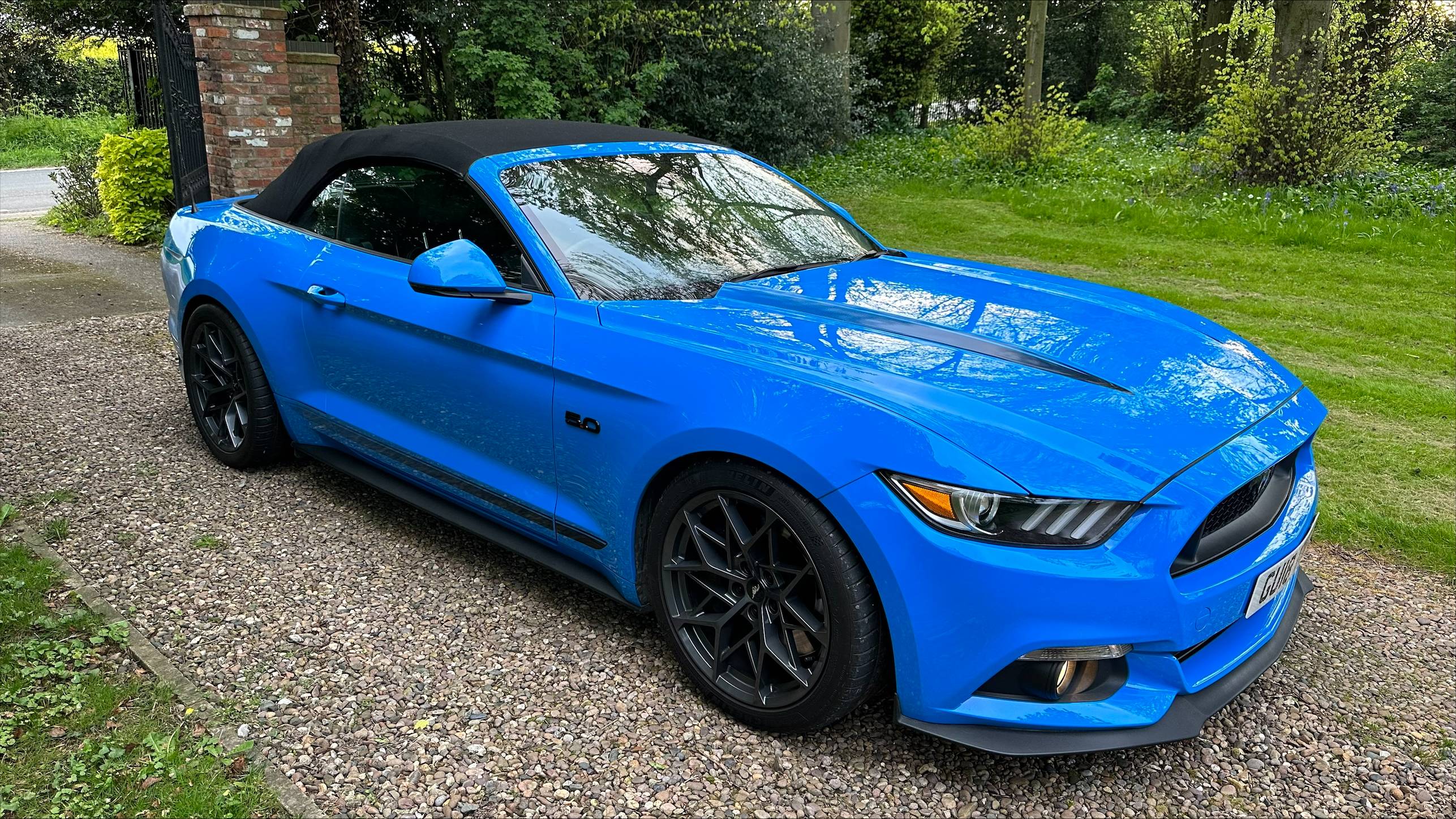

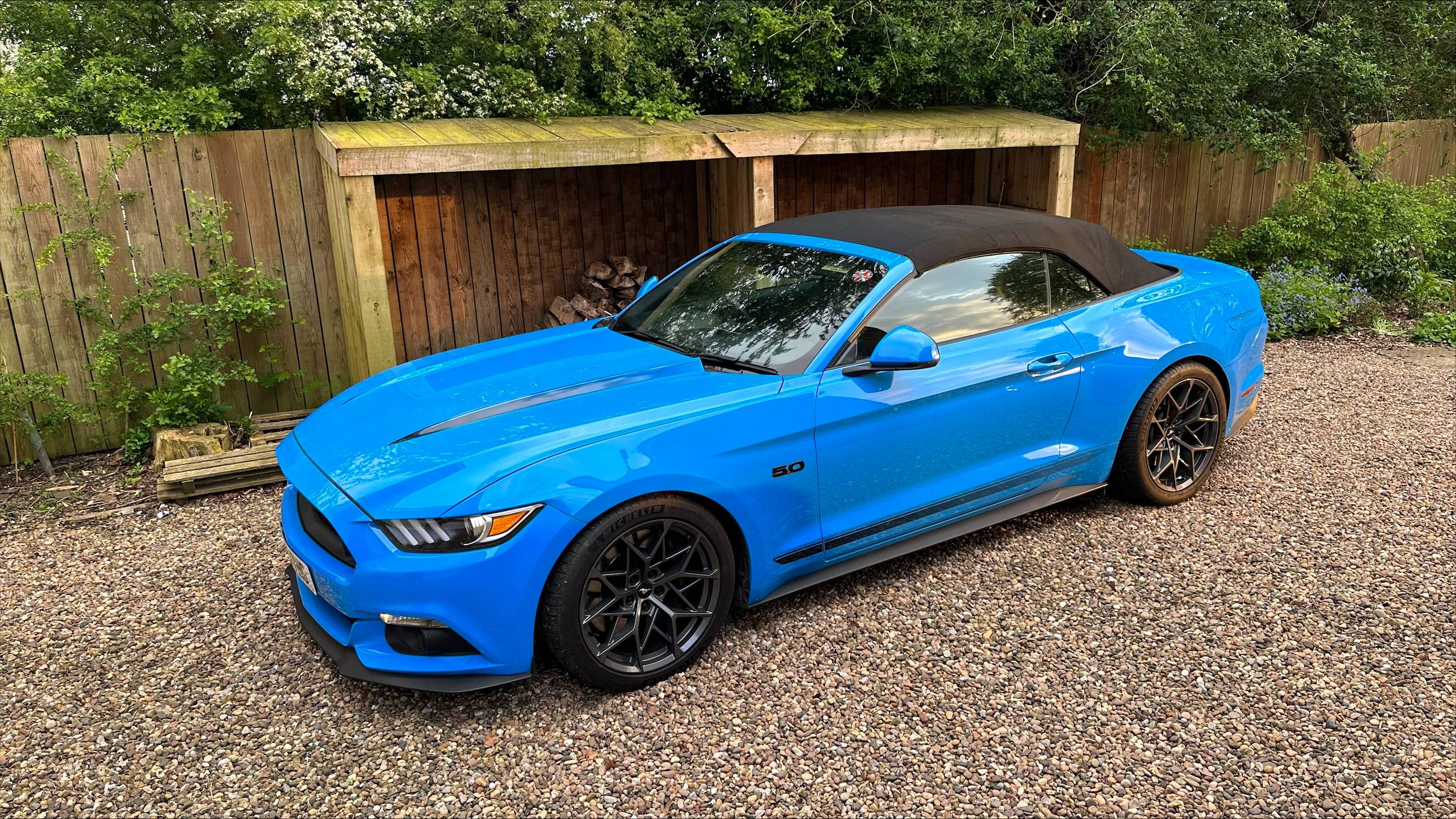

I haven't updated this thread for a while so here goes:
Posted details and how i got them on a separate thread, but having previously seen a Mach 1 with the optional US handling pack 'bird nest' wheels, I decided I needed them!! :D
After a bit of research I bought a set of the Ford performance mach 1 handling pack wheel kits that SVE produce. The 10" front with 41mm offset means it won't protrude as the original oem HP 10.5" wheels would without a wheel arch liner extension.
Rears are 11" with 50mm offset, straight bolt on with these offset's etc.
Tyre sizes are 285/35/19 Front and 325/30/19 Rear, no issues with clearance and right on the limit of aligning with the rear wheel arches. No spacers needed!
Recently had it's first service under my ownership as have had the car just over a year now. Done approx 2600 miles in it.
No issues to report, took it to Motorsport and Performance in Batley. Along with the service i had some Steeda progressive rate springs fitted to drop the car about 1" (and rear ride height spacer) then of course along with that an alignment. Also 2018 intake manifold upgrade, JLT cold air induction kit and sport filter and it custom re-mapped on the dyno to set it all up properly with the upgrades.
Got an extra 40-50hp with 411 at the wheels which i think is about 470-480 at the crank. Not to fussed about the numbers, just that it's running properly. Car feels very healthy in comparison with much better mid range torque as you can imagine and the stance is exactly where i want it to be now.
The handling has improved lots yet the ride is still very comfortable.
The difference compared to when i first got it is huge! Very happy now :)
Possible only other upgrade i might consider is an Xforce downpipe with 200 cell cats.

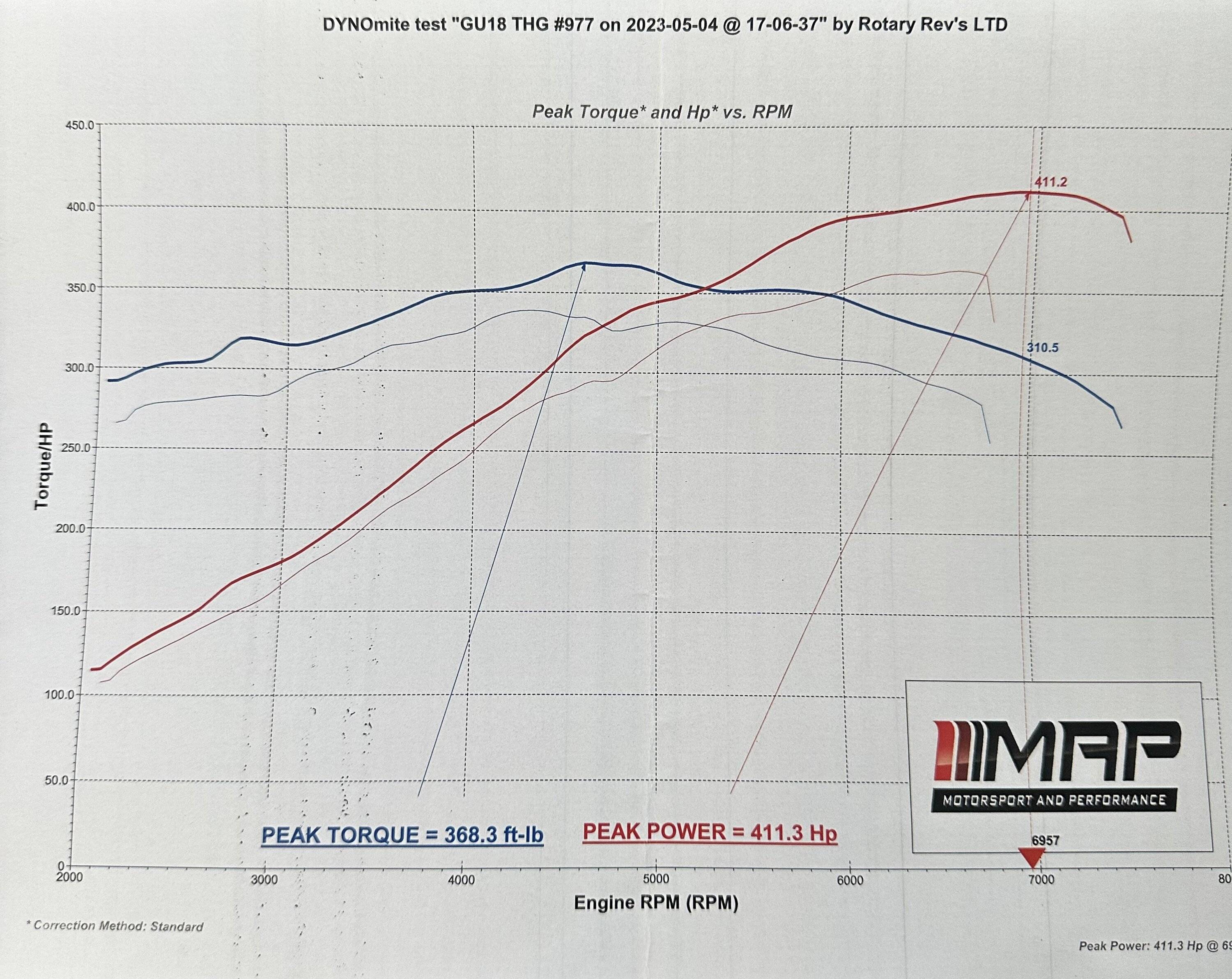

Simon, the car looks awesome mate. Did Ben give you a copy of your dyno sheet? Here's a copy of mine to compare. I have a M1 with Kooks headers and cats, and ECU tune.

yes he did, you have some nice numbers there which looks about 500hp at the crank! That's the goal for a NA motor! :)

There are different calculators available online, but I use this one sometimes. It suggests that your car should be already at 478hp at the crank.
The headers and cats, and tune to go along with them, will completely lift up the torque at 3,000 RPM. MAP put on +100 ft-lbs of torque at 3,000 RPM over stock for me. It drives like a different car. Your car stock seemed to have a little more torque at the wheels than me at 3,000, probably because you have a manual vs my A10.
Wheel Horsepower to Crankshaft Horsepower Guestimator (mk5cortinaestate.co.uk)

ahh that's really interesting to know!
Yes agree the car drives completely differently, the mid range has been transformed so much that now instead of almost bogging in 6th it actually pulls nicely.
There is a nice metallic induction sound now! :)
Limitation with my car now the intakes have been upgraded now is getting the significantly increased exhaust gas flow out the motor. Hence possibly getting race cats and headers in future! :)
