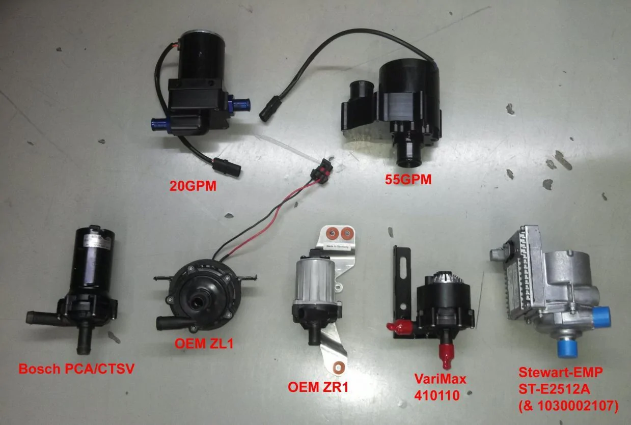

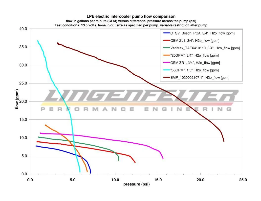

What is the Flow comparison in gallons per minute versus the old pump?
Not an exact comparison, but pretty close. I believe original pump is similar to the bosch and the new to the varimax.
