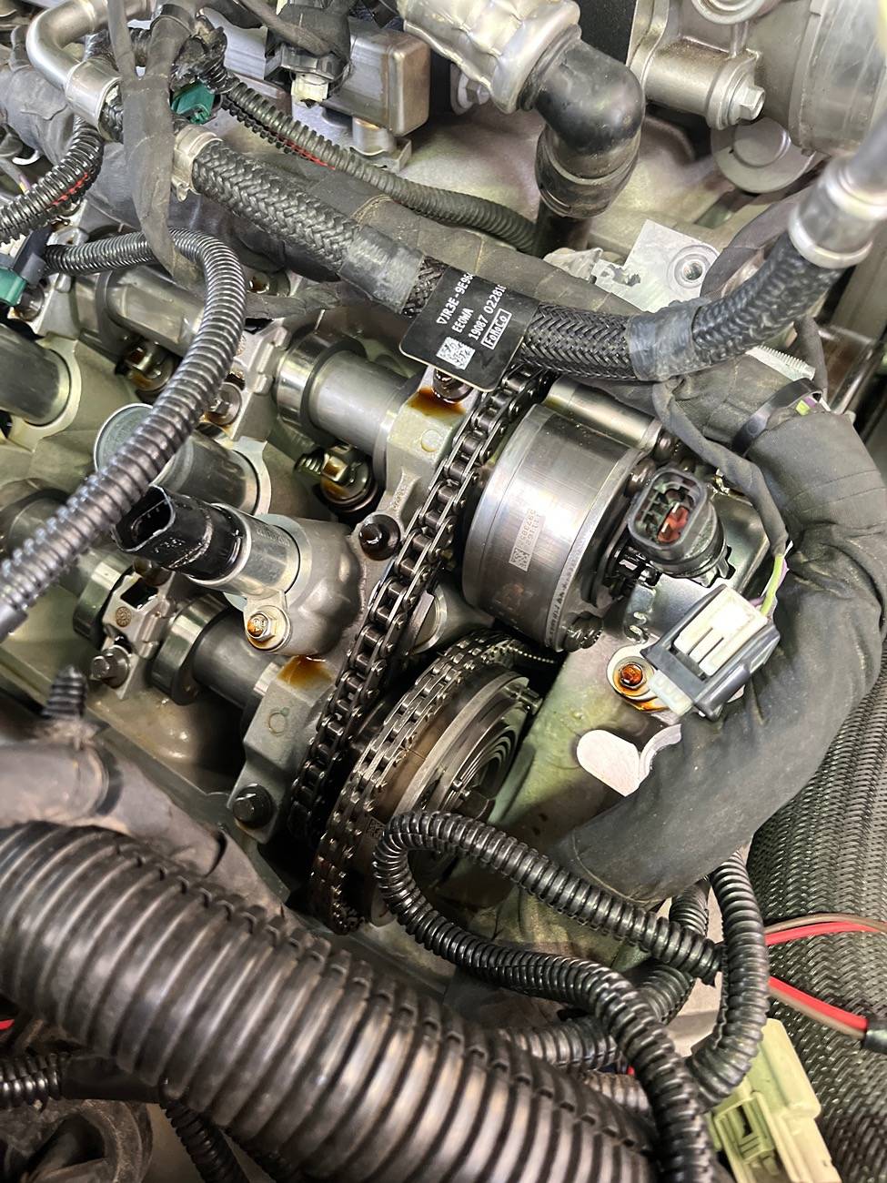

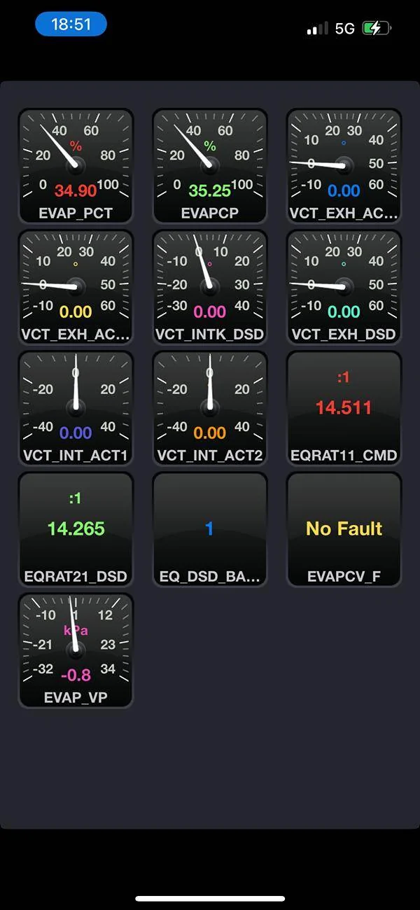

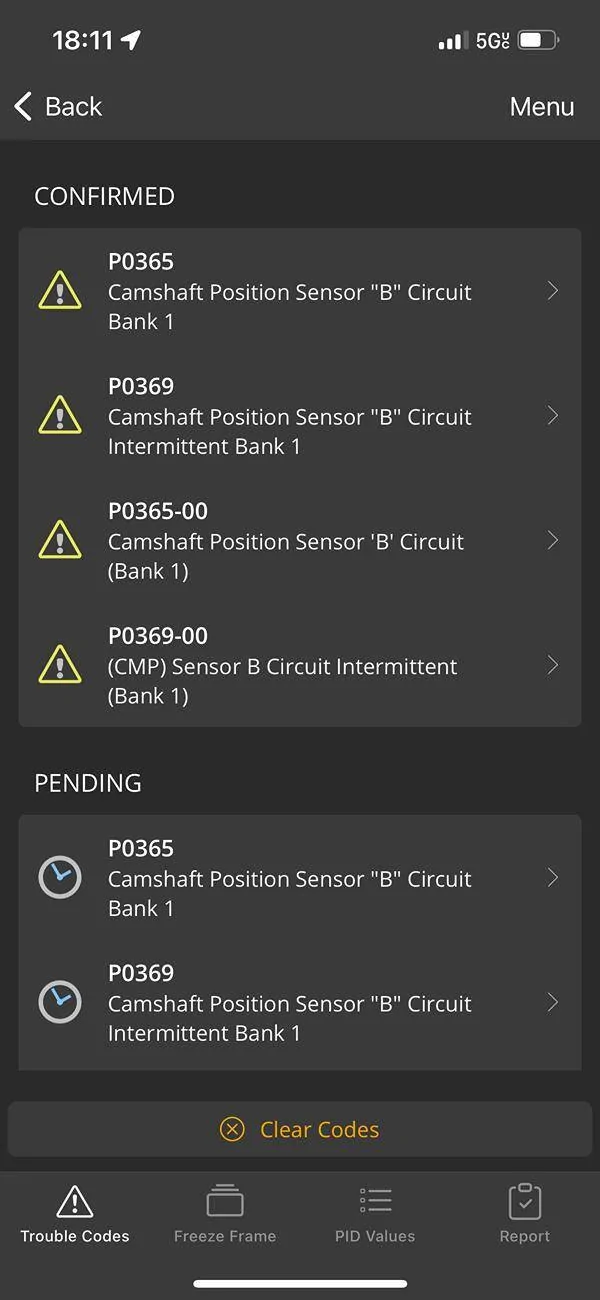

Hello all, a continue on my previous post talking about the intermittent stalling issue, previous diagnosis came to a (hopefully the right) conclusion and replaced VCT solenoid #1(intake) on bank 1, the exhaust solenoid was not necessary to replace but I went ahead and did it anyways because it was a “might as well” thing at that point. So we put everything back together fired up the car, idled and ran perfectly, cleared the cores and test drove it and it was flawless, came back later to the car and turned it out, found these new codes, I also noticed on the forscan app, that the VCT values were not even working or reading, before they were before all the work and diagnosing, any thoughts?

Check wires/connectors.
Yup! Was the camshaft sensor in the far back that was unplugged, must have forgotten it, plugged it back in, cleared everything once again, fired it up, everything was completely butter smooth, drove it, left for a little, turned it back on; and no CEL came back, nothing pending; and the VCT readings finally started working again, I think it’s safe to say the car is finally back to normal!
