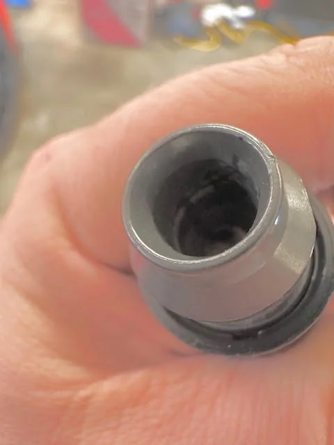

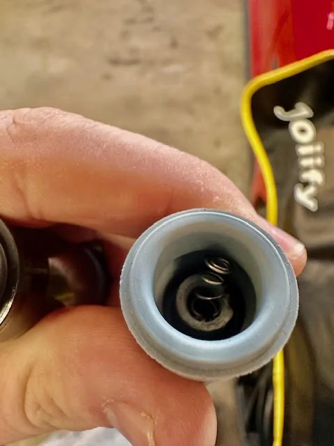

Well... it hasn't been all sunshine with this setup so I am hoping some can help me diagnose. Maybe I am anal, but since my first start, I've noticed an uptick in vibration: engine/transmission vibration particularly. I do run BMR's poly mounts but before others say "that's your issue" it's not, I already played the engine mount game and it's far worse with stock units. Now the odd thing is the vibration comes and goes. Drive down the street or idling at a light and I think to myself "damn if finally smoothed out" but then the next light it doesn't... I tired to use my SCT to do a crank relearn but it errors out (not sure why), so I use an older HPT device and software to complete the task and it makes little to no difference. I have received a 'random misfire code' and it started to backfire on shifts/decel till one day it finally told me a cylinder (#3), which crazy enough turned out that the coil was arcing between the coil and boot - coil side was charred up and the lead was bent; these were new.
Nevertheless, I swapped back to an old set of coils thinking "YES" finally got it. But... no. Car runs pretty much the same and when I check to see if there's codes it has a "permanent" miss code P0303/P0300, last I checked but no engine light. Well with beating my head my tuner asked for a WOT log since he can't see anything within past logs, and oddly enough, ZERO knock, good timing, and nothing within the log jumps out at me. Obviously, I am no tuner, but hopefully it all checks out. But if it does, what can cause vibration? I am leaning towards cam phasers / VCT's since I do hear a little noise by the passenger head (video below; I removed the belt off the crank and here the engine is running smooth). Am I crazy to think this? Aside from the cams, phasers and VCT everything is new. Car has 54k miles.
