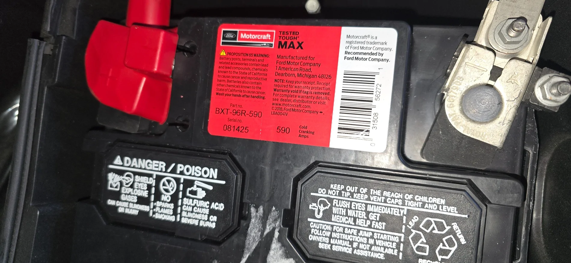

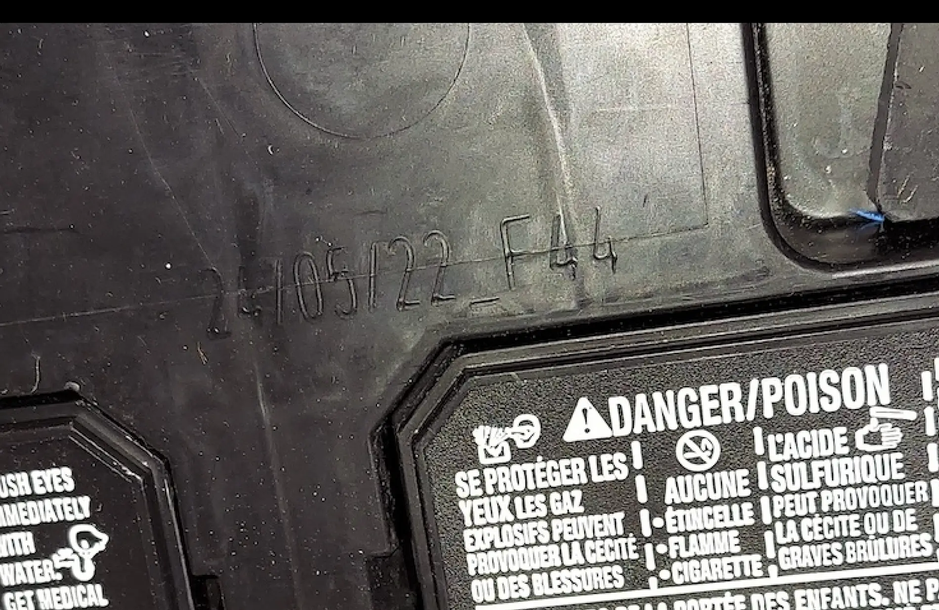

Automotive lead acid batteries will gas off hydrogen, a byproduct of the chemical reactions taking place inside the case. This could be what you're smelling. I'd expect these odors to fade over time, as the battery approaches a fully-charged state.
Batteries sit in stock, sometimes for months, before being placed in a vehicle. On the top of the OEM battery case is a date stamp, the date of manufacture. It's in a DD/MM/YY format.
Dealers and vendors should be keeping their battery stocks fresh. While something several months old is not uncommon, I'd be concerned if receiving a battery whose date of manufacture was approaching a year. You're paying for a product with an expected service life, little of which should be spent while on the shelf.
If you're comfortable with the build date of the battery, I'd continue to monitor but otherwise leave as-is.
- Occasionally take a look at the charging voltage while driving; it should stay at 14.5V almost all the time
- Remove the under hood battery rain cover and inspect the top of the battery. While a light amount of residue from the case caps can occur, excessive amounts can indicate overcharging
- Check the cables for corrosion two to three times a year. While there, ensure the case enclosure is not holding water, which can happen when the drain in the bottom of the enclosure is plugged with debris

Smells like a burning smell. Goes away in like 2 minutes after turning off. Battery is not bubbling or anything looks wrong with it. Would need to get battery out to see that date stamped on it. There is a sticker on it stating 8/25 on it.

That’s likely a serial number as it says above. Many could have been made on that date so must be a unique serial number not a date.

It looks like with new packaging, Ford has changed how it presents the date of manufacture code. From the following examples, Ford now places a MM/YY sticker on the side of the case.
