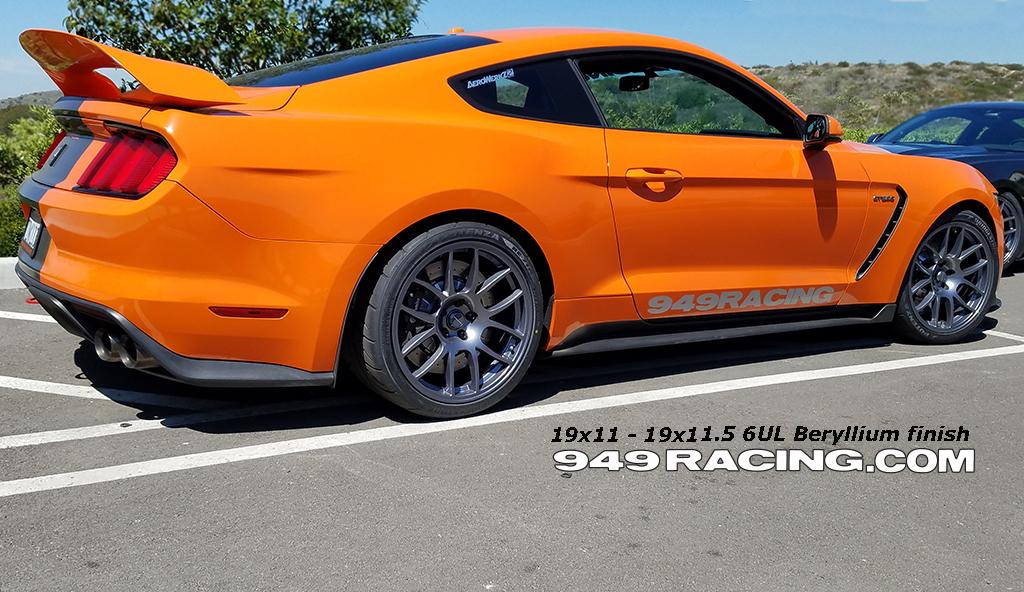

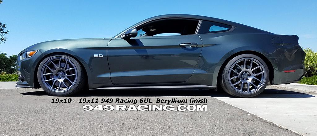

Yup. There is so little room on an S550 (non GT350) that ideal offset varies with alignment, tire choice and method of camber correction if any. If we do a 19x10 +42 or so, that guarantees fitment on full OE style setups with 255's but very few will run that combo. Most want a bit more camber and tire width which requires spacers. We see that a +42 or thereabouts will have almost everyone running a spacer up front. The "poke" in the rear with a 19x10 +37 is exactly the same as a the OEM 350R wheel, which is what most folks are looking for. Flush front and rear while still allowing full bump travel for track use.I just did 19x10 with 35 offset. Worked out perfect. Ran 295/35 squared.
Yup. These fitments don't work on anything else so we're building them at 70.5 specifically for this platform.These will be hub centric correct?

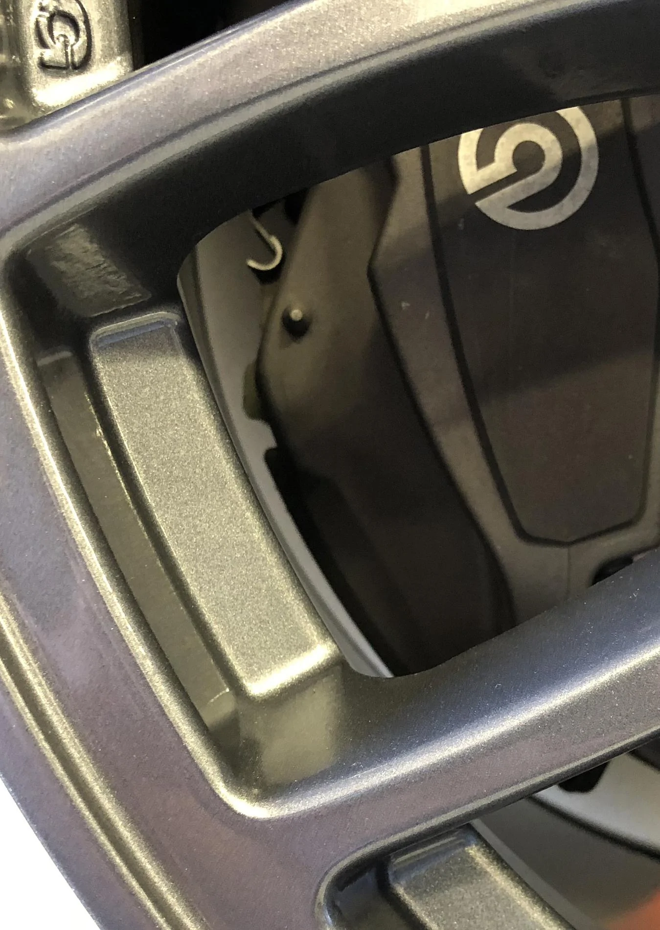

We will go into more detail of our 18's when those are developed next year. This thread is more about the upcoming 19's.All your 18" will clear GT 6 piston Brembos (PP) like APEX EC7?
backs of spokes radiused or sharp edges?
