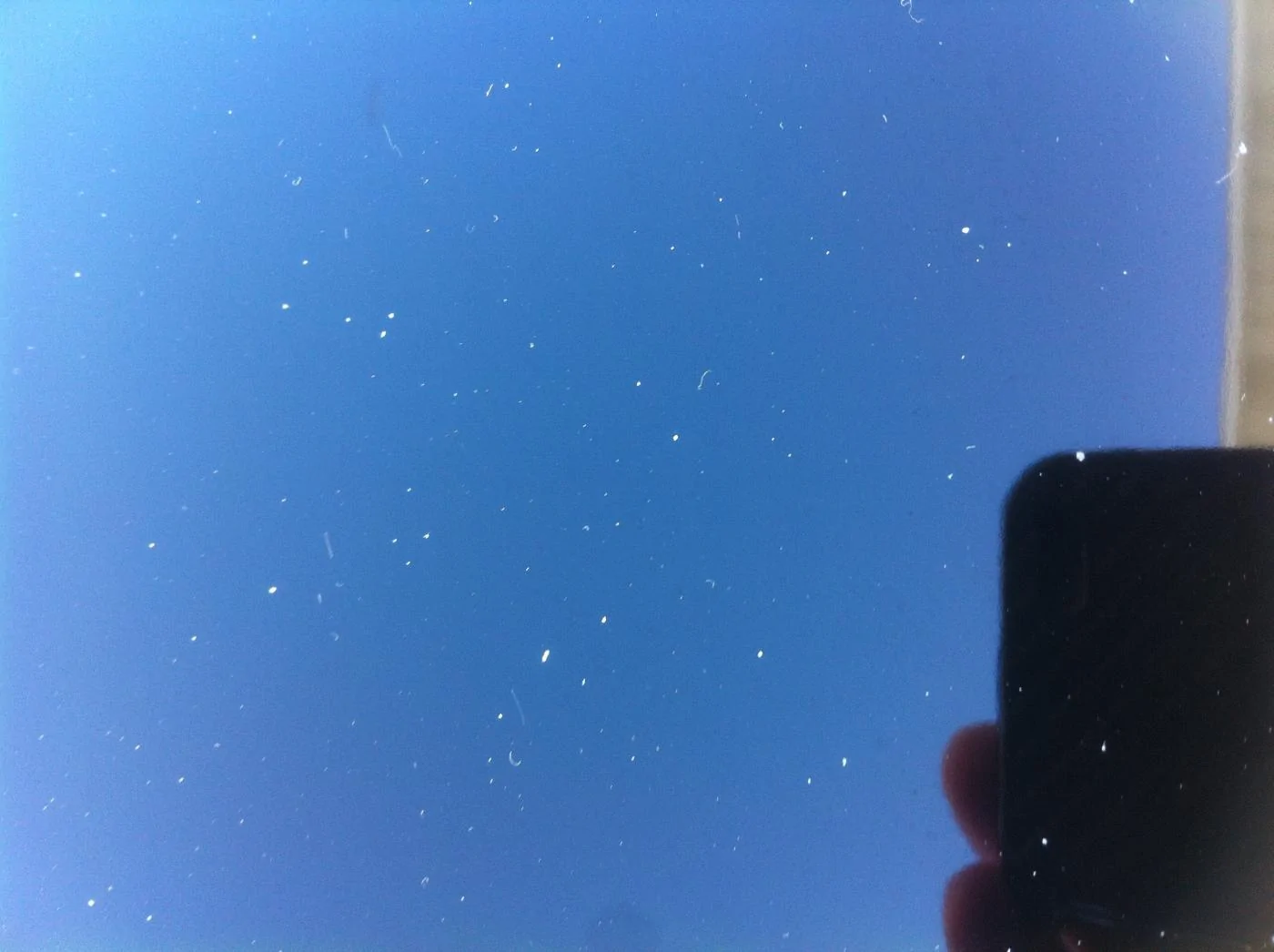

Pretty sure the shady ass tweeker looking neighbors next door did this since both cars in our driveway have it, but mine got the brunt of it being closer to the edge of our driveway towards our house. It looks like white spraypaint was sprayed up into the air and let settle all over my damn car, it's straight up covered in this shit. It comes off easy enough with your fingernail, but the car is so covered in this that individually scraping this off just isn't feasible. Anyone have any tips of stuff to try to remove it?

takes a coward piece of shit to mess with someone's car/personal property smh, btw remove that over spray properly by using clay bar man

At any auto store pick up a clay bar kit. It will come right off. Follow up with a good waxing.

Haha right on, I think I will pick up claybar I've been wanting to just detail the ever-loving hell out of this thing lately anyways. My car has been filthy dirty all week and I just gave it a quick wash an hour ago and noticed the full extent of this stuff on here. I saw those specks here and there a day or two ago and wondered wtf it was, just didn't realize exactly what I was dealing with until today. It's like someone just came up to the driveway and pointed a paint can directly up into the air and let stuff settle. There was just so much dust and dirt all over this thing from where I have to park at work that it just wasn't very noticeable until I washed it for the weekend again.

Clay bar.

Actually, the oils in a creme carnauba wax will also soften and remove over spray. I'd try that before used a clay bar.

Sorry to hear brother. Clay bar it off and maybe find a way to report them or catch in the act of something illegal. I think spray painting outside is illegal isn't it?
