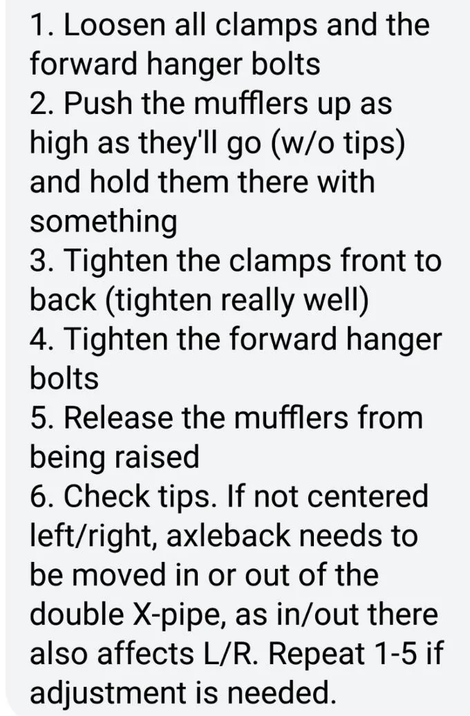

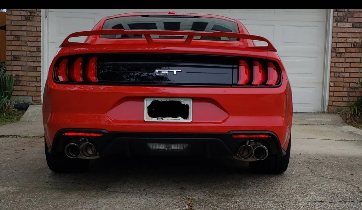

I am having a bit of a problem making the exhaust tips straight. Also when I undo the clamps, I can not get the exhaust or tips out (at the point of the hangers in the middle of the car). Any suggestions or advice is greatly appreciated.

@BmacIL pretty much wrote the book on tip alignment for the Corsa:
My procedure that works every time. Unfortunately one of the faults of corsa's design is their axleback joint point.
