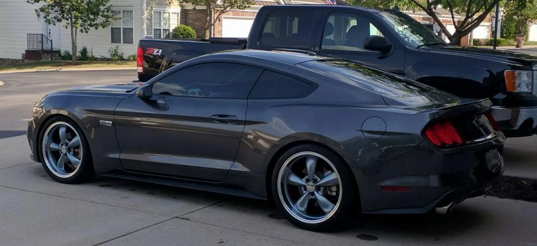

10" is widest you can go easily, and you can run a square 10" wide on the front and rear which is nice for rotating wheels to get the most out of your tires.
American Racing (which has a spotty quality record of late) makes 18x10" and 20x10" Torq Thrust wheels:
http://www.americanracing.com/wheel/4420/ar105m-torq-thrust-m
The 20s will ride a bit harsher due to the weight and short tire sidewalls to keep stock rolling diameter as compared to the 18s, but if you really like the look of 20s, don't let anybody stop you. 18s will usually be a few bucks cheaper for both tires and wheels, and a bit lighter with better ride, but every so slightly less crisp in the handling dept.
Those 18 or 20x10" AM Torq wheels have a +45 offset, and can fit on the front for a square setup just fine with a small slip on 5mm spacer (perfectly safe). Just don't go with anything larger than a 5mm spacer or you won't have enough thread engagement on the lug nuts.

285 is a good width for a 10" wheel.
You only need the 5mm spacers for the front. You can find hubcentric 70.5 center bore 5X114.3 spacer on ebay. Brand won't matter much, they're all just aluminum. You should get enough turns of thread engagement with 5mm spacers. A lot of people here run that type of setup, myself included (and I do a lot of hard track and autox driving). No issues.
The quality issues with the wheels to look out for are overspray on the mounting surfaces, slightly out of round barrels that don't balance right, etc. I haven't seen issues with these specific wheels, but just something to watch out for if you go that route. Make sure whatever vendor you use has good customer service and make sure you know their return or replacement policies in advance.
