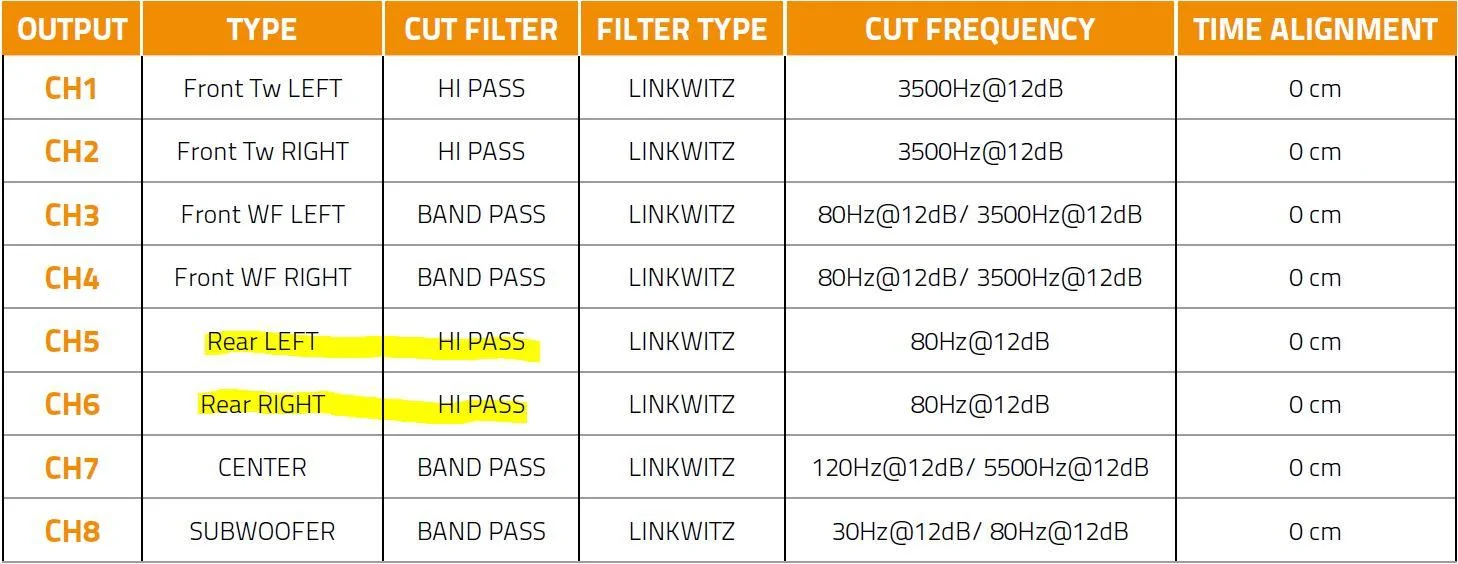

I personally don't think that Hertz is a good candidate for what you want to do.
In the image I have highlighted two sections in yellow. Since you have 6 speakers up front, those two "rear" channels would be re-used for either the mids or the woofers... their cut filter should be band pass and not high pass. Because they are high pass you will not be able to apply a transition between either the mid or woofers and the next higher frequency speaker. In a more flexible DSP, you would be allowed to select both the type of crossover band and it's frequency range.
