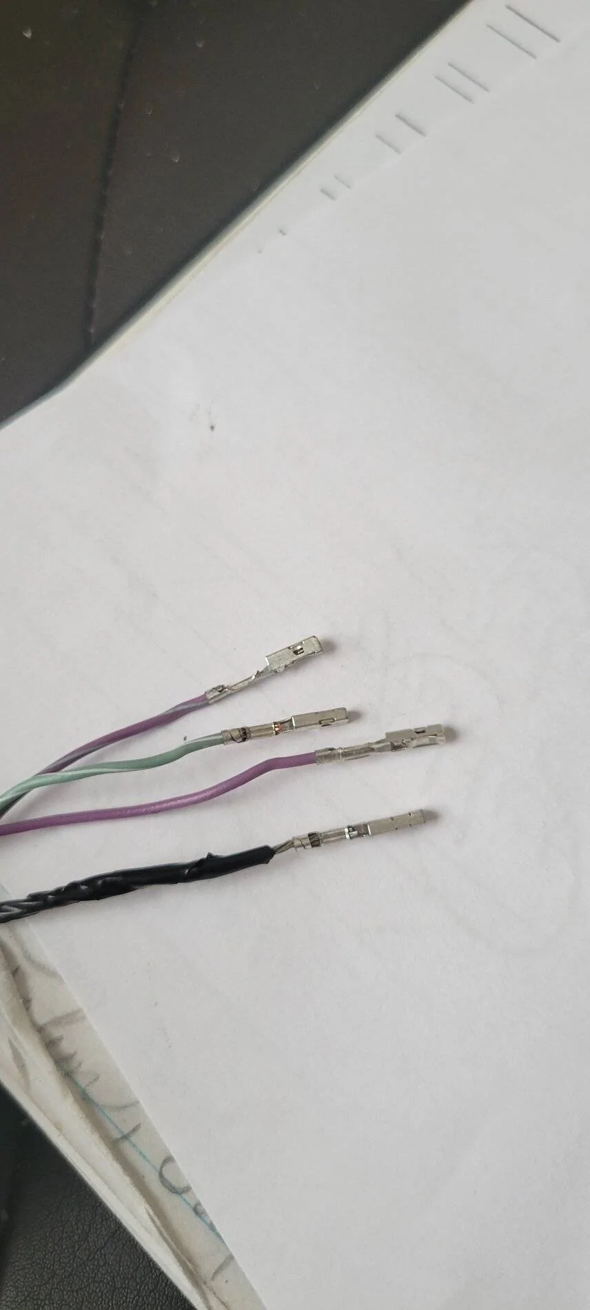

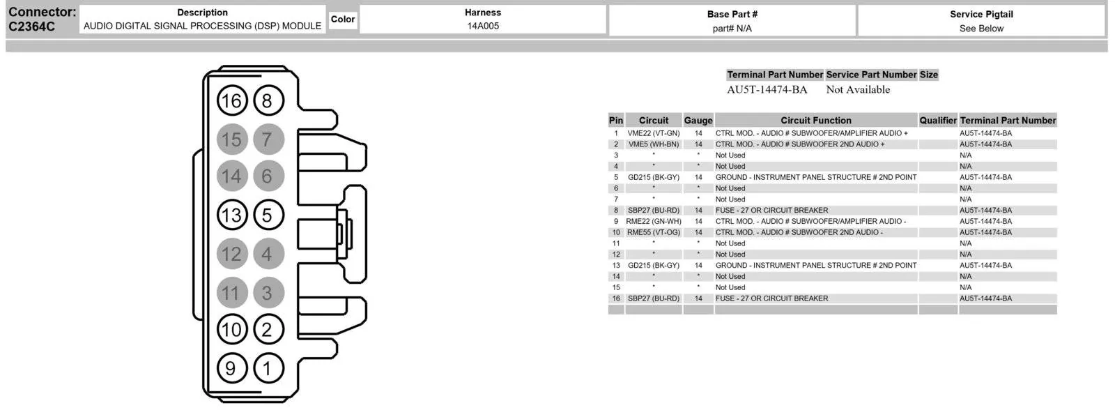

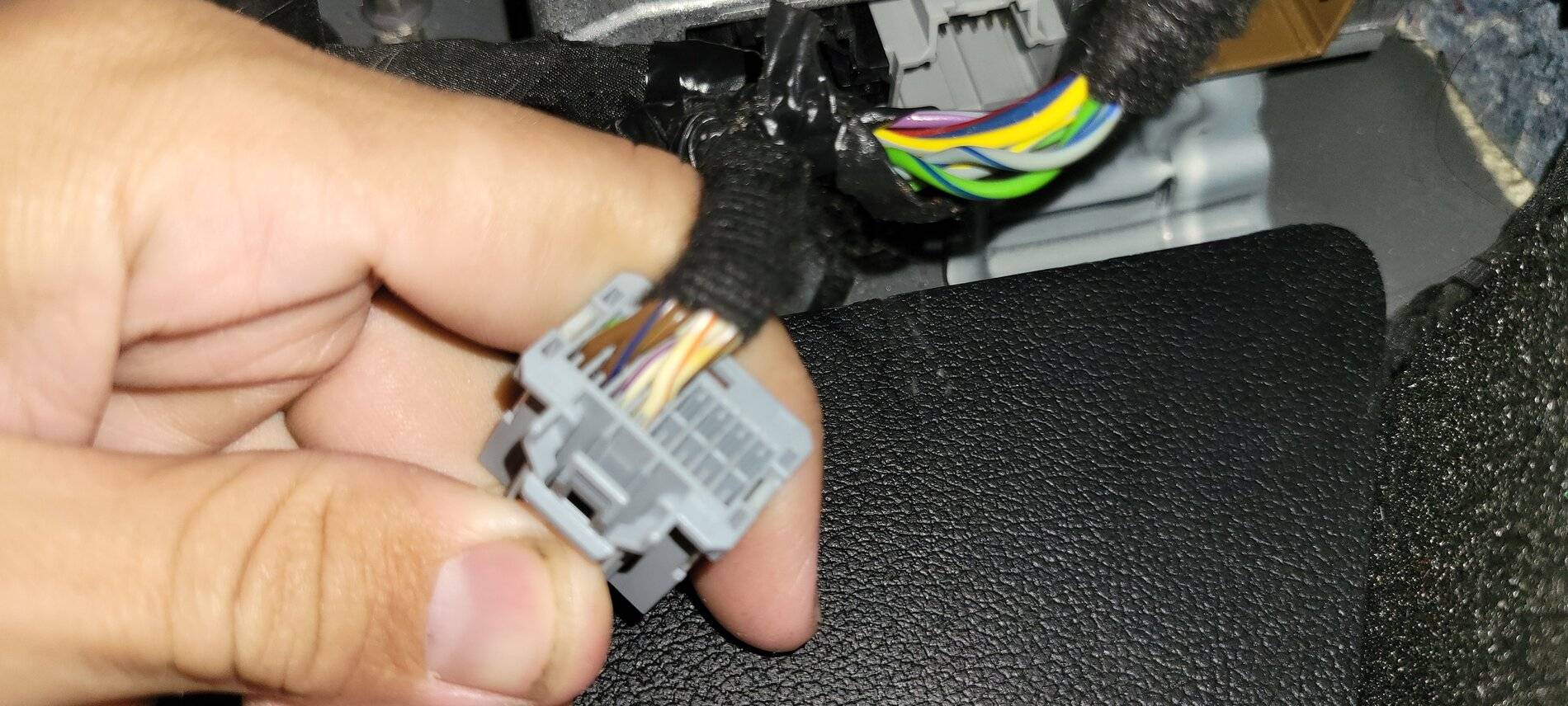

I took a salvage plug to pin the grey amp plug and get sub outputs.
Which pins are needed?
Back Story-
I can't seem to find the info I need.
I had a '16 Mustang w/factory sub, but then got an '18 w/o it bit when I finished with swapping the box, amp, and Lc2i (oh my) it worked....... Mostly.
I trapped into the front door 6.5 speakers at the dsp-amp in driver side to get the best signal but ended up with the ANC fake noise reverb at about 1300 rpm.(no I'm not disconnecting the anc mic bc I can hear the difference).

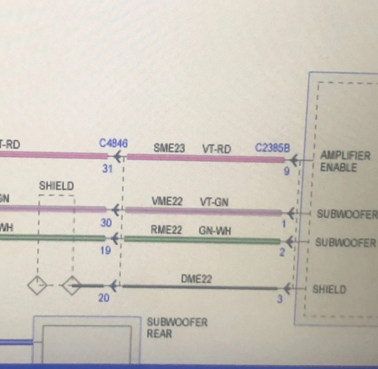

Yada yada yada, After I read the post about swapping to a - "cp"code dsp-amp from a s550 w/factory sub (mine was BT) I got one from ebay, and the Ba1t-18c808 sub amp (salvage yard) Ford uses in '14 MKZ + with wiring harness. Need to have for the Lc2i to work (wanted to fix bass-rolloff).
I already have everything I need(I think) except the sub enable/output pin location to bypass the the Anc for clean signal.
I think I have the correct info, but not 100%.
Any info on which unused pinholes should be great. I'm just gonna add the pins and then put everything together.
