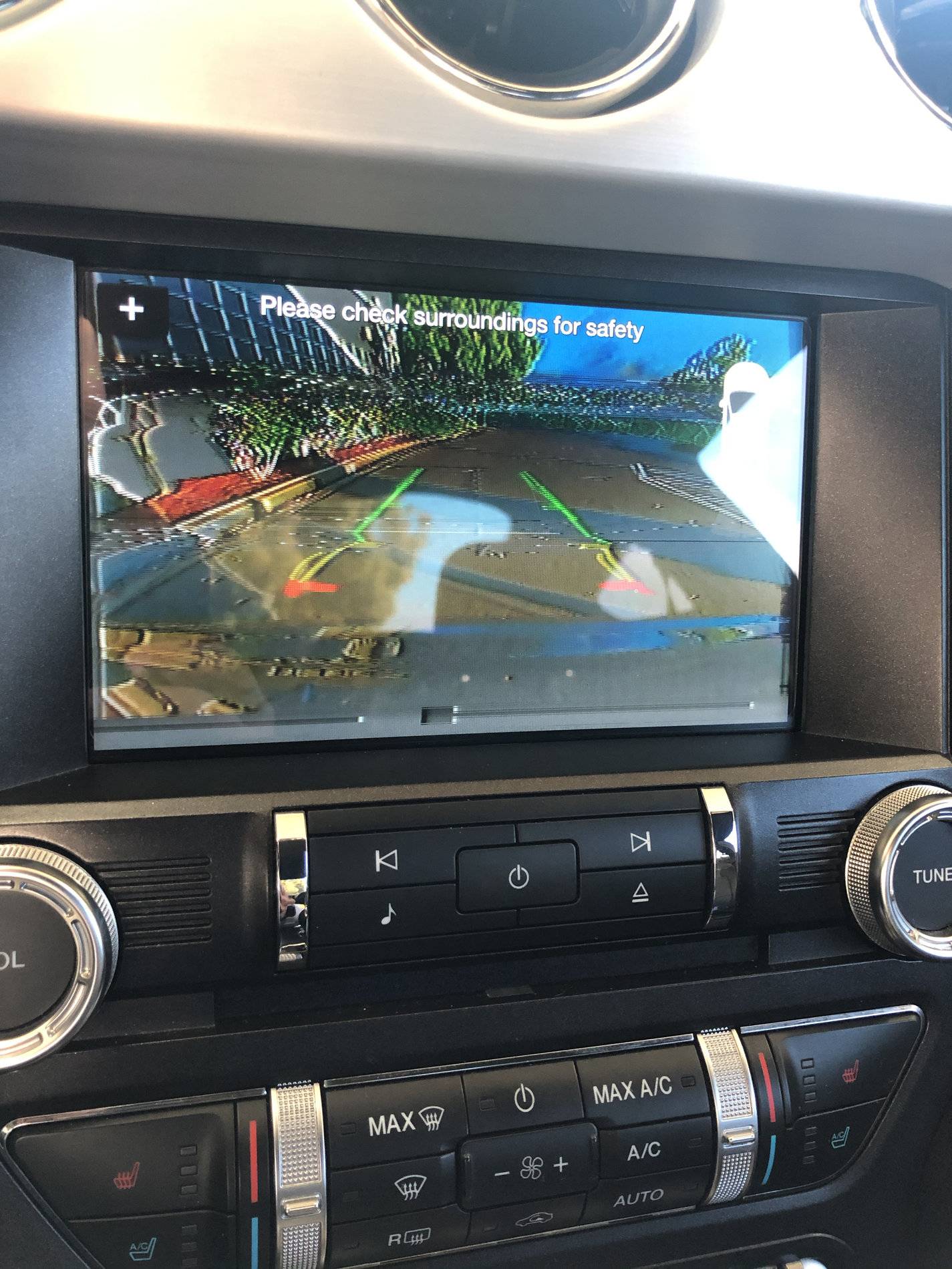

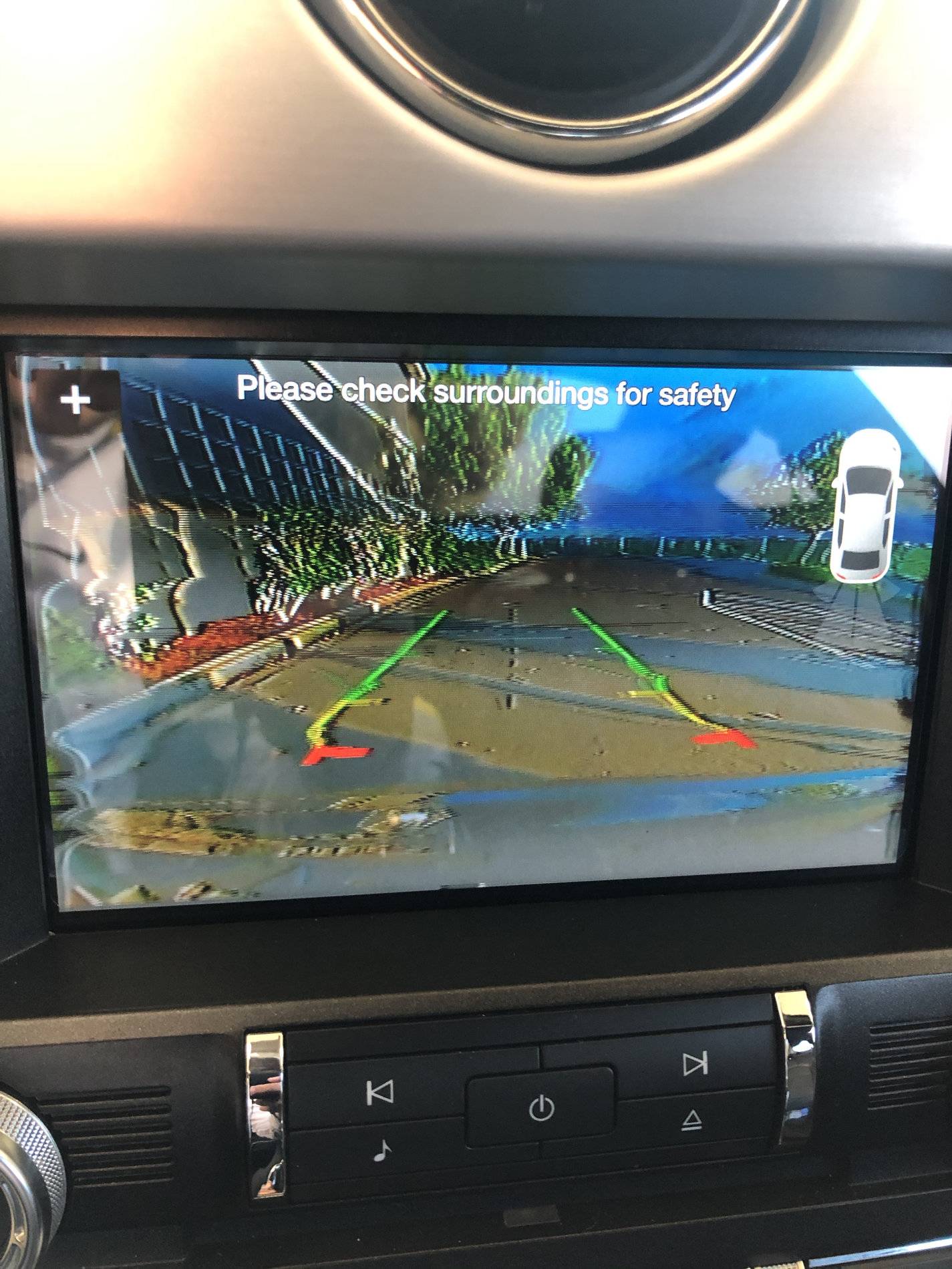

I need some advice and or information with experiences regarding the backup camera on a 2016. I've got the 8'' Sync system if it matters. Every now and then the camera will freak out and display like show in the pictures. Not sure what triggers it but one of two things fixes it. 1. I leave it as is, eventually it fixes and starts displaying correctly. 2. I pop the trunk lid and disconnect the camera and then connect it again.
It's not an urgent need, I know how to park without it, but it bothers me that it can stop working at it's whim, and it looks bad:giggle:
Anyone ever experience anything like this? Is the camera going bad? Should I look at the wiring? I want to say it does this when it's hot outside--if it's 90 degrees today, tomorrow morning it'll freak out. I don't park in direct sunlight and my previous Eco didn't do this so I'm not sure if that's actually a correlation.

Yes, your car had an issue with the wiring harness in the trunk. There was a TSB issued for it. Unwrap the harness and I bet you have a few frayed wires in there.
Edit: https://www.mustang6g.com/forums/th...ear-camera-stop-working-heres-the-fix.117245/

Wow I've been to the dealer a few times for new keys, parts order, and the air bad recall, and warranty work. I can't believe they haven't mentioned this to me at all. I'm going to upload the TSB here just incase anyone comes across the thread. I'll need to see if I can tackle it, wiring isn't my forte, and for only 1.2 hours at the shop I may just bite the bullet on this one. Thank you sir I have no idea, really appreciate it!:clap:
