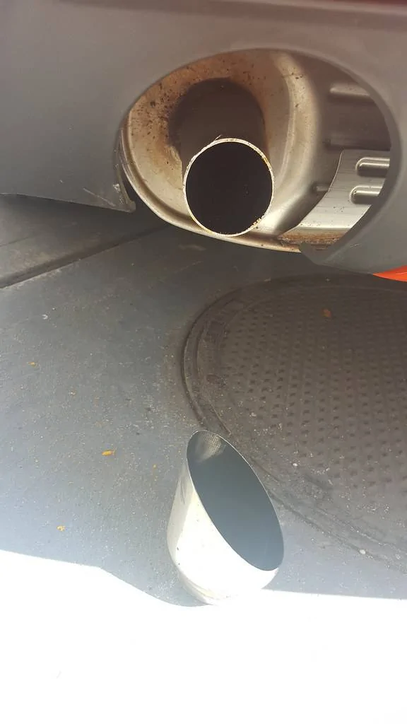

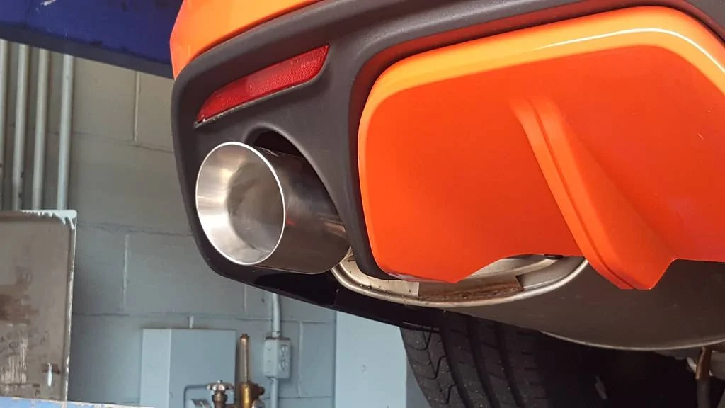

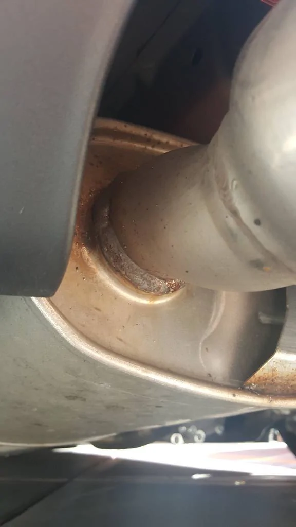

Your factory tips are welded onto the muffler.
Your best friend is a sawzall.
Also, peek under there, the pipe that comes out of the muffler dips down a bit before coming straight.
I did this, and had a muffler shop weld on new tips.
