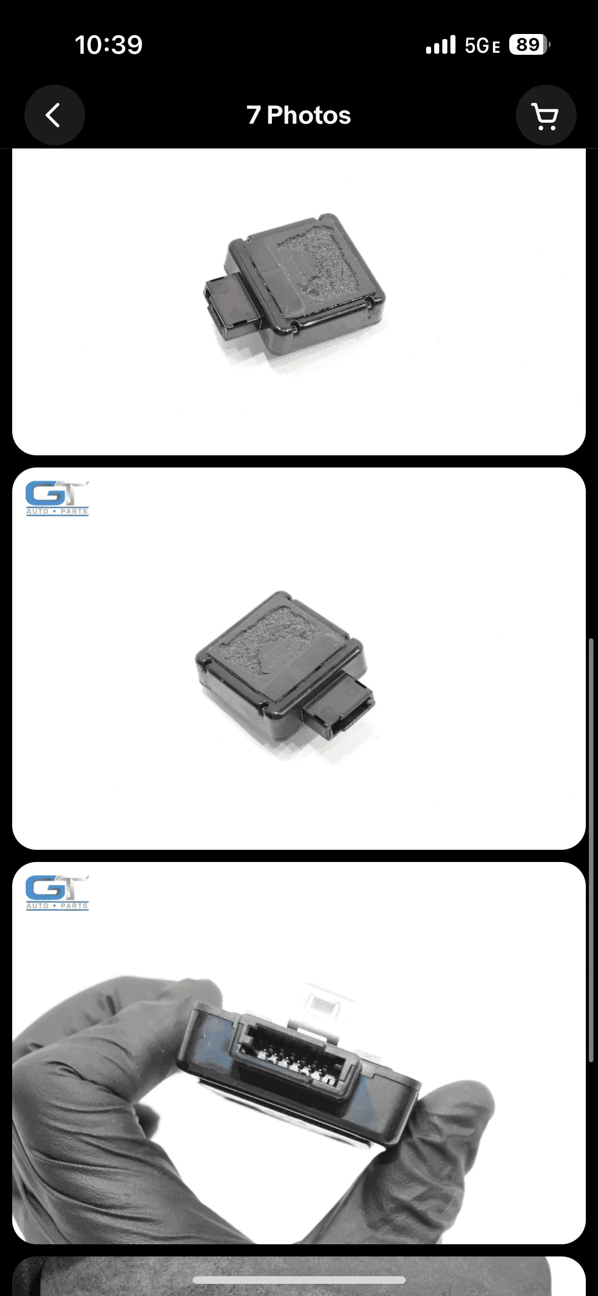

GPS Antenna - Ford (FR3Z-10E893-B)
I believe this is what I will need. I’ll be popping the dash and see if they disconnected this module
