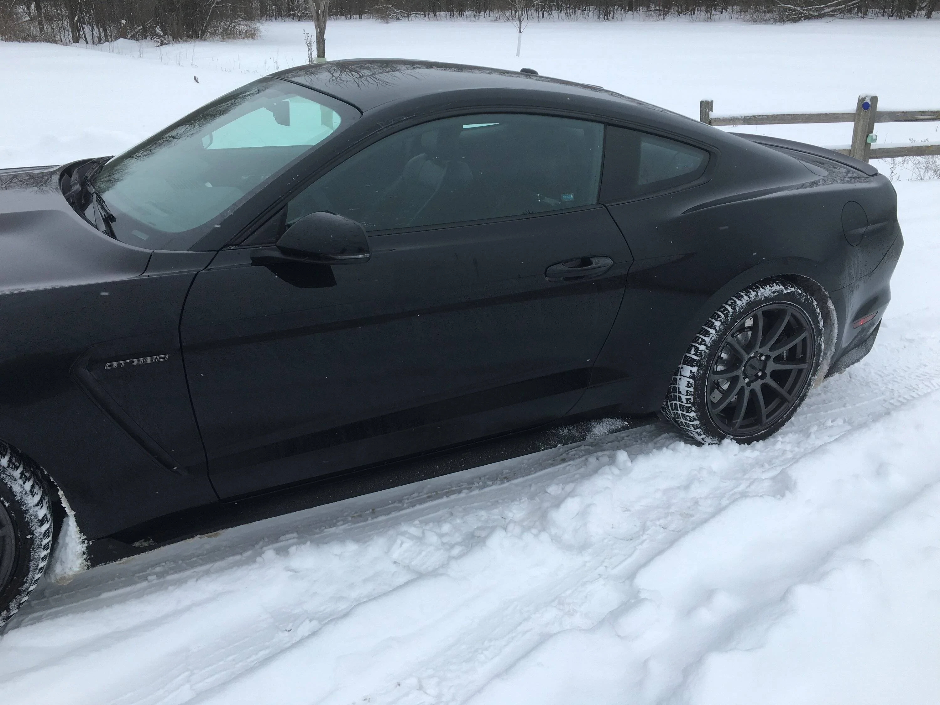

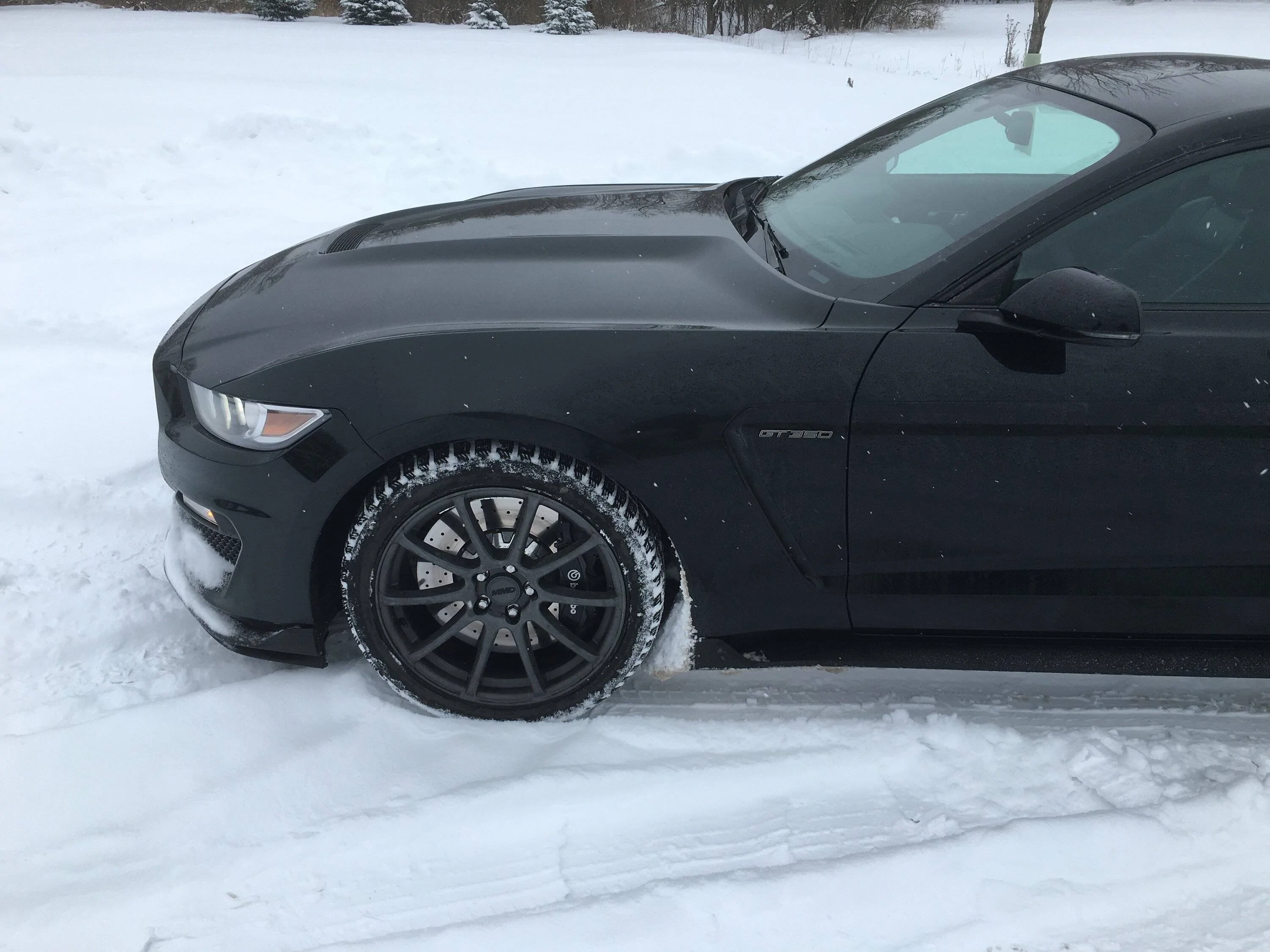

Here are a couple photos. I think the way the offsets on modern wheels are, narrower wheels just don't extend as far under the car. To me they look fine and most rims probably will as long as they are essentially flat on the outside (there's no dish or reverse dish).
The big thing on the GT350 is if you want to run 19s a lot of them won't clear the brakes. These rims did, but unfortunately they stopped making them in the fall of 2016.
