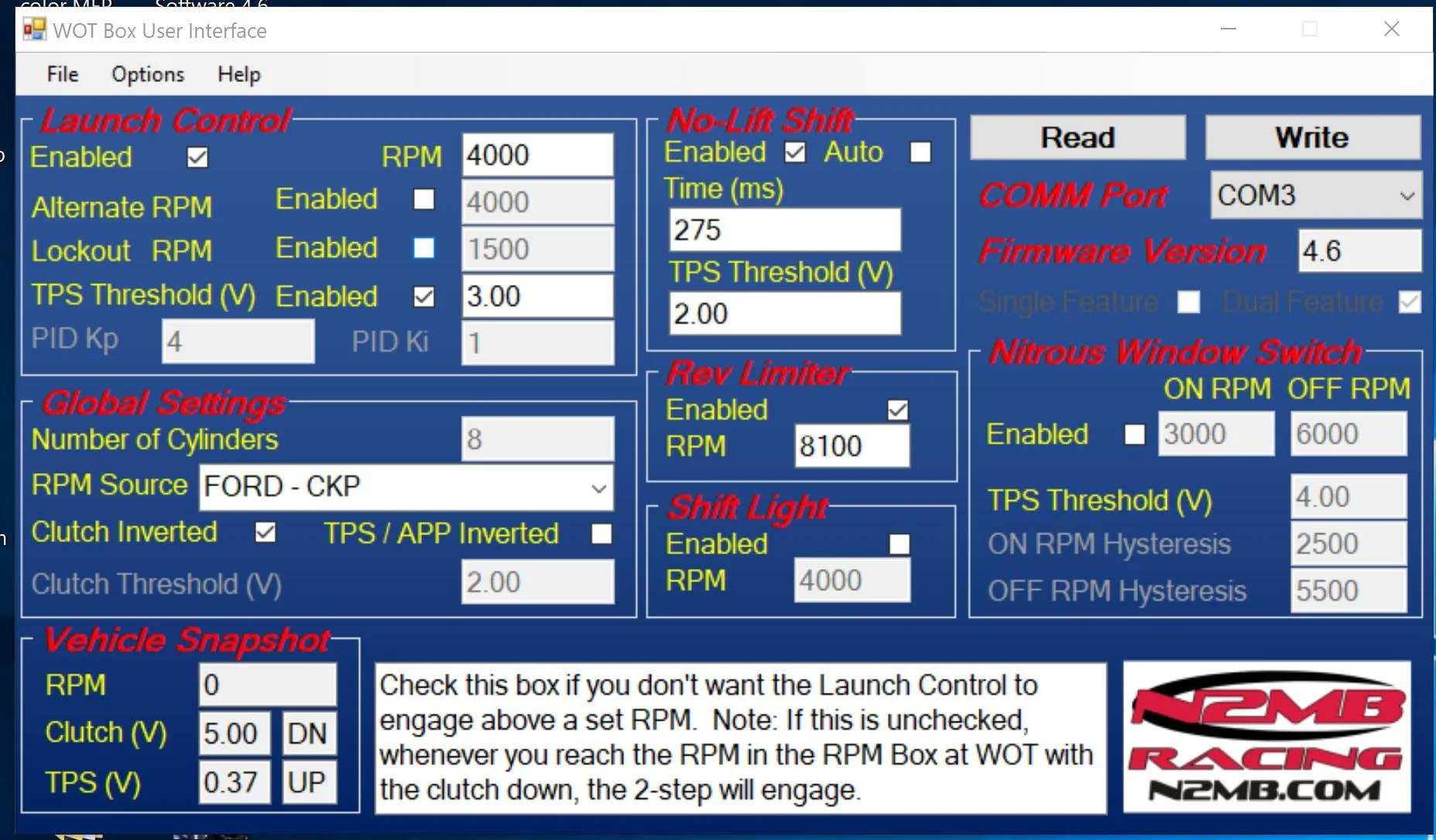

Can anyone tell me there settings for there software?
I am a little confused about the clutch inverted, I read people setting it to inverted just wanted to make sure that was correct.
Does this look correct?
