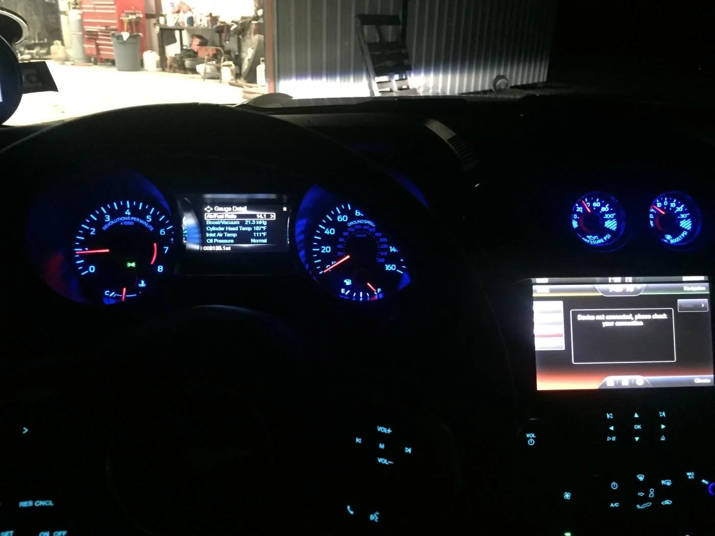

Just installed mine in the performance pack!! Center gauges work too! No other changes very excited!

Any tricky parts? or its just a simple removal like installing a new 8 inch screen?
I noticed you installed a touch screen, is that the tomtop?
No, just use a simple plastic trim tool to remove the trim pieces, and 7 mm socket. I can send you the workshop manual to remove it just pm your cell or email. And the screen was actually a raxiom unit.

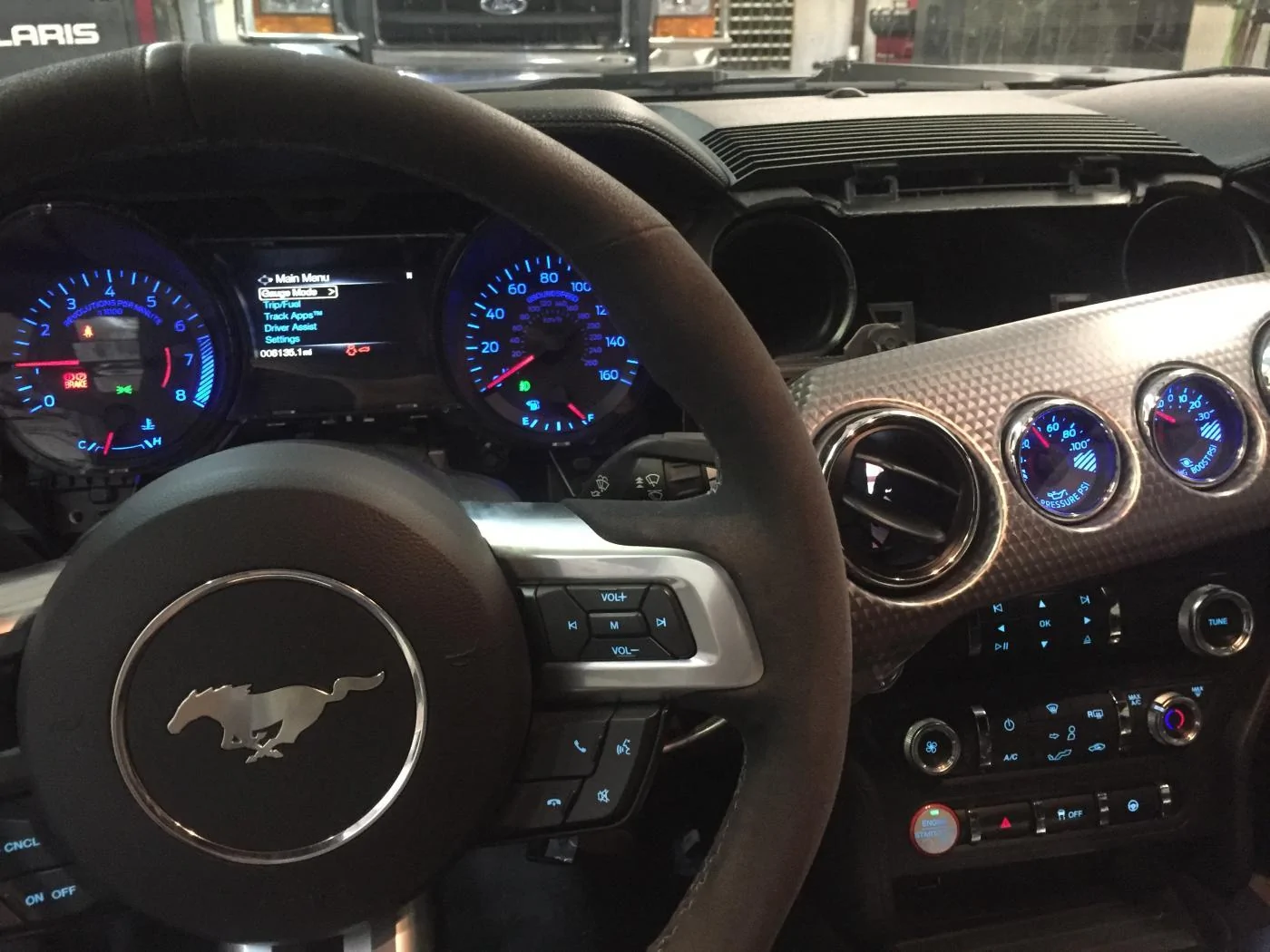

I haven't followed this whole thread. What did you have to buy to get it to work? You have a base interior Mustang? Looks great!
