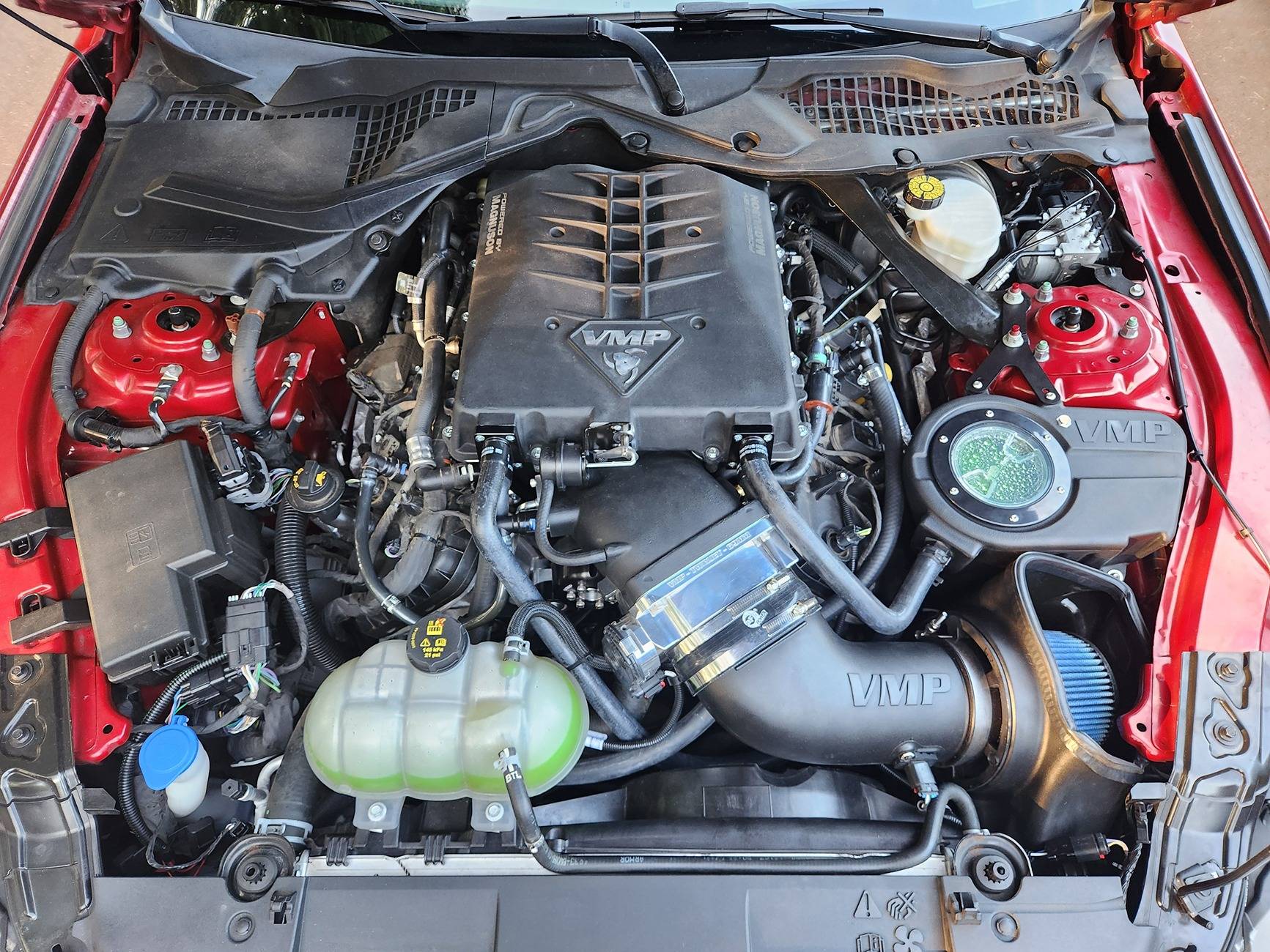

@Twall when you're ready VMP Odin and don't look back. It's been rock solid and it's my daily driver. Just returned from a 500+ mile work trip. I do recommend the underhood Ice tank to avoid cutting the brace.
what brace are you referring to cutting? I dont recall cutting any braces to install my odin kit.
+1 on the odin kit though. I was one of the first to install it and it was pretty awesome and an easy install in my garage.
