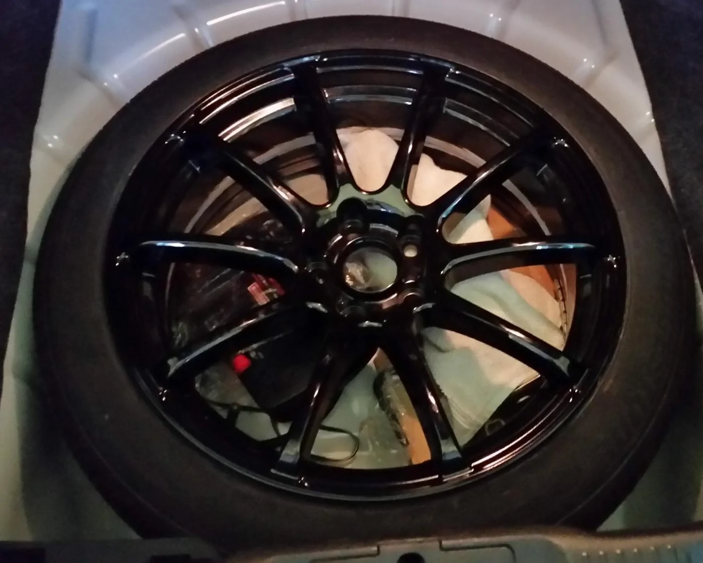

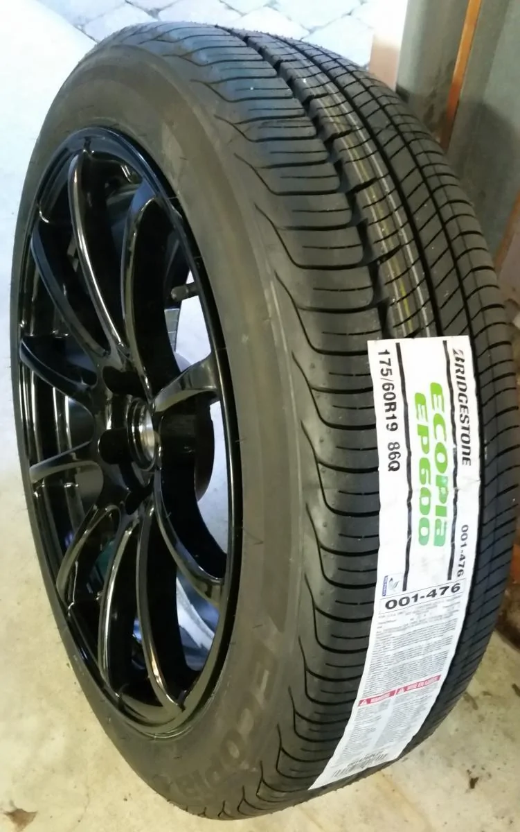

Thx for the idea John (OP)! I did the same for mine except got the black rim...used the same BMW i3 tire pumped up to max pressure for load purposes. I am totally old school...the peace of mind is worth it since this is my DD that i use for road trips too. Mine doesnt fit totally flush (maybe half inch too tall sitting in the well but good enough for my purposes. :headbang:

Not a bad thought, but the cost of a stock front wheel + tire would be WAY more than the cost of buying a ~$164 wheel, getting it cut down, and getting a "doughnut" tire that fits it. The stock wheel won't allow you to have a flat trunk floor either.
