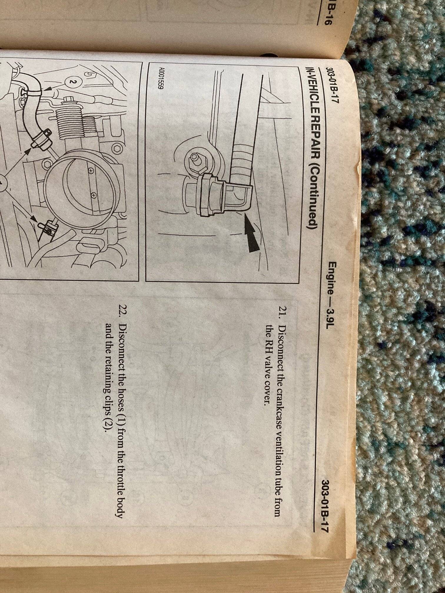

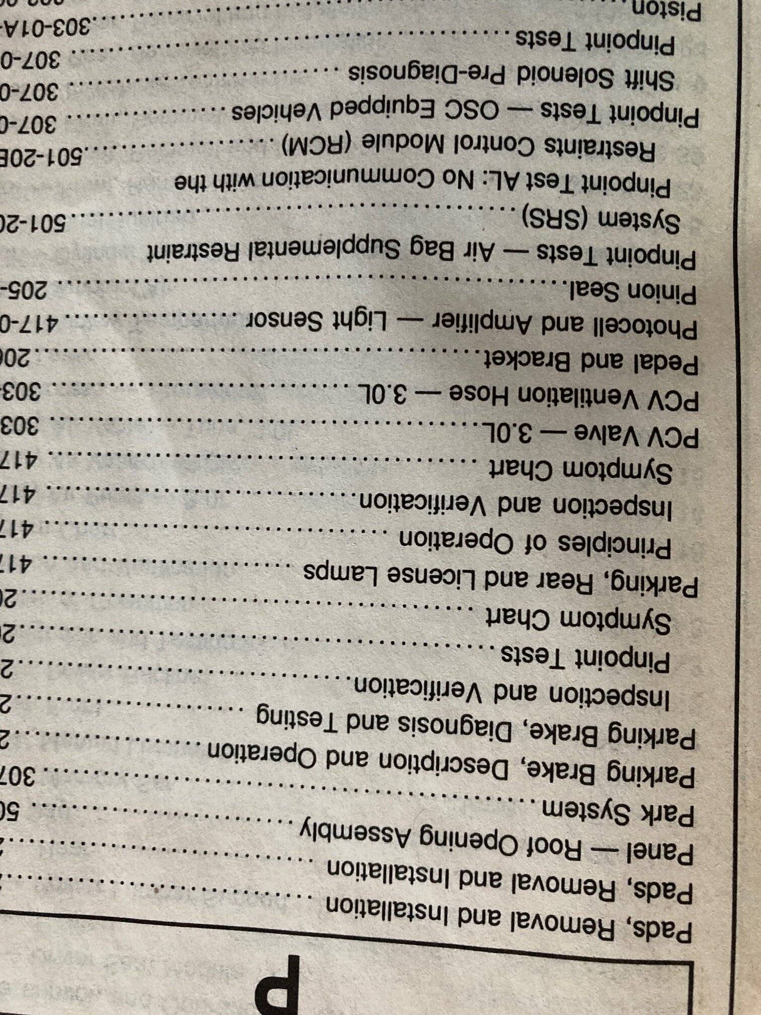

No, it doesn't (had an LS intake system apart lately? I have). The LS came with either a 3.0L V6 or a 3.9L V8, same basic engine is in the Jaguar S-Type:
" The base LS was powered by an all-aluminum 3.0 L DOHC V6 that was a variant of the Jaguar AJ-V6 engine. Optional in the LS was an all-aluminum 3.9 L DOHC V8, a shorter-stroke variant of the Jaguar 4.0 L AJ-26 V8.
https://en.wikipedia.org/wiki/Lincoln_LS
The V6 has a PCV valve, the V8 does not, only employing a tube from the R/H valve cover to the throttle body. It was a surprise to me, after I spent some time looking for one. I've attached photos from the Ford factory shop manual of the instructions for pulling the 'tube,' as that's all it is (note page header), and a shot of the index from the manual showing a valve for the V6 only. I submit the official Ford shop manual--$200 when I bought it--is a better source of information than 'some guy on the internet,' who doesn't seem to know the car had two types of engines, one with a PCV valve and one without (they probably did sell more of the V6s).
"The gunk in your moms LS was probably because it needed maintenance ..."
I said as much, but you couldn't resist, could you? FWIW, I figured I only had a 50/50 chance of getting the car running again anyway, and I had to get it smogged ASAP.
Oh, and, solvent is the more correct term; I should have used it myself.

O.k., so the V8 doesn't have one. But you have 0 proof that caused any build-up in the intake manifold. Could have been a lot of other things. The car's 20+ years old, there's a lot of other issues, I'm sure.
And, again, that's not at all what I was talking about/referencing.

AFAIK, the buildup is caused by crankcase gases ('blowby') that are vented into the manifold through the PCV system (some consider the Lincoln's setup to be a system; though it doesn't have a valve the tube has a calibrated orifice and, supposedly there's a wire mesh to prevent backfire flame from igniting the crankcase gasses). It was a sticky brown coating and, in hindsight I should have cleaned it off, maybe with a half-dozen cans of carb/choke cleaner but I didn't want to disturb the O-ring gaskets (one for each cylinder). If I f'd something up and couldn't get it back together and running good I would've just junked the car. For once, I followed the manual's admonishment to disconnect the battery, but it wouldn't pass smog the first time because that wiped all the ECU's data, which is all that's used for smog tests in CA for 'newer' cars. I had to waste a 100 miles' worth of gas for the ECU to 'relearn.'
I have a '96 Ranger whose gas pedal gets sticky every few years; I attribute that to sticky buildup behind the throttle plate. A (long) shot of carb cleaner takes care of it, but I've worried about the goop migrating to the intake valves. I did get a look at some of the intake valves in the Lincoln, from what I could see they were clean, so PI does make a difference. It's possible I wouldn't have bought my Mustang if it didn't have PI+DI; I've heard a lot of horror stories about DI-only cars needing cleaning--walnut blasting--of their intake manifolds every 50K miles or so. I put a catch can on my Bullitt; I usually remove it for the free dealer oil changes but recently I forgot, and the dealer didn't say anything.
Edit: It's a bit ironic, IMO, that the best way to prevent intake system gunk buildup would be to mount a big, honkin' Holley 4-barrel on top of it.
