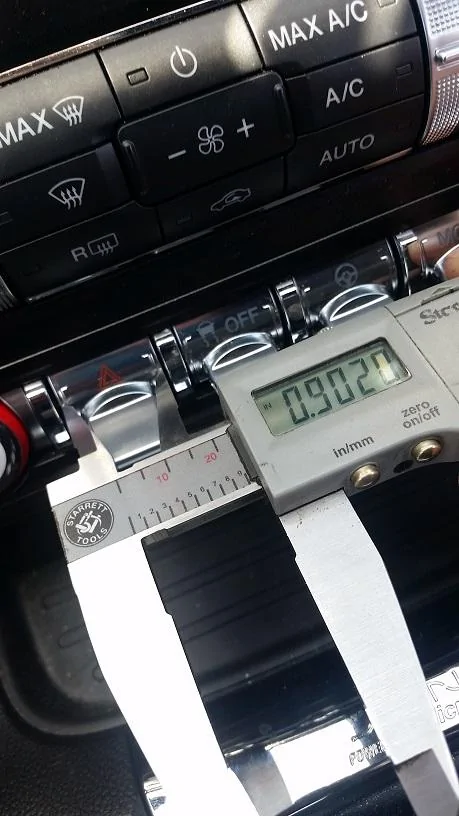

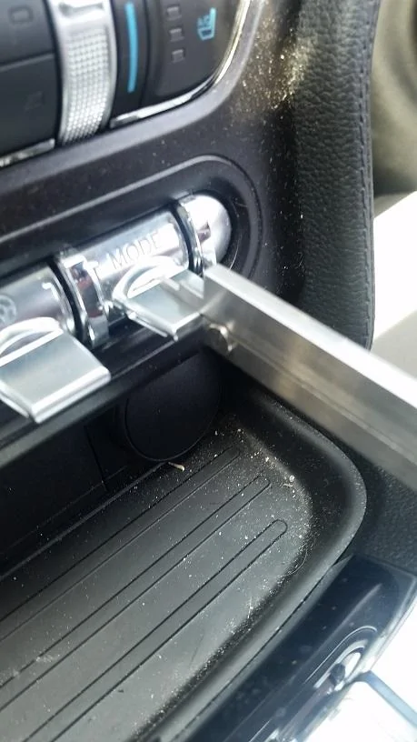

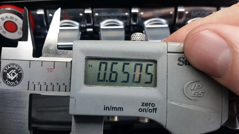

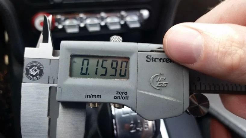

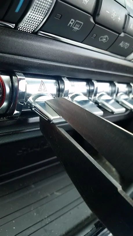

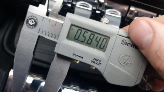

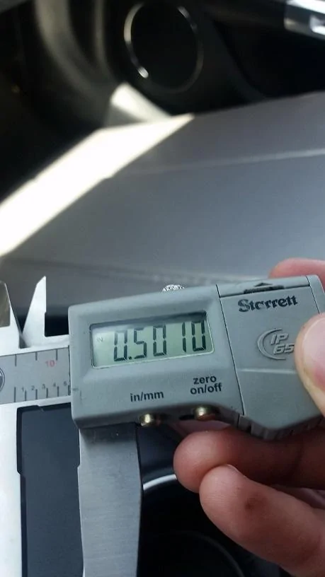

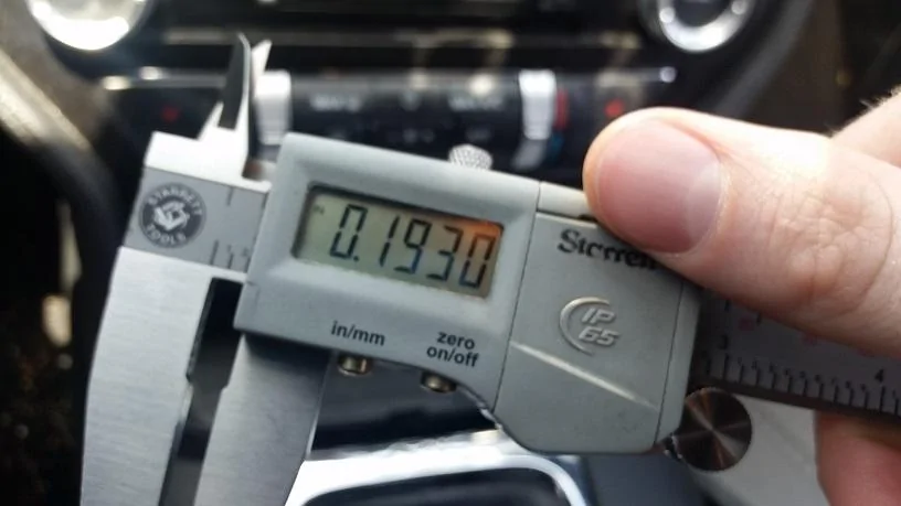

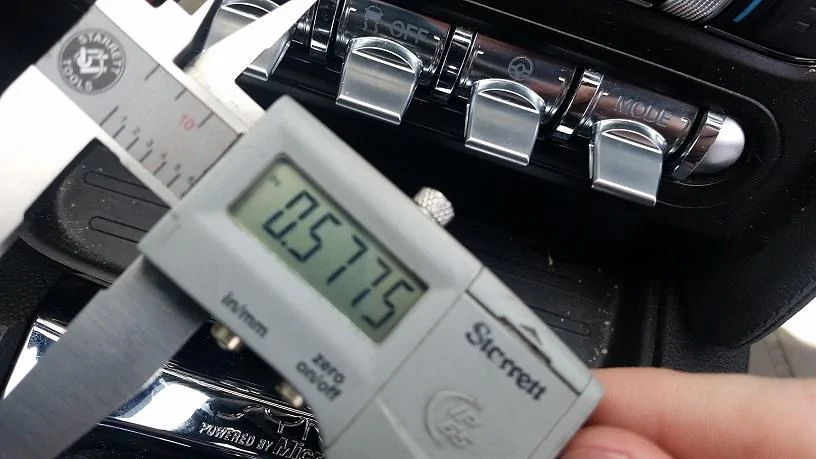

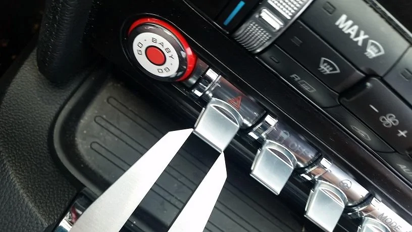

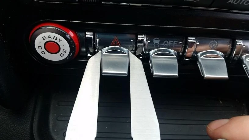

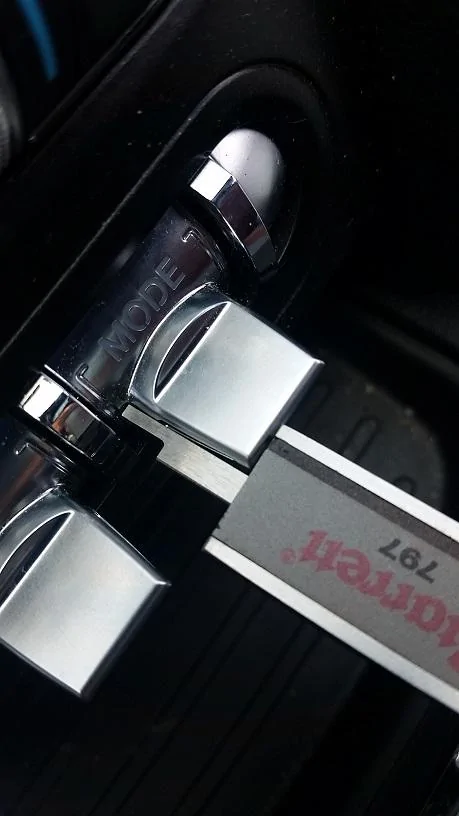

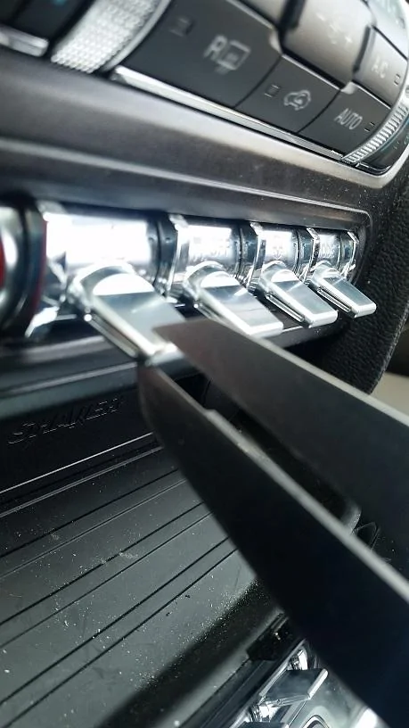

Hey OP, MurderPony requested I take some measurements of the oem toggles. I didn't realize you guys didn't have anyone willing to, otherwise I wouldn't done it sooner! I love this thread, and I love people using cutting edge tech to entrepreneur a solution before the aftermarket!
Pic overload:
Hope that helps you cats!

Thanks!! That helps out greatly! So my toggles are a-little longer then the OEM ones and a-little thinner in thickness. I have been thinking of shortening mine so I might end up doing that for the production units.
OySmallFry,
Could you comment on the feel of the OEM toggles? Is there any play in them or are they pretty solid? What I mean by that is can you grab the toggle and wiggle it at all? Trying to see how mine compare to the OEM units.

Yeah, I checked that when I remembered your discussion on your first round of prototype toggles. There is some play, but its a very tight feeling. Obviously pushing the toggle up is resisted by a spring, so nothing there. You can slightly wiggle left and right. Actually the silver spacer bars in between each toggle have more left-right play than the toggles themselves. All in all, its a pretty "heavy" solid feel, if that makes any sense.

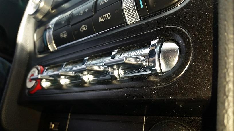

Zack they feel pretty solid/heavy in the premiums. You could always just go to the dealer near you and take a peak inside at the ones they have in the showroom. When I took pics last fall I took a close up..they definitely feel like aluminum.
http://postimg.org/image/3t4cakk8z/

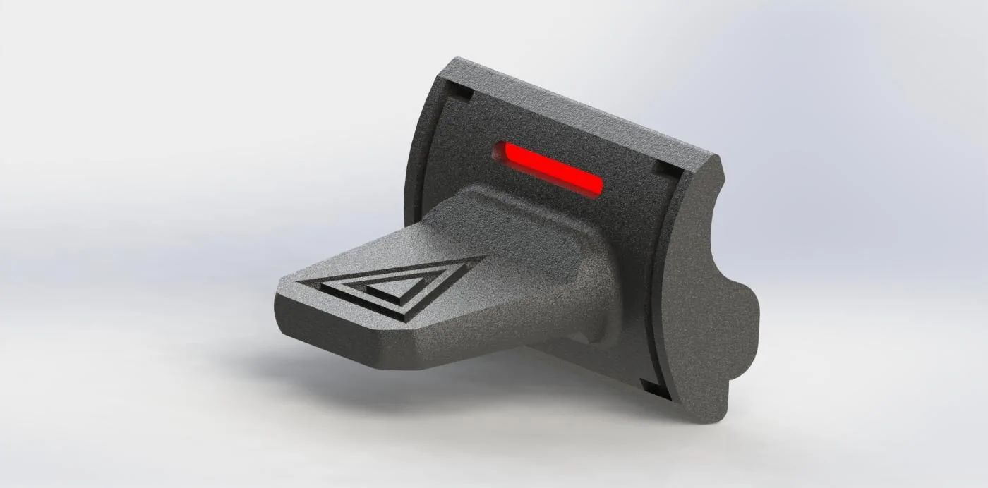

So I have a question for you guys... I am not completely sold on the text. I think the printing process just isn't precise enough to get the text right. We will see what the next round looks like but I don't know... Because of this I created this concept. What do you guys think? The symbols will be the main description for the button. At night you will have a bar light up to show toggle location. 1 bar red will be hazard, 2 bars blue will be traction control, and 3 bars blue will be steering mode. The main red bar in this picture would be split in the center for 2 and split into 3 for steering mode.
I am thinking of this concept or just leaving it one bar for all three toggles. This would obviously be a bit cleaner but you would not be able to tell the traction control apart from steering at night.
I would prefer this over the text. As you state the text needs a higher resolution print to work best.
Another option would be to have a rectangular cutout and a label reverse printed on plastic which clips in.
Keep up the good work!

No script looks better.
