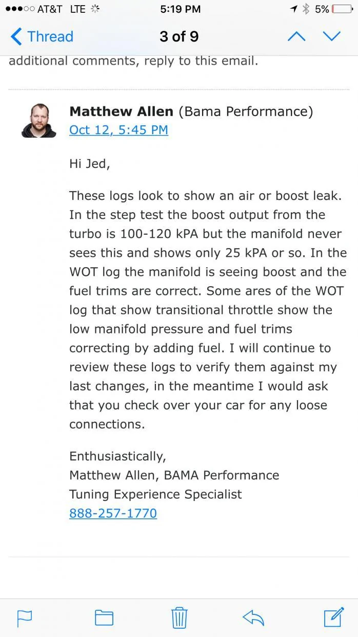

Again I had great response with Bama they followed up with phone calls all the time, I got my tunes same day, they were specific when they diagnosed my leak, told me exactly. I have attached proof of the email and fact how amazing they were. Look at next post

Bama
Bama awesome!

Matt is great like I said I posted his email about my leak, couldn't ask for better communication
