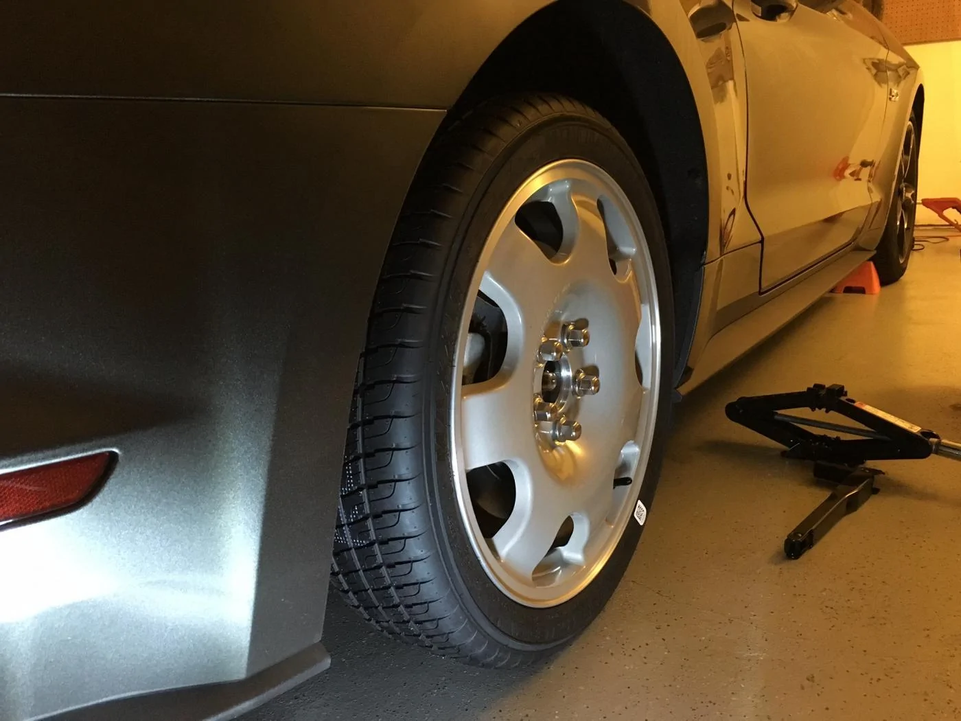

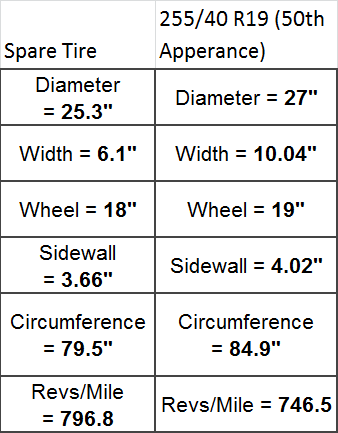

Ran a tire size calculator, and here are the specs. The spare in the Mustang is slightly lower diameter (the PP, 50th and 18" wheels are very close in terms of overall diameter). Not sure if a wider diameter would fit in the well, but the current spare is a pretty tight fit from what I remember.
