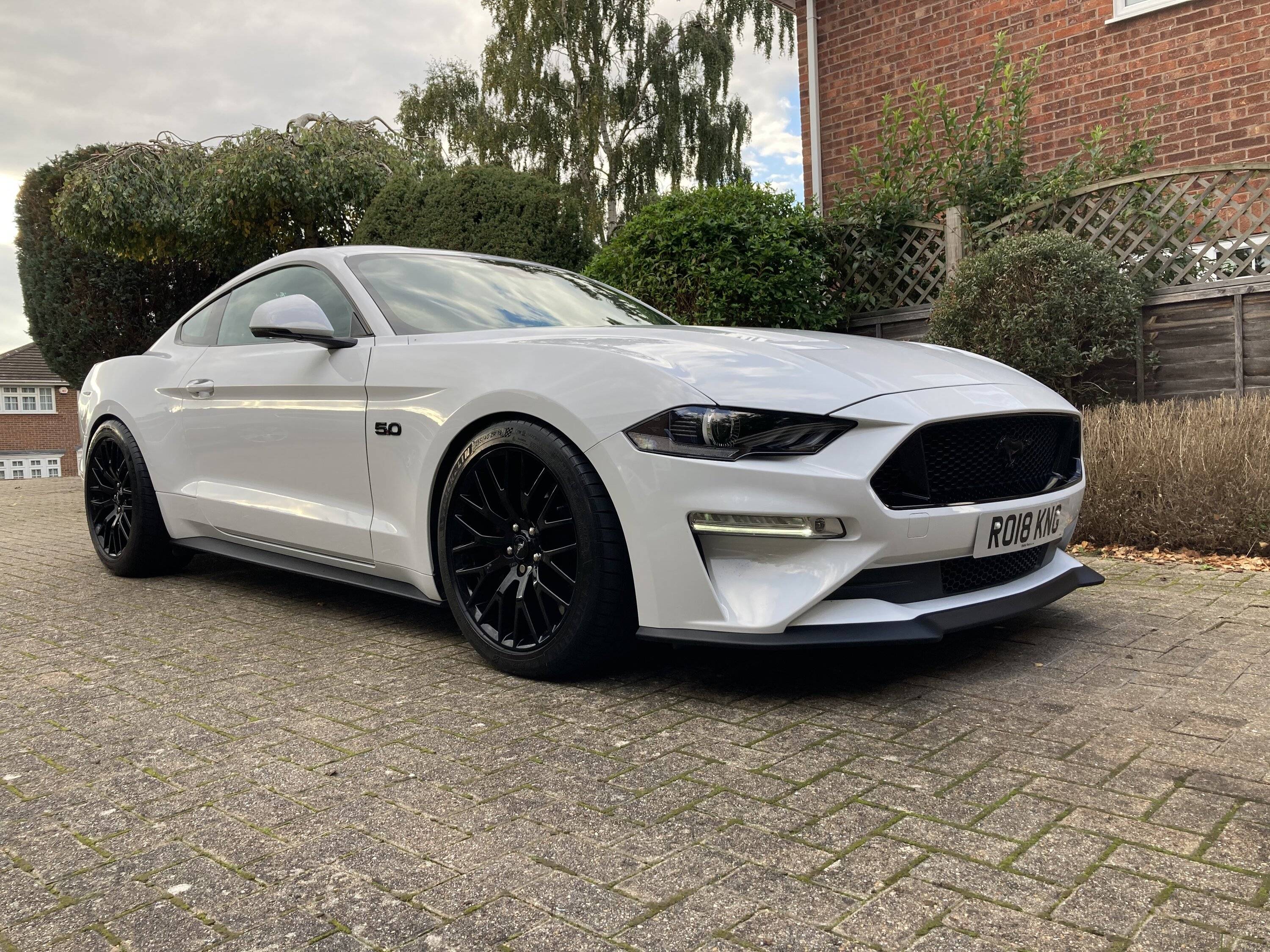

I am replacing my GT PP wheels with MRR 350 19 inch wheels
PP I think are 9.5 inch wide MRR are 10 and 11
I have 23mm and 25mm spacers
Can any one help me with what spacers I will need to fill arches
as they are now
Also recommend tyre sizes
By the way I’m lowered on Pedders
thanks Pete U.K.

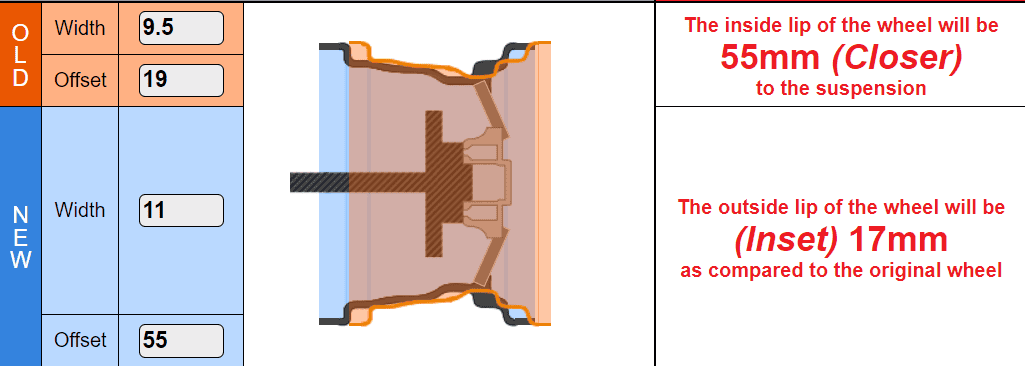

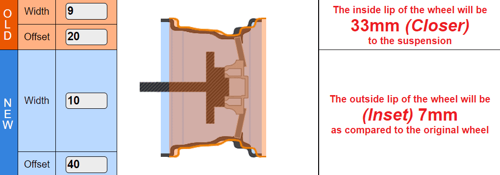

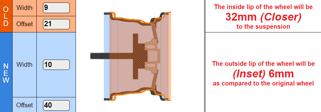

Factory PP wheels are 19x9 ET+44 (front) and 19x9.5 ET+44 (rear). With your spacers factored in, this effectively changes the fronts to 19x9 ET+21 and the rears to 19x9.5 ET+19
The MRR 350 in 19x10 ET+40 would give you an inset of 6mm compared to what you're running now on the front. The 19x11 ET+55 would give you an inset of 17mm compared to what you're running now on the rear.
Here's a visual, orange is what you're running now with spacers, blue is the MRR 350.
-FRONT-
-REAR-
-FRONT-
-REAR-

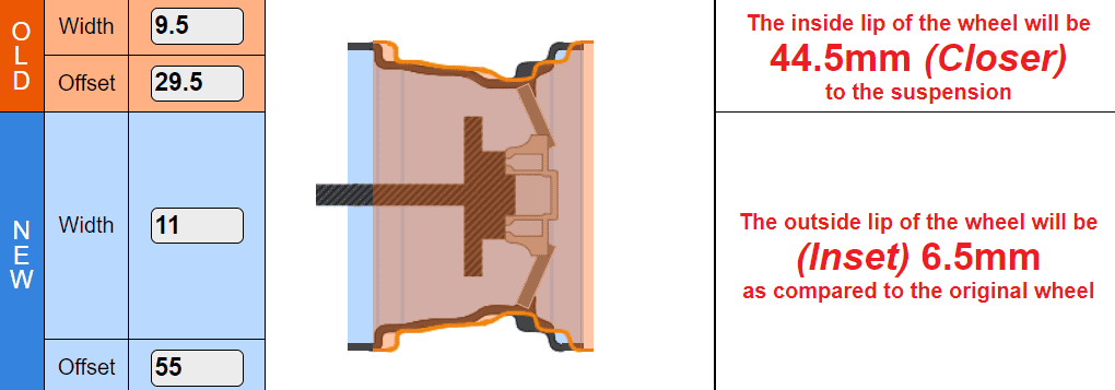

My apologies for the confusion.
Your front wheels with spacers would effectively be 19x9 ET+20 and the rears 19x9.5 ET+29.5
Here's how that compares against the new set of wheels - 7mm and 6.5mm would put you at the same stance.
