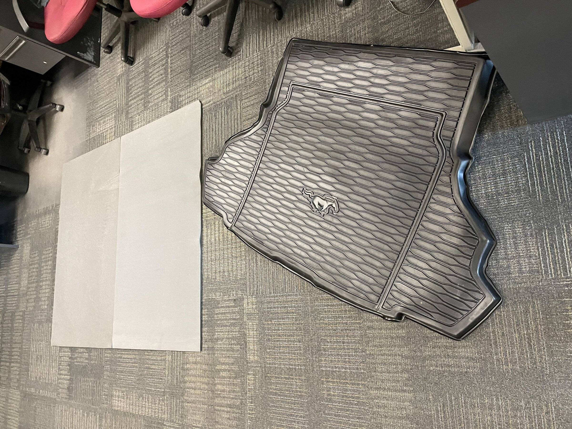

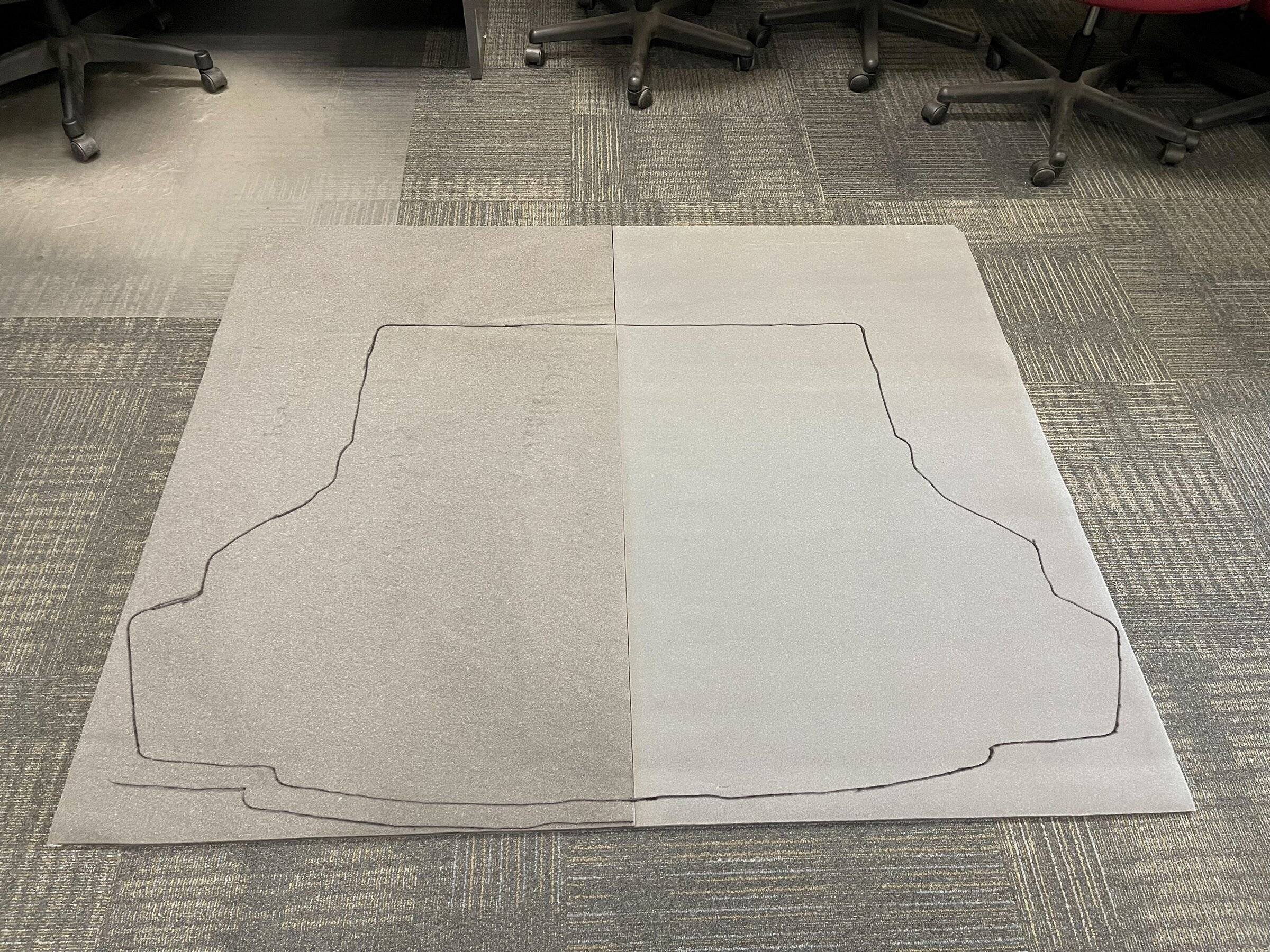

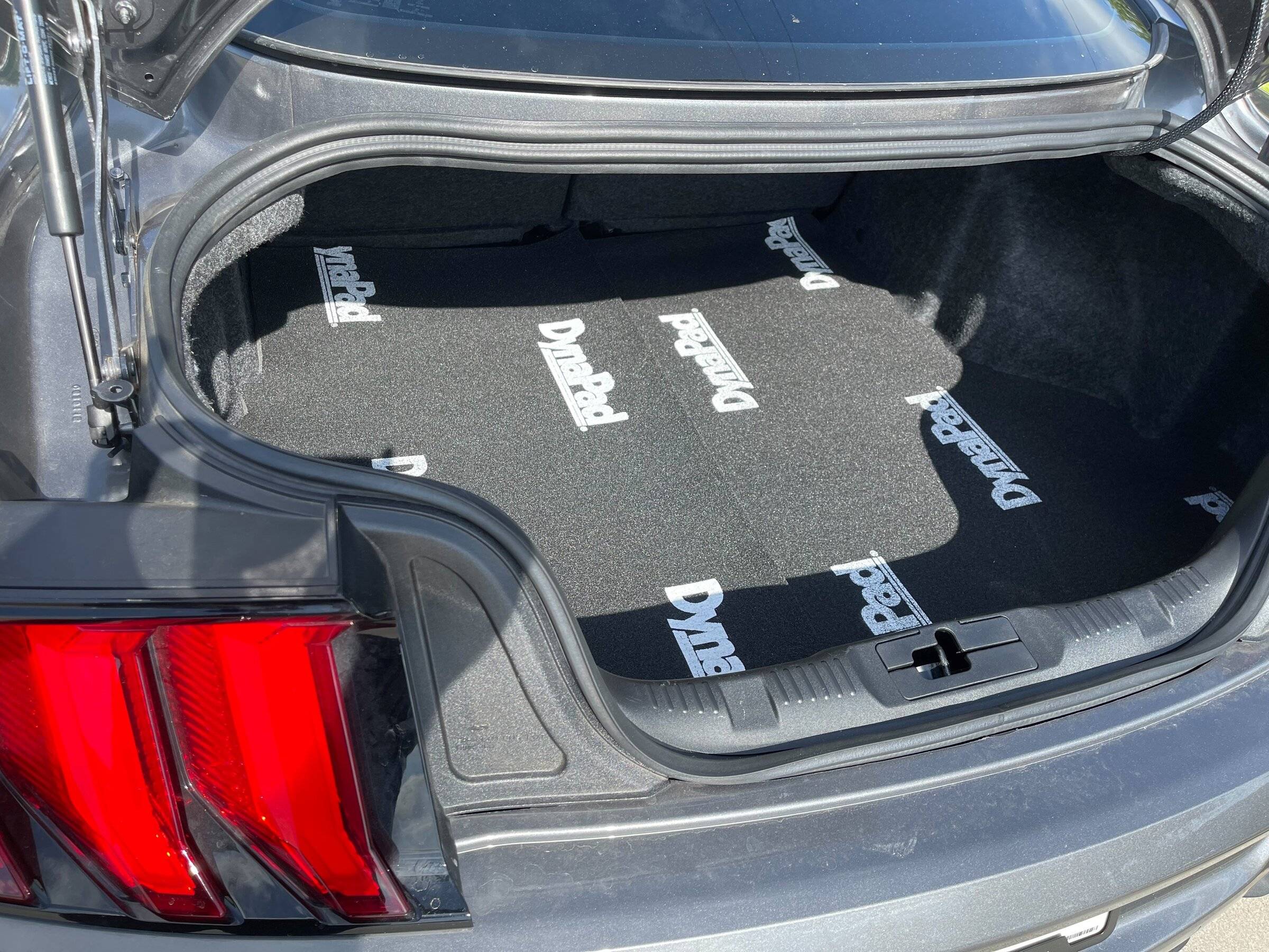

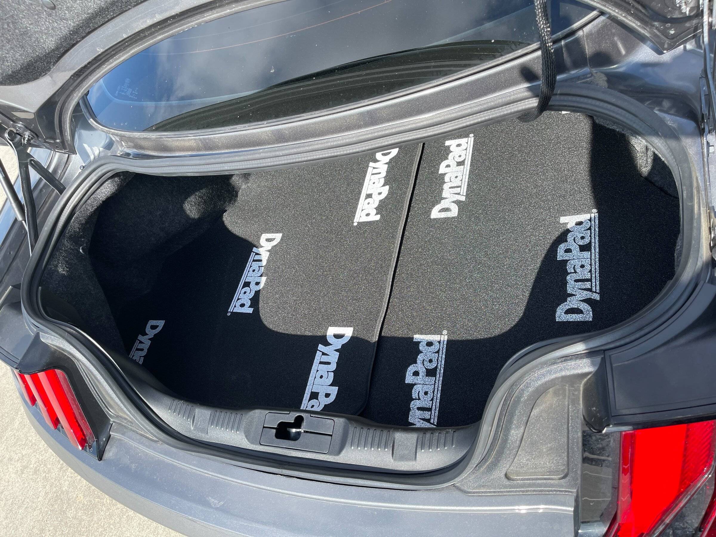

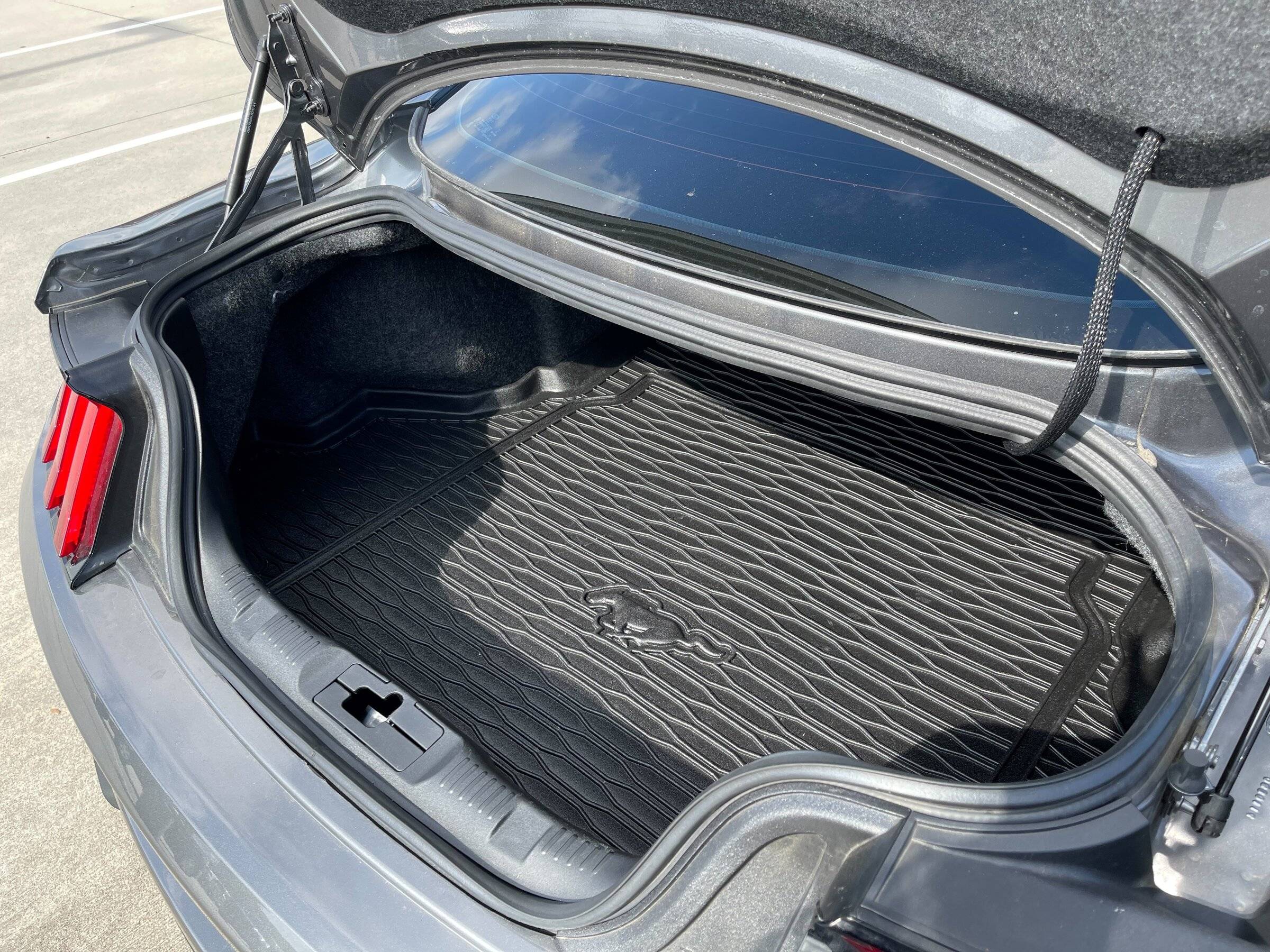

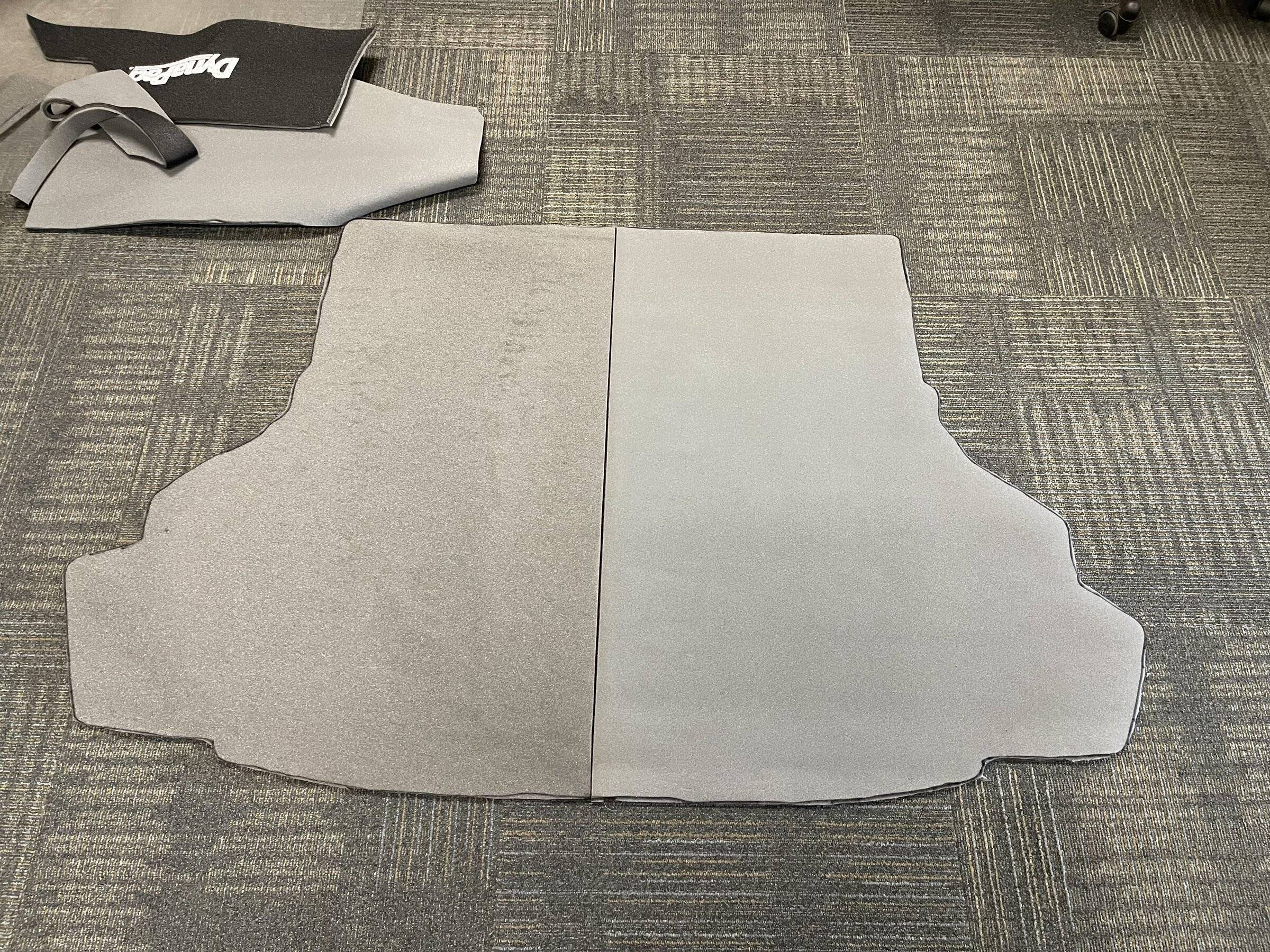

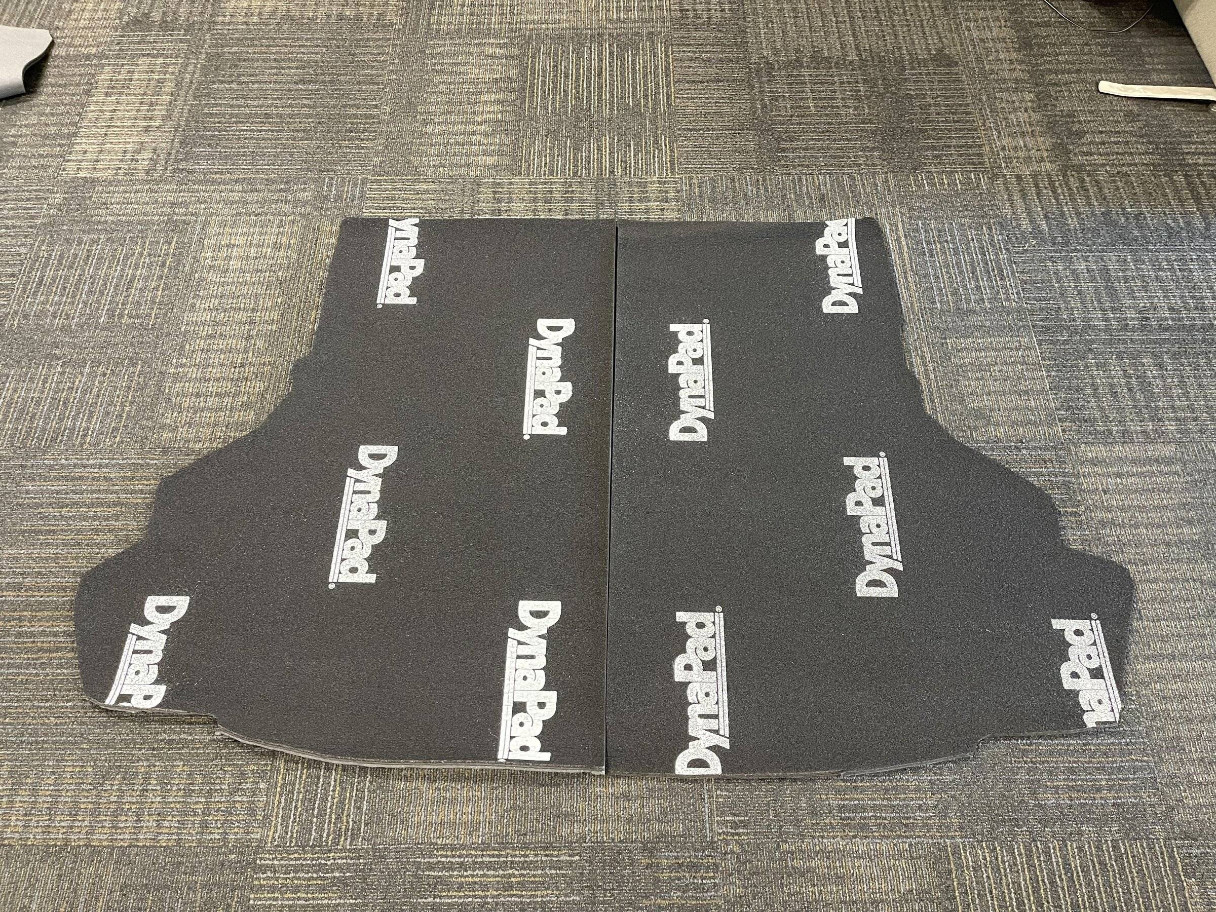

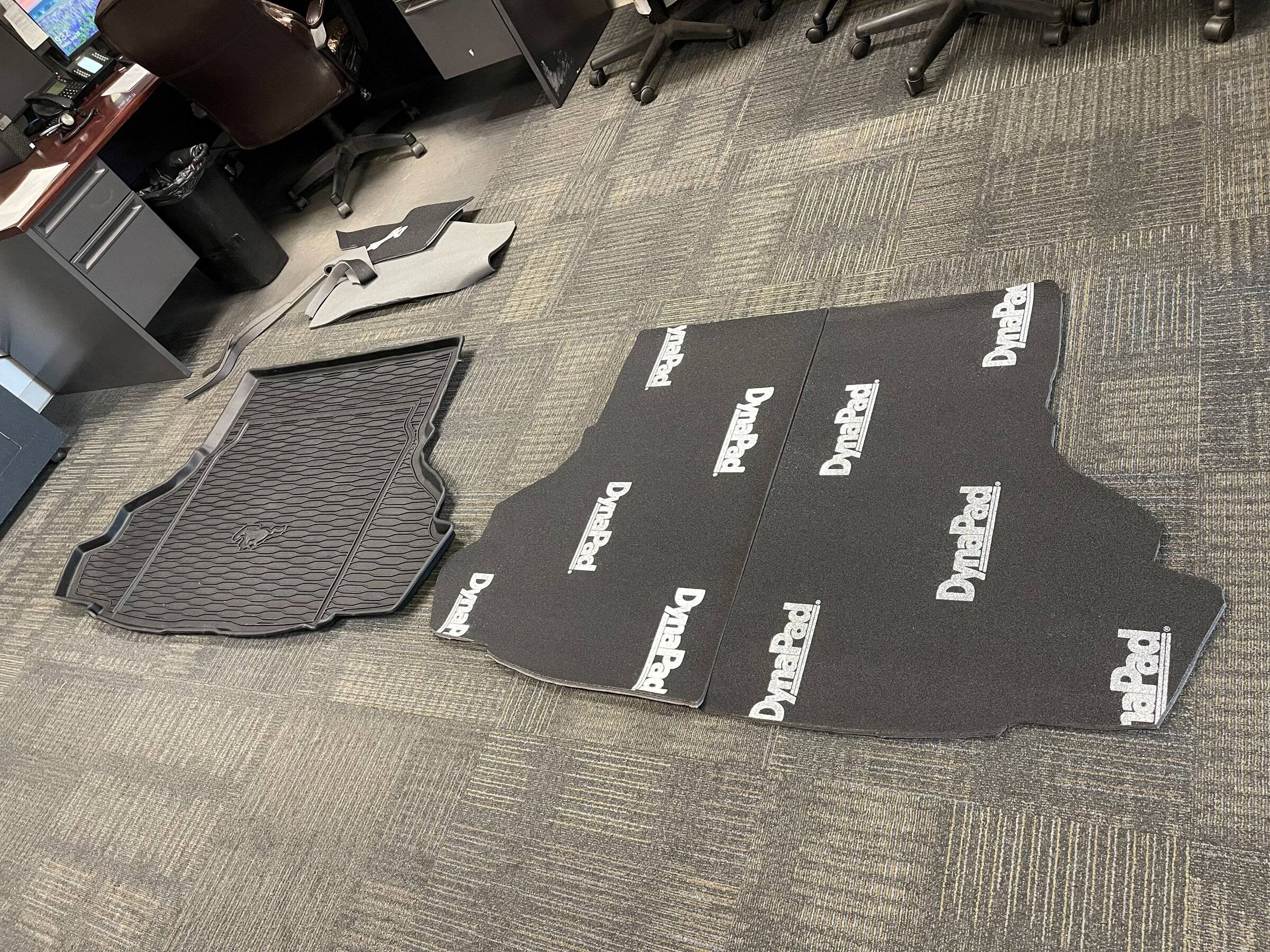

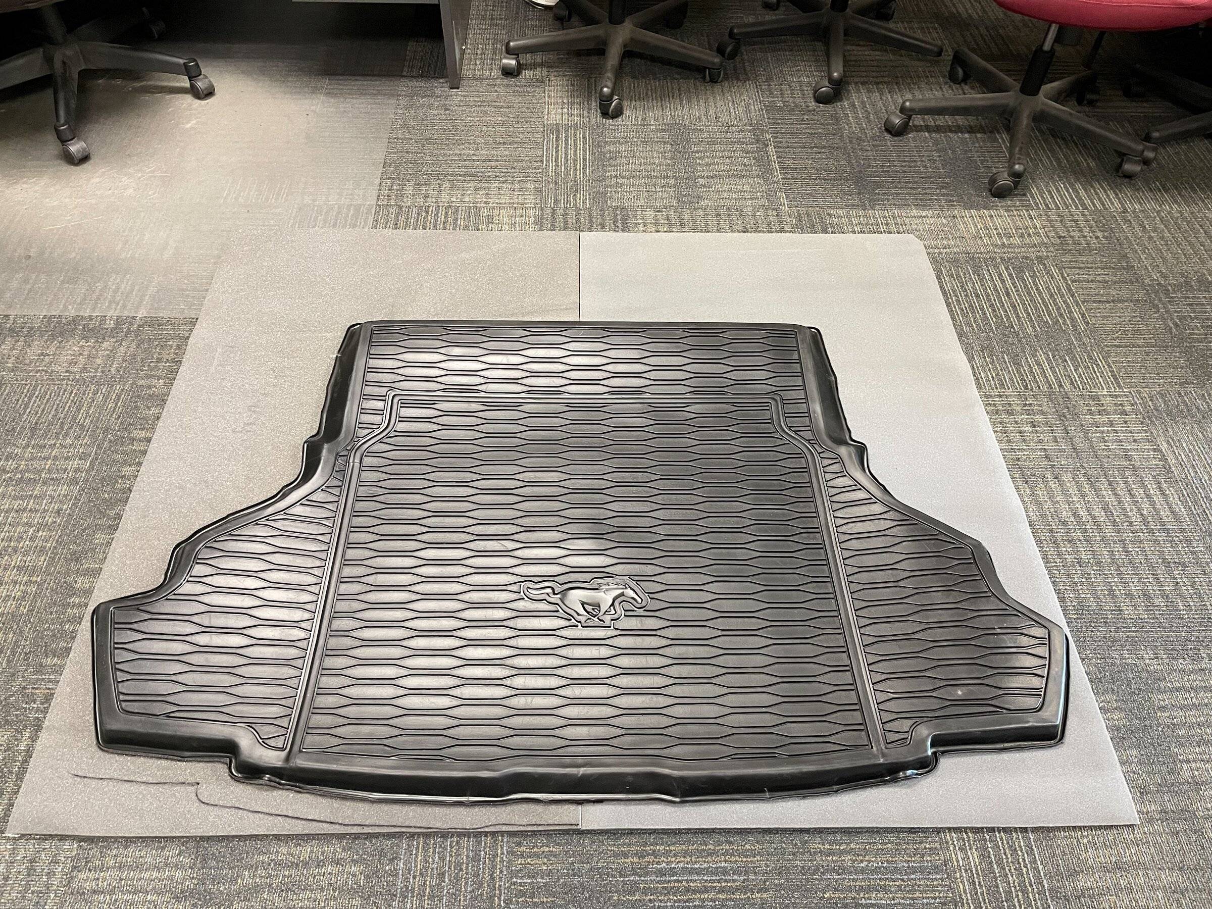

Initially, I had planned on doing exactly this, and I still might - but I had placed one sheet of Dynapad under the trunk liner, and I noticed a difference - so I bought another, trimmed them, laid them side by side, and they're just about perfect. I could take about an inch out of the middle to eliminate the overhang, but not sure if I'll mess with that any further.
This stuff is HEAVY - two layers of different
foam, a layer of vinyl sandwiched in between, and a waterproof upper layer. Easy to work with. Cut it with scissors.

This stuff is HEAVY
Probably because you're overkill and using it wrong. The heavy stuff only needs to be used sparingly and only needs to be attached directly to metal components preventing them from vibrating. It's not meant to be a continuous sound block. That should be done using MLV foam.
I did the same on my old car. Placed several small sheeds of Dynamat on the actual metal of the trunk area where it was vibrating, then cut out a pad of MLV to fit exactly in the trunk. Made a huge difference and weighed in at just a couple pounds.
