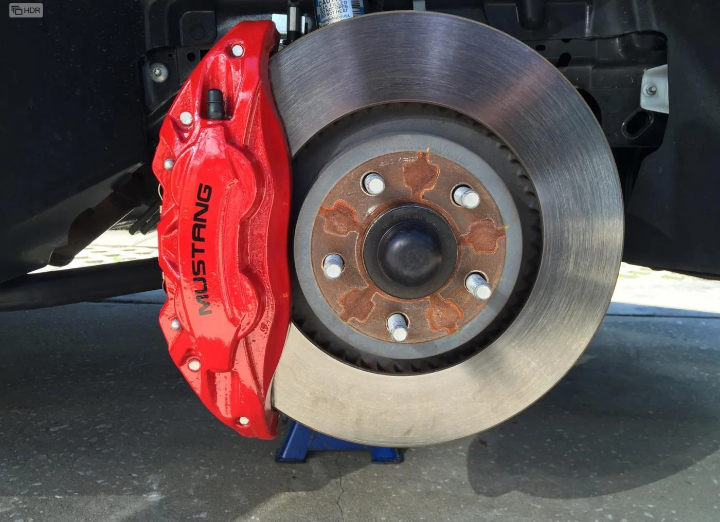

To install my Goodridge Braided Stainless lines I used the simplest method and it worked perfectly. I took a 12oz plastic soda bottle and drilled a hole in the cap. I rinsed the bottle and 1/4 filled it with brake fluid. Then I took a clear plastic hose about 2 1/2 ft long. I trimmed the hose to allow it to fit from the bleeders (car on jacks)to the bottom of the bottle while it sits on the floor. Slip the free end of the hose into the hole in the bottle top so it goes to the bottom of the bottle (in the brake fluid). Then I pumped the brake pedal till it got firm, opened the bleeder let fluid flow until the bubbles stopped, close it, pump again, bleed again. If the pedal stays firm check the fluid reservoir, top it off and move to the next wheel. Easy Peasy. And your Father In Law will be impressed I guarantee it. Start with the wheel furthest from the reservoir and work back to the closest. You will use a lot a fluid since you plan on taking the calipers completely off. But take your time and make sure the hose fits really tight on the bleeders.
As a side comment, I painted my calipers with G2 without removing them. I know you didn't ask but I suggest it anyway.

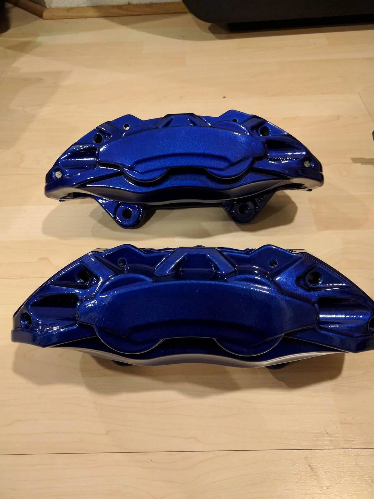

BigW25
Nov 16, 2016
Elko New Market, MN
2016 GT Premium DIB
Thanks for all the tips. The powdercoating is complete, I'll be putting them back on Saturday.
