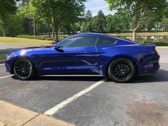

Here is my Mustang after having Steeda's Comfort Suspension installed. It is about an inch lower. This weekend I plan to drive on a road that will allow me to fully try out how it handles.
I like the way it sits a lot. I'm interested in hearing what you think!

I finally had a chance to try the handling of the comfort suspension package and it put a big grin on my face. I was handling 35 MPH corners at 60 MPH. It felt connected to the road, with no lean, and no feeling I was approaching the grip limit. I will say this is the best improvement I have added to my Mustang. When you are just cruising, it is more comfortable and when you push it, it will put a smile on your face because of how much fun you are having.
