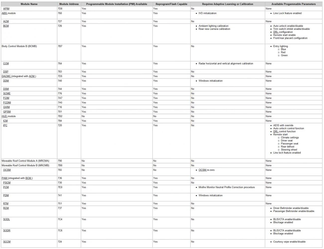

the beltminder is already available in the module config for the RCM. See attached for stuff that would be pre built-in. That beta forscan I posted on the last page not only has all dealer stuff built-in, but also has the changes in the spreadsheet.
I don't have it available, but basically you would use the non-ASBUILT module configuration. It would be available as a drop-down.
edit: clearly I didn't read the whole post. you already found them in the RCM. You shouldn't need to manually type anything in AS-BUILT for it.
Yes I already found 1 occurence for both in a module (atm I can't recall what module) and they were both disabled, but passenger beltminder is still active.
In post #684 user [MENTION=14366]dave-[/MENTION] posted some forscan screenshot where you can see beltminder status in two screens (also with different status), so I believe it is in two modules (at least for export cars) but I can't replicate those screens..
it should be that second one. that first one looks like the IPC. I gotta check mine now... Pretty sure all you need is the RCM change. DAMN IMPORTERS :)
if anything, try setting disabled in both places and see if you're good.
