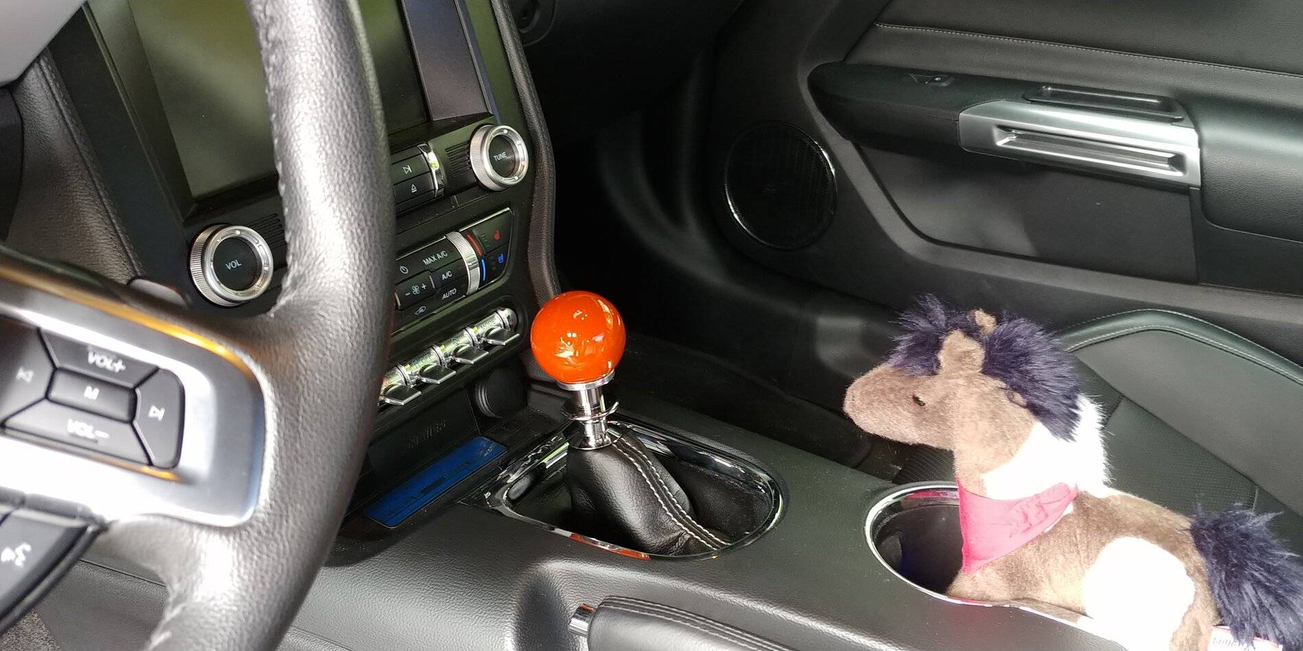

Is it possible to remove the prnds piece as well as bevel on right to make auto car appear like manual? I think it would look nicer

The bezel also comes with the leather boot, they're glued together - which is OK, as you'd need it anyway; I don't think the auto boot would fit the manual bezel. I think the biggest challenge would be to detach the current boot from the shifter and attach the new one. With the manual shifter it's easy - unscrew the knob and just slide the boot along the stick. The auto shifter may be different though.

I dont think you can do that. You need to order the whole manual boot (about $50) and then you can attach it to the auto shifter. Very easy to do. If you do a search on here you will find a bunch of people who have done it.

I just ordered a manual boot to do just that. I’ll post up pics and the install.
Figure it’s cheap theft protection.

Thanks.
Also one other thing. im wanting to do custom boot and nob after that. I have looked into doing the short auto shifter by white madness garage and then i can use any normal universal nob. should this all work

also can you get me a link to where you got it from please? i have seen several, but if you get yours and are happy with it i will go with same place

thats exactly what im looking at with red piping but going to do carbon ball

where did you get yoru manual bezel at.

Will i be able to use my automatic shift nob after i change it out for now untill i can by the short shifter conversion or another auto knob?
