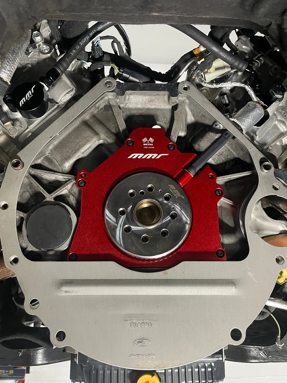

Yes it does! That is how I gained adequate access to install mine. Pro tip: Have lots of towels ready on the floor because there will be lots of coolant spilled. You can see how much access removing the tranny provides in these pics.
